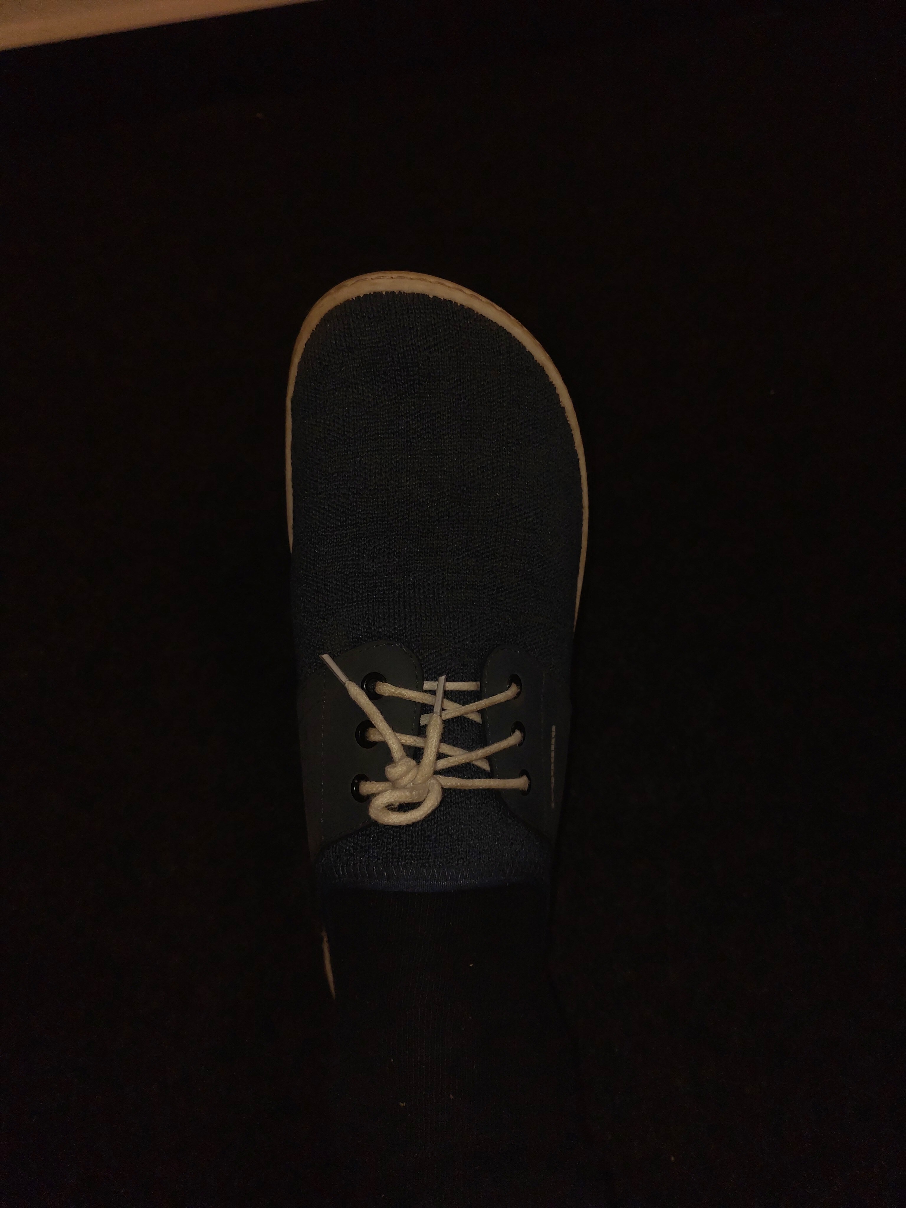

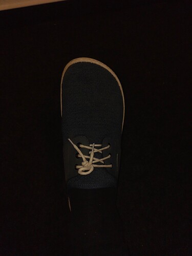

I have a problem with the camera on my FP5: I manually adjusted the exposure of a picture one time. Now I always get an extremely dark picture when i open the app, just like in other apps like Fotokopierer or barcode readers. The only thing that can be seen are lights or so.
Neither a manual change of exposure nor a reboot fixes this. Furthermore, even the front camera is dark.

I can confirm this. Just after SailfishOS installation my pictures were absolut awesome (comparing to Xperia 10 III), now they got much darker and not so crisp.
Another bug i found so far: Sometimes when the battery is low and i connect the charger the FP5 doesn’t charge. It shows the charging symbol, but the battery percentage doesn’t increase. I need to reboot the FP5 to charge.
In my case it isn’t just a little but darker or not so crisp. The photo is of my foot in a well illuminated office with flash. Without flash, nothing would be on the photo :frowning:
wow, for me its not so extreme, but the quality is much better than yours, but much worse, than it was before…
I’ll have to investigate the camera issue.

I tried to reproduce the exposure issue but only managed to make it temporarily broken, it gets back to normal after moving manual exposure from minimum to maximum a couple of times. For me triggering the issue happens if changing picture/video mode or camera when exposure value is low.
