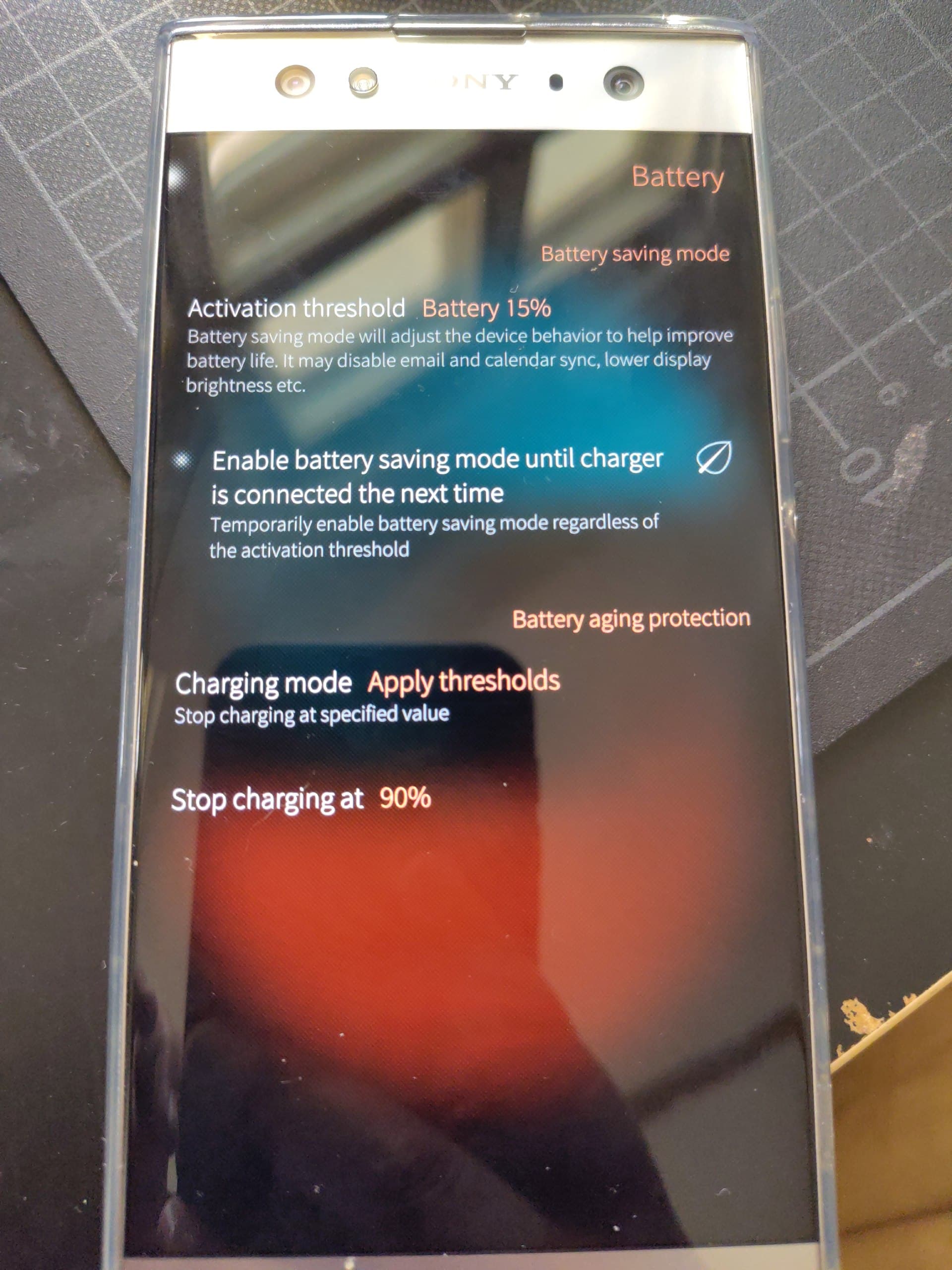

@mal Is it possible to add charging mode thresholds to the FP5 Port?
i use this function a lot and its really prolongs battery life.
The configuration for charging control is already on the device but it seems there is some possible race condition or something during boot and the charging control is not working always. It can be made to work by running “systemctl restart mce” as root. I will try to figure out how to fix the issue.
Thanks for the answer @mal and thanks for working on this.
btw.: Could you please update FP4 and FP5 Repos to the new minor update 5.0.0.68 ? Thanks
Charging control should now work on FP5 in 5.0 releases. When updating to 5.0.0.68 first update again from repos of 5.0.0.67 or any other older 5.0 release and then update to 5.0.0.68. There are some changes to repos which would otherwise cause a bit of an issue during update (because one compatibility symlink is missing from build system).
very cool. dozen of new packages, new kernel image, charging control works now. You made my day again, @mal !
