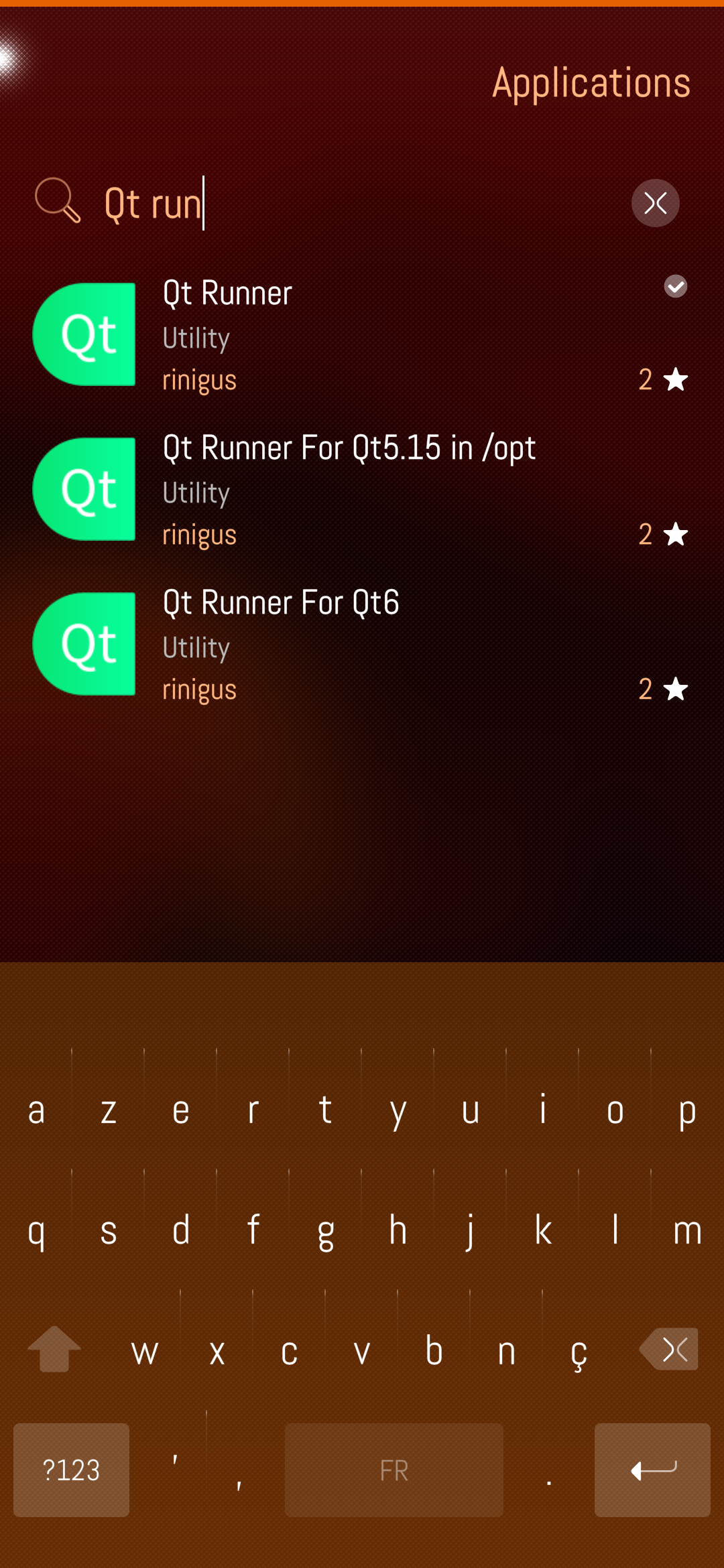

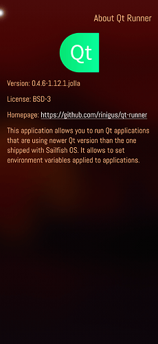

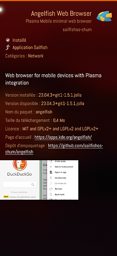

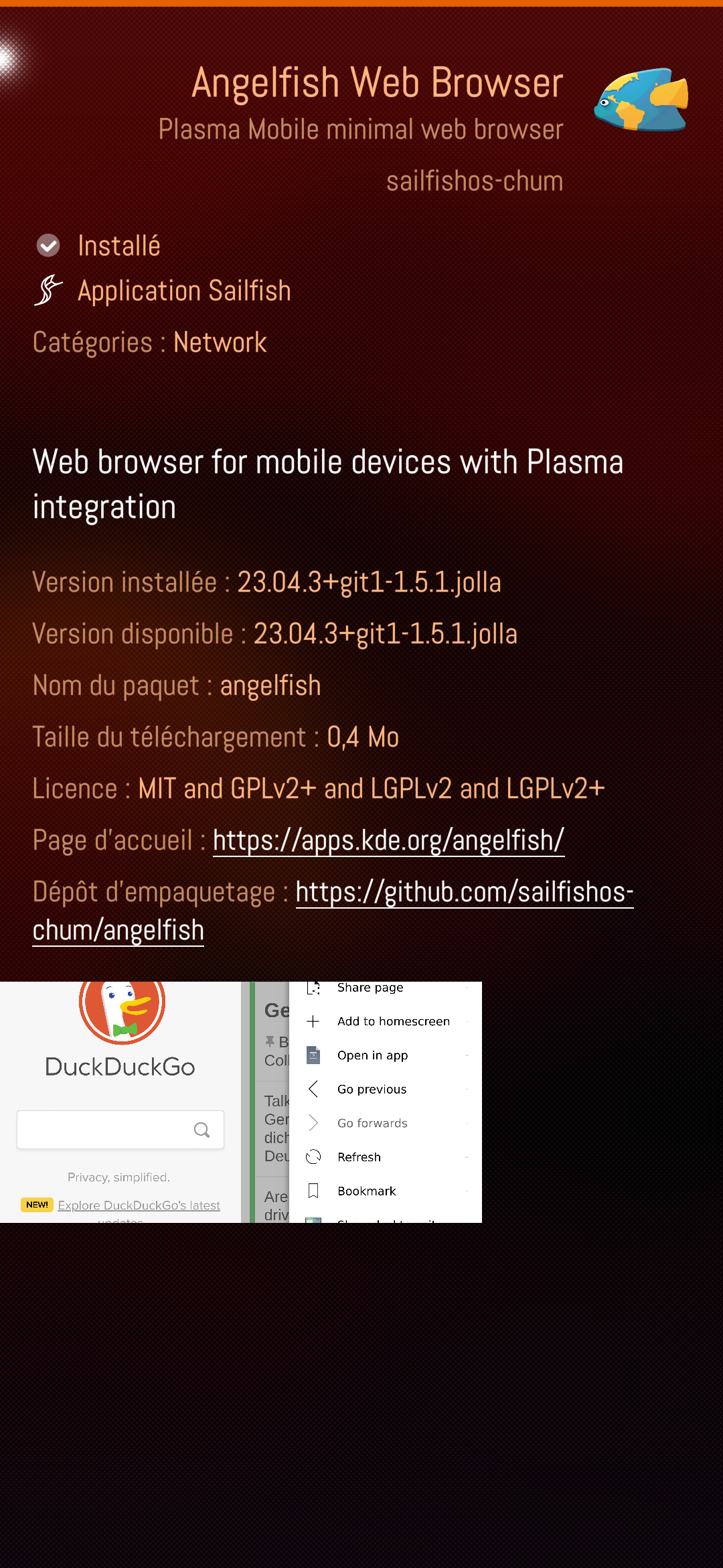

You should try Angelfish web browser

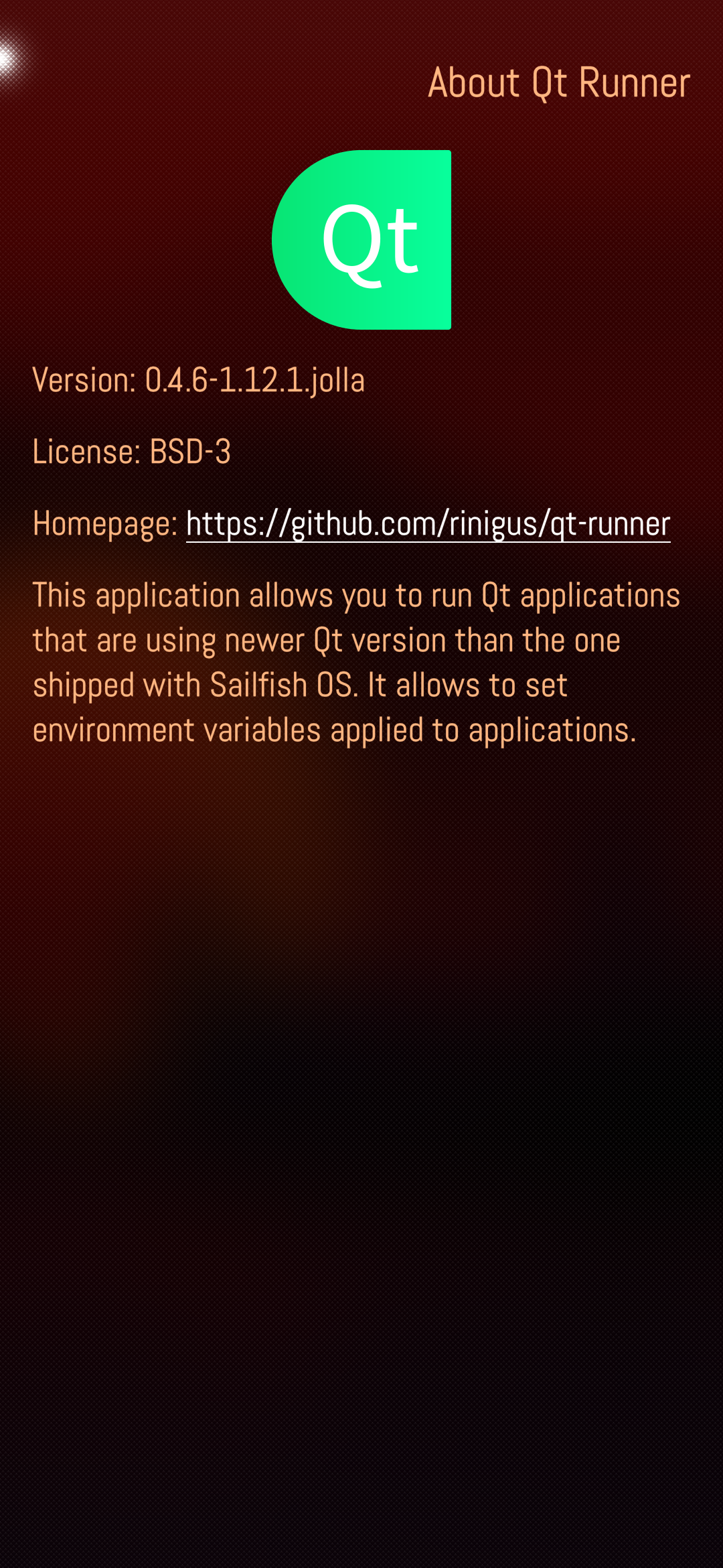

I installed angelfish web browser and it works fine for me. Can I change Qt Runer 5 or Qt 6, knowing that the installation of Qt 6 did not succeed? What is the difference between them and what can you advise me on?
The version in Chum is outdated, there are instructions for the Qt6 version here: How is Angelfish currently? - #2 by dopi04

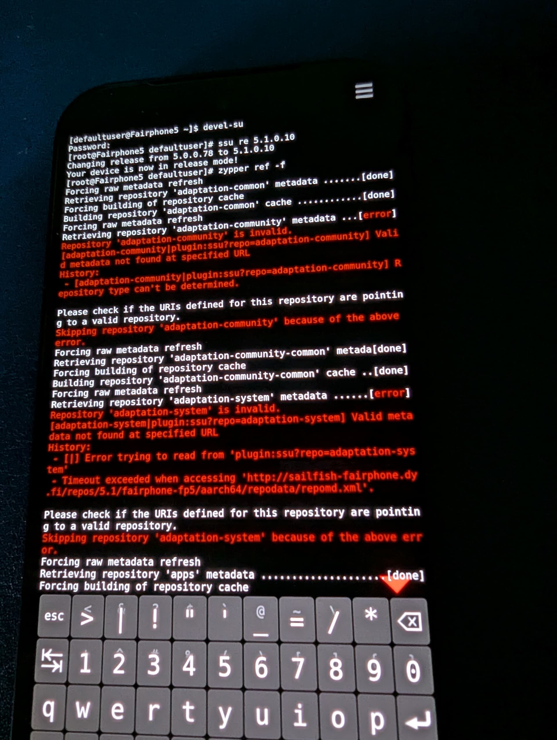

So I installed 5.0.0.78 then tried to update to 5.1.0.10 on my FP5 and got these errors. So I reverted it back to 5.0.0.78 and didn’t proceed.
Did you update the device after flashing? Please try to update to 5.0.0.77 as instructed in the first post of this thread
The Sailfish OS 5.1 is happening quite soon (in early access testing now) and I have already done initial testing of it on my FP4 and FP5 devices and so far it has worked quite well. It needed some changes so directly updating at the moment is not recommended. I will release it once official Sailfish OS 5.1 release is done.

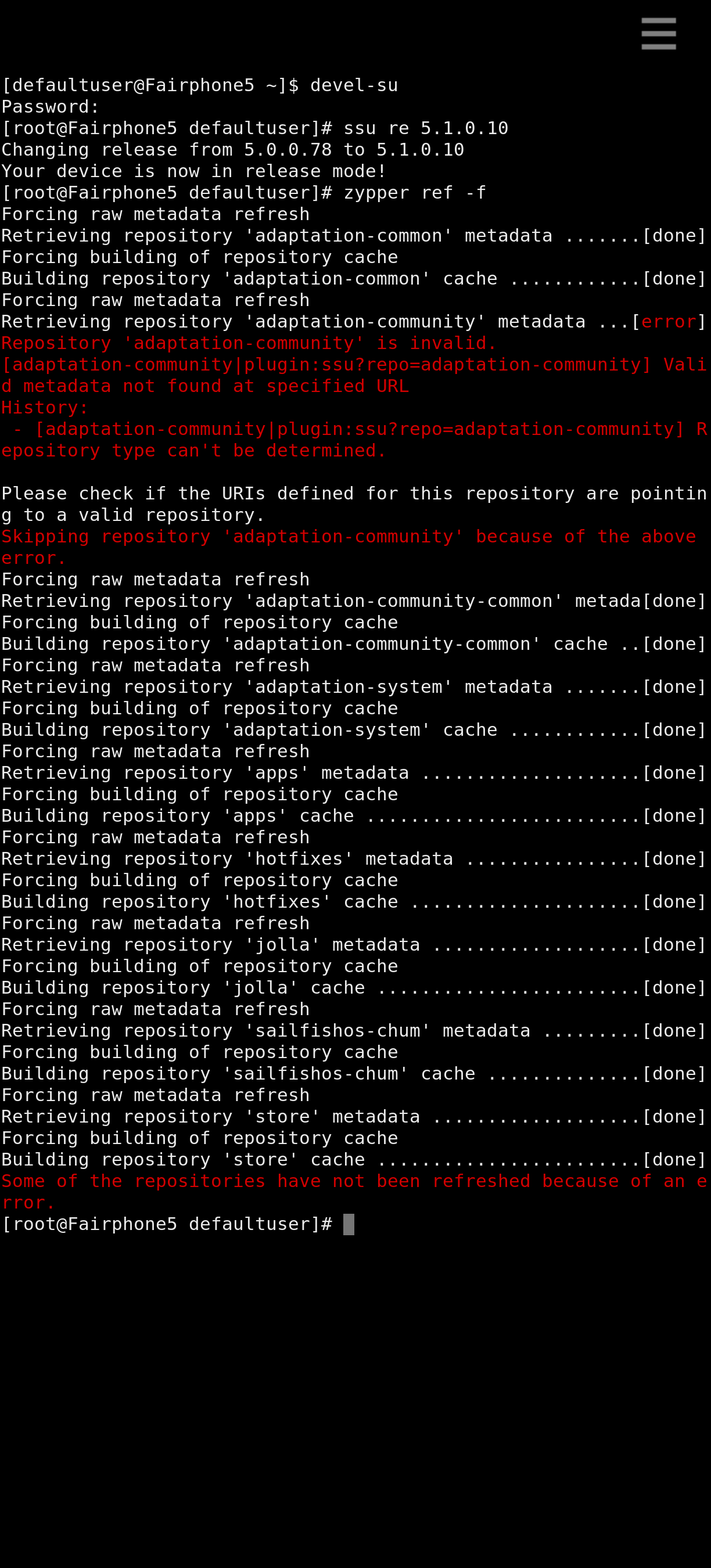

So I tried to update on Fairphone 5 from 5.0.0.78 > 5.1.0.10 again as I tried on 11 June 2026 and this time there were fewer errors as attached screenshot shows.
I undertook following update via the terminal as
devel-su
ssu re 5.1.0.10
zypper ref -f
errors encounted on Retrieving repository ‘adaptation-community’
ssu re 5.0.0.78
zypper ref -f
zypper dup
exit terminal
reboot
Since there were errors again but less errors>
Repository ‘adaptation-community’ is invalid
Issues resolved since last update check>
adaptation-system
I also tried refreshing to the latest version 5.0.1.11 but same results so revered back again
I haven’t yet built the 5.1 changes in the normal OBS project. I’m doing some final testing before pushing the changes there, so far looking good.
