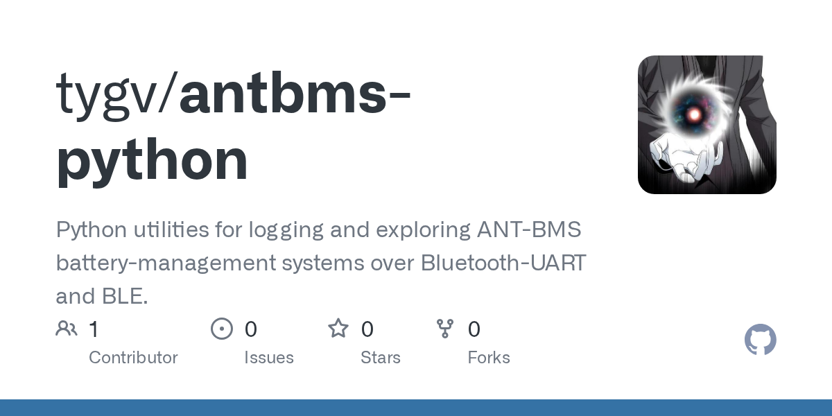

there seems to be a python thingi
only 5 months old

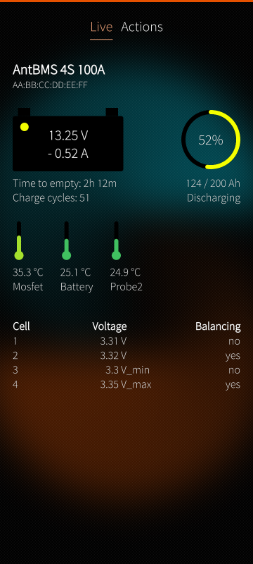

Ok, so development is mostly complete and GUI is pretty much ready. Is the original author of this thread @rw007 still interested? Or maybe volunteers here who can help testing on real hardware?
Below a screenshot with dummy data.
Small update, SailBMS now has initial support for the following BMS protocols over Bluetooth BLE:
  • AntBMS (as requested)
  • JBD / Xiaoxiang / Overkill (Ant‑style)
  • JBD / Xiaoxiang (UART‑style)
  • Daly Classic
  • Daly Smart BLE
  • JK BMS
  • Victron (any VE.Direct BLE device - like SmartShunt, BMV‑712, SmartSolar MPPT, Orion Smart)
Unfortunately, nobody has responded so far for testing.
