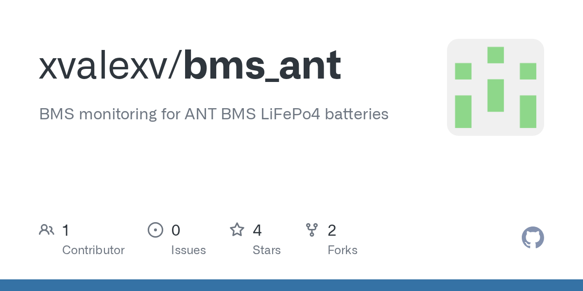

step1, the reverse engineering some closed device protocol to FOSS land, is normally the hard part, but it seems like it might be done already, based on a quick google search that turned up a few repos like this:
you should see if you can get that working for your specific device.

From the python code linked it would appear it’s regular BT with rfcomm, and then mqtt over serial(?).

The @teleshoes linked repo is strictly monitoring. Could you elaborate what ‘control functions’ you’re looking for?
