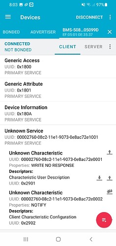

Hi,
unfortunately LiTech does not publish info on their protocols to access BMS over BLE, so it is not implemented yet. With a little help we MIGHT still be able to get some data. Would you be able to download an app called “nRF Connect for Mobile” e.g. on an Android phone, run a Bluetooth scan and click CONNECT where your BMS shows up. Then a list like this should appear:

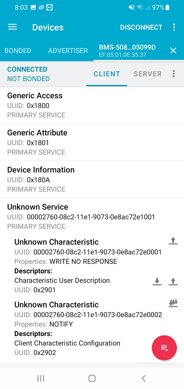

Generic Access 00001800-0000-1000-8000-00805f9b34fb
Generic Attribute 00001801-0000-1000-8000-00805f9b34fb
Unknown Service xxxxxxxx-xxxx-xxxx-xxxx-xxxxxxxxxxxx
Unknown Characteristic
Properties: READ, WRITE
Properties: NOTIFY
Could you send me a screenshot on email? The Unknown Service and its characteristics are the important ones. If we get an UUID here, we might also be able to squeeze some data out next. No promises… BMS protocols are a jungle.

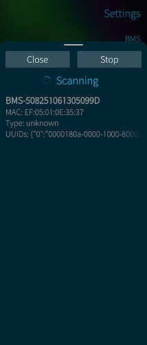

Added a Button in Settings which produces a log file including Bluetooth BLE and GATT info of all devices nearby … if you prefer not to download an Android app mentioned earlier. This hopefully shows us UUIDs and available services LiTech uses. Maybe send me an email if you like to try?

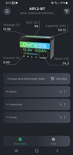

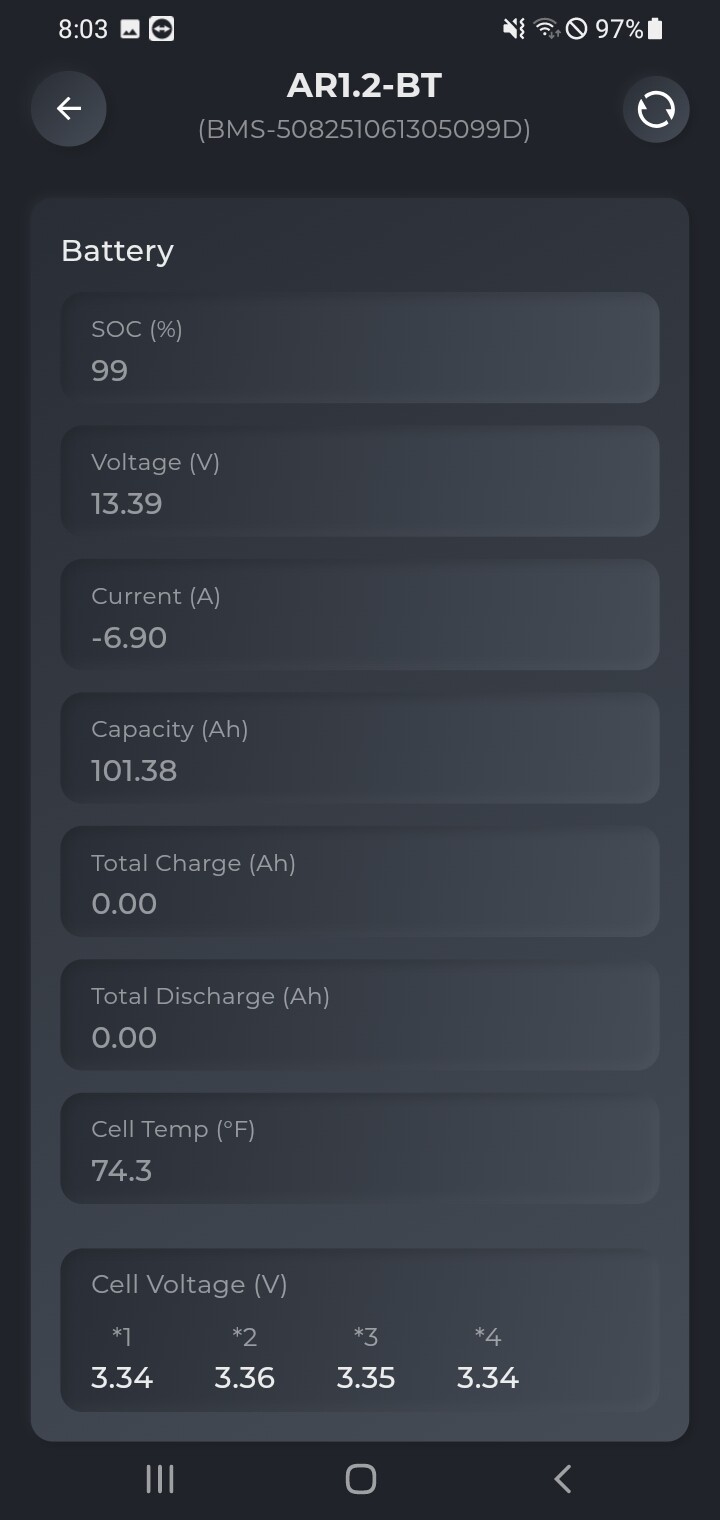

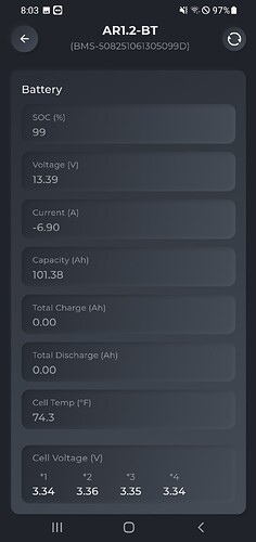

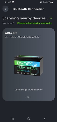

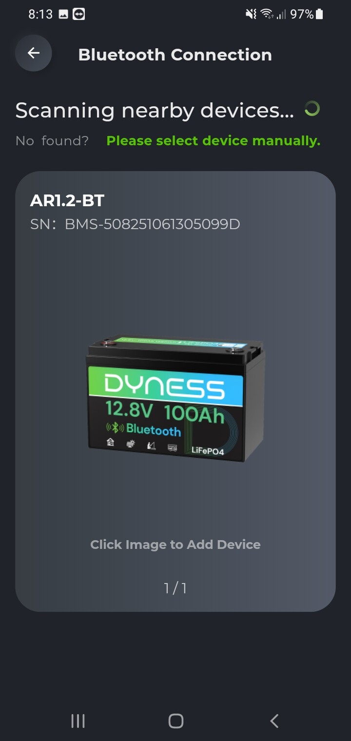

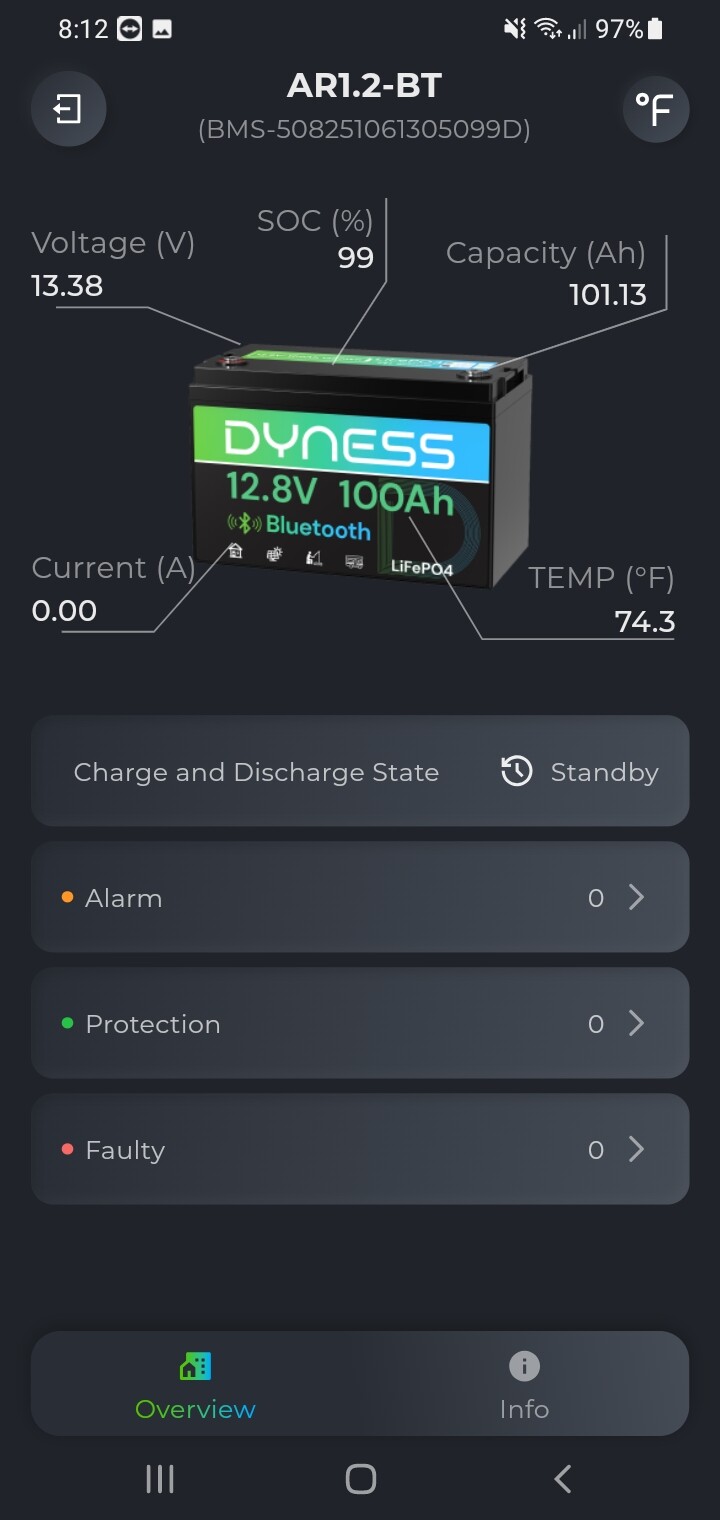

Android App used to connect: Dyness
https://play.google.com/store/apps/details?id=com.dyness.emssmart&hl=en
Bluetooth BMS Type: Nations Technologies Bluetooth BMS stack *
  • According to the manual, this battery is supposed to have a Xiaoxiang JBD stack, but there must have been some kind of mix-up at the factory in China, or perhaps they changed chipsets in newer generations and didn’t udate the manual. I’m not sure, but it definitely isn’t JBD. None of the Xiaoxiang/JBD apps can see it across multiple devices and android versions. After troubleshooting with nRF Connect, I came to realize it was actually a Nations Technologies stack, and downloaded the Dyness app which is made for that type. Dyness instantly connected and provides accurate info. But wow it would be lovely to use SailBMS instead!

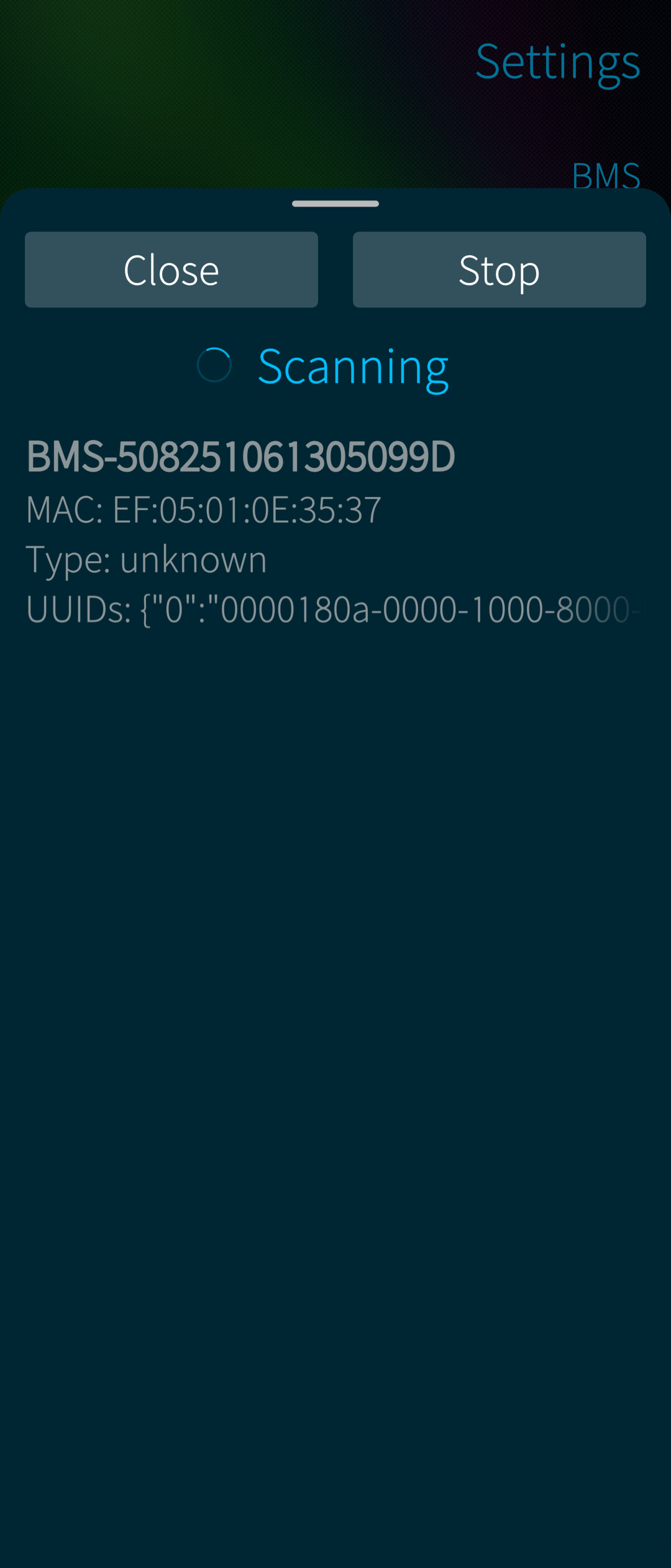

Please find attached a screenshot from nRF Connect with all detected details, a screenshot from SailBMS showing it detects while scanning (though you can’t advance beyond that), some screenshots from the Dyness app with battery details and overview, and finally the output of sailbms-probe.txt from your app. If you need any other data or would like me to run any tests at all, please just let me know. I’m happy to do so.
Thanks again for developing this.
Kind Regards,
-PK
