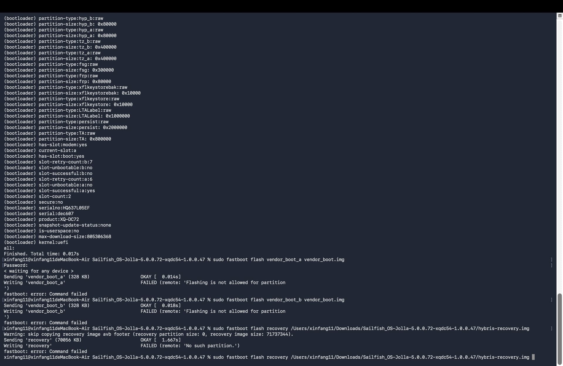

Flash vendor_boot_a vendor_boot . img
Flash vendor_boot_b vendor_boot . img, these two commands failed, prompting that it is not allowed to touch the partition. What is the reason?
