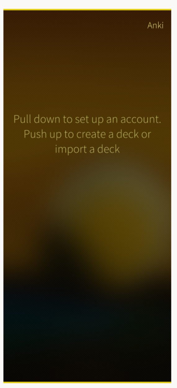

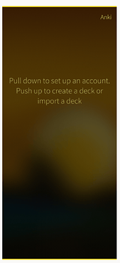

A picture is worth a thousand words, here are some news:
Once a user install harbour-anki and open it:

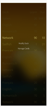

Once a deck is present:
wow very cool. thanks
Now, I need to figure out how to set a context menu inside a SilicaGridView! Stay tuned!
I’m not totally satisfied, but it’s better than nothing.
Let’s keep so and go ahead :wink:
