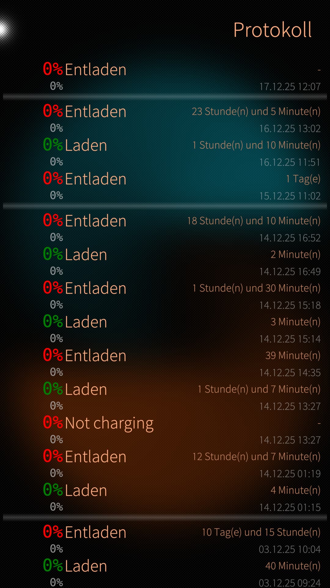

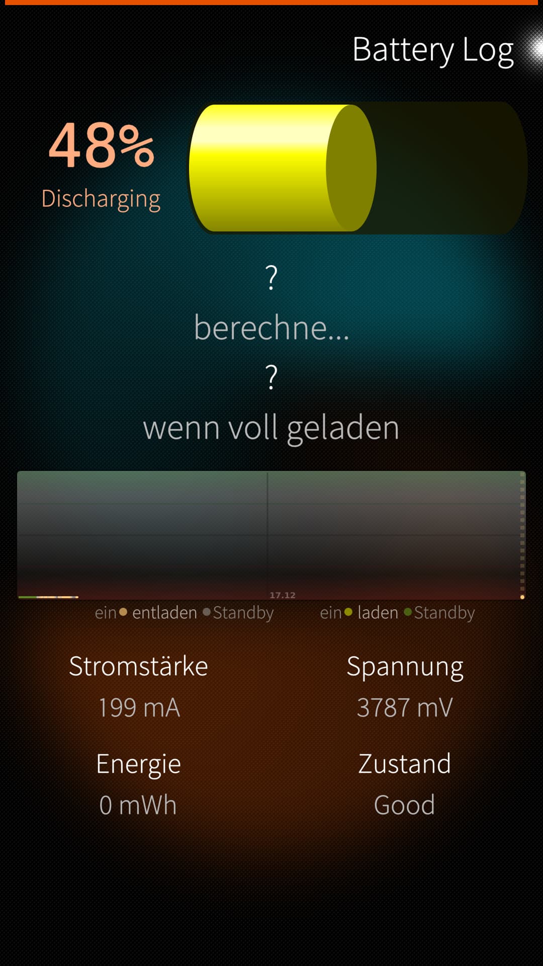

Hi there,
the Battery Apps Battery log and Hunger meter don’t show the energy level in mWh.
I don’t mean the current charge status, this is correct.
It applies to my phones Xperia X (4) and Xperia XA2 (5.0.0.72).
With the old Jolla Phone it works.
The level for current power and voltage is shown.
Is that a known problem?
Best regards Alex
Can you share some screenshots? So we’re sure to speak about the same thing :smiley:
Yes of course…

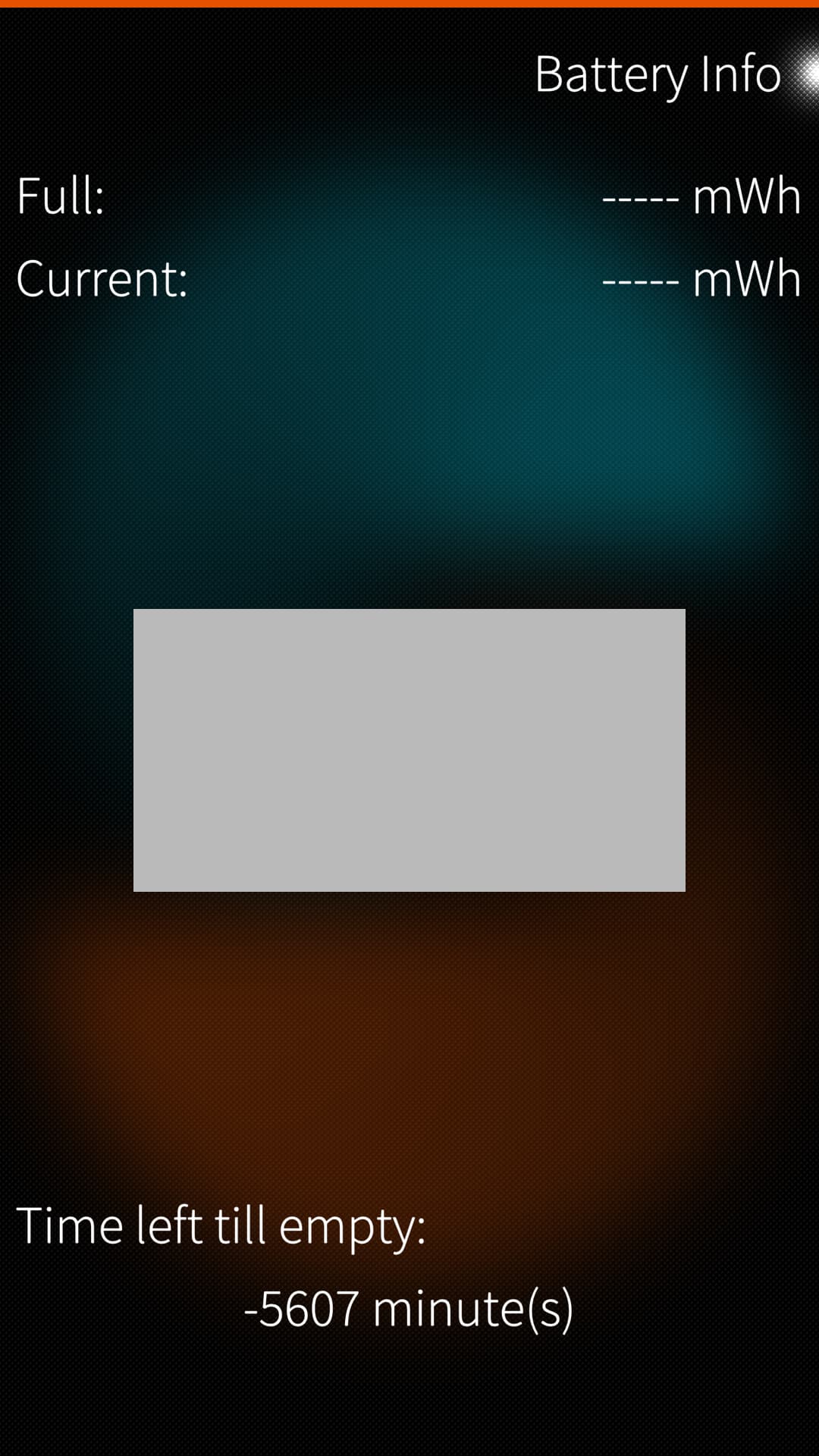

the first two are from “Battery Log” the third one is from “hunger meter”.
Yes. Both of these apps stem from the Jolla1 days, and have been unmaintained for a long while.

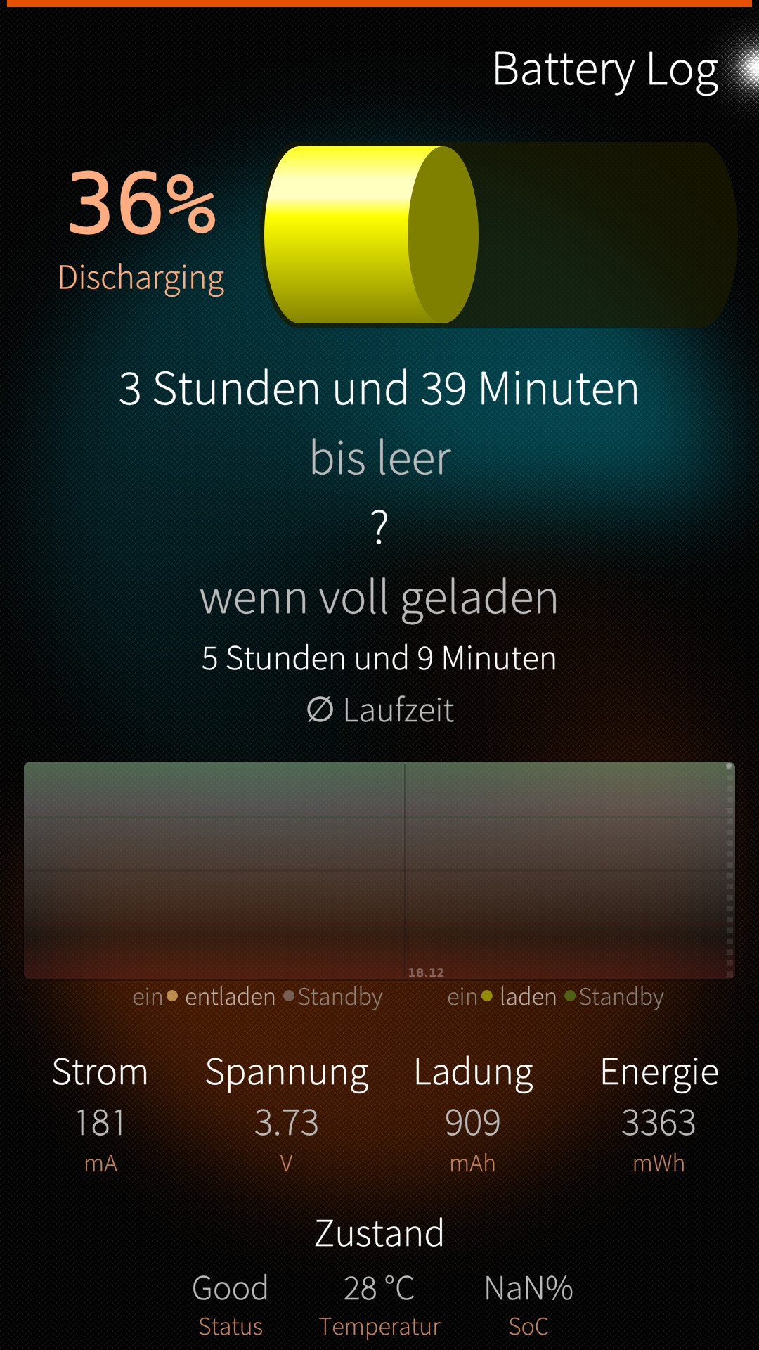

@nephros, Battery log shows energy detail, thank you!
But AIDA64 doesn’t show the Energy in mWh only capacity …so Battery log is just fine for me
It seems Battery log needs adaption for Jolla C2, it doesn’t show Energy-Consumption in mWh.
