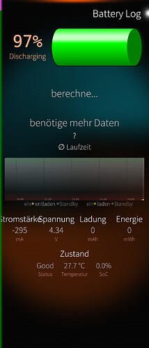

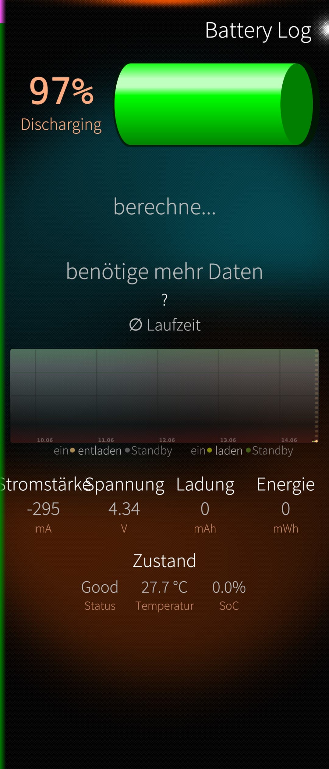

Hello - could anybody help me. I have now a Xperia 10II with 5.0.0.67. Since a hard reset (ong press Power+Vol+ = 3x vibation) the app batterylog shows only the % and not the resttime and mWh. What can I do? I restarted soft 3 times but its not work. I have the last version from Batterylog and it works before?
Its changed also the battery color if I charge the phone. And it’s show mA and mV.
