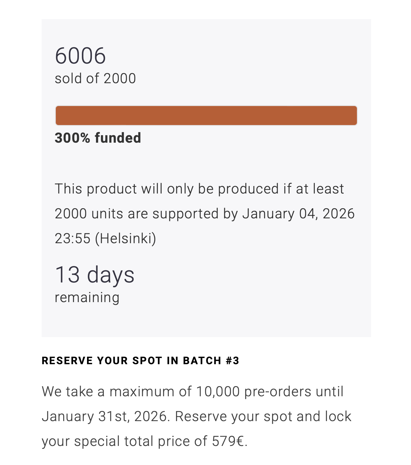

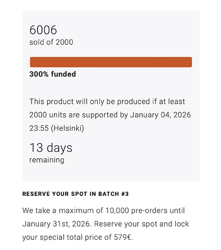

Time for a monthly update after Next gen Jolla Phone update - 11/25. As noted here and there, the start of the new Jolla Phone project has been amazing and we have just this morning passed 6,000 pre-orders!
A bit of Call-to-Action for us all here. While the 6k mark is an outstanding achievement by now, we have set the next target to 10,000 units by end of January, 2026 and to unlock the new TOH.
