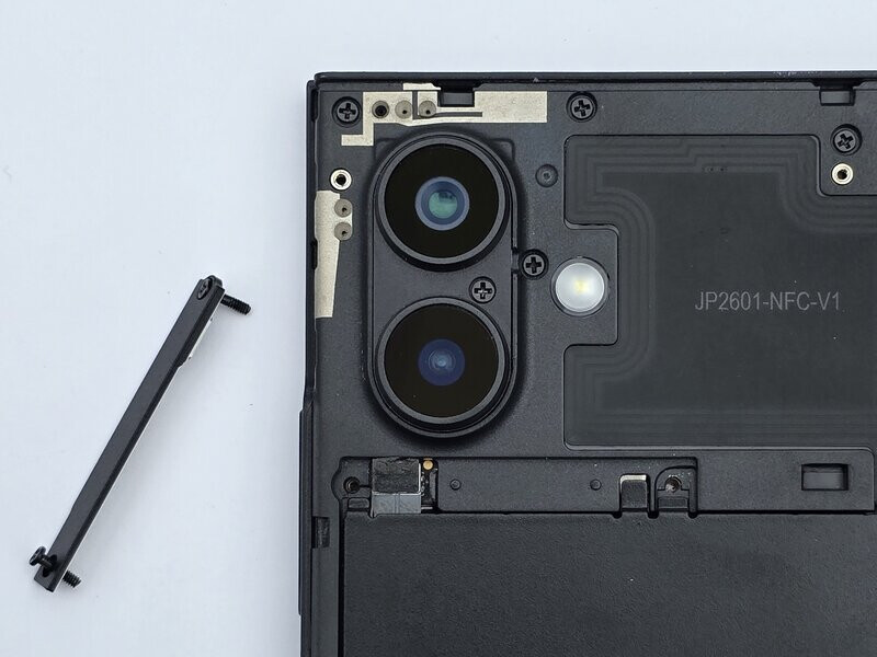

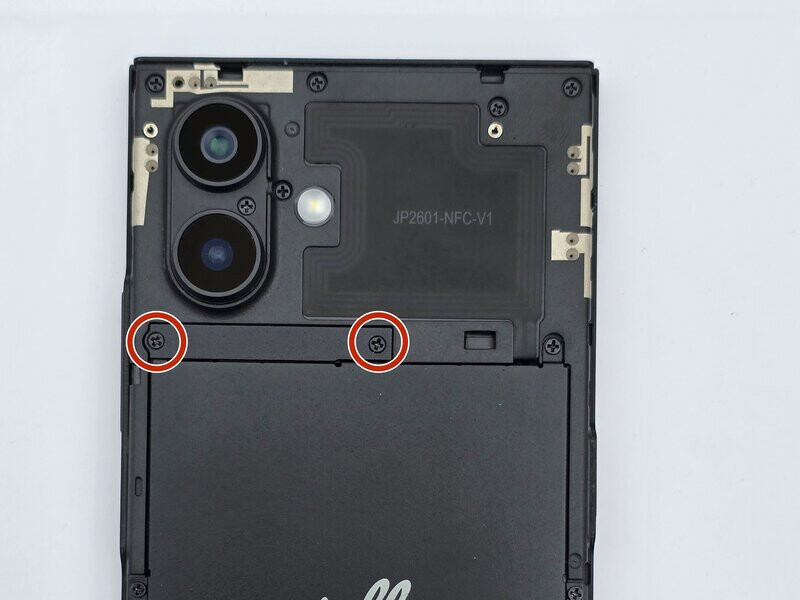

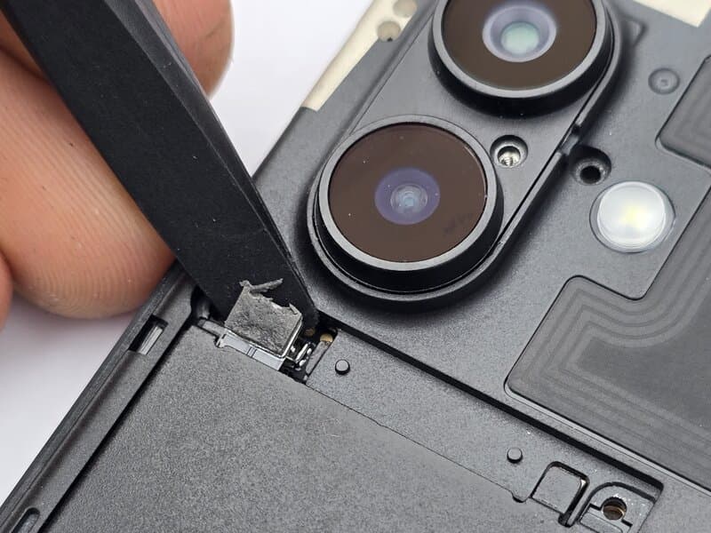

I’m very glad that I bumped in to this bug report. The battery symptoms you describe are near identical to mine (but with an added USB charging crash ). By removing the battery I can sometimes get the device to indicate 56% of charge and the operation is very inconsistent. Sometimes the battery runs completely empty with out any notification.

I have taken out battery for 30 minutes.
