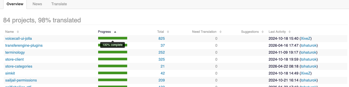

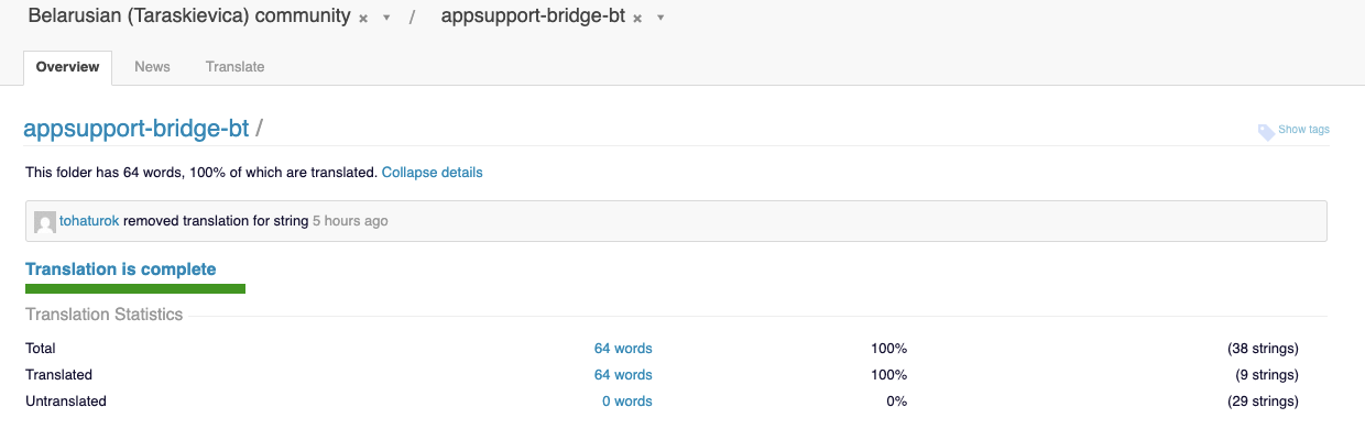

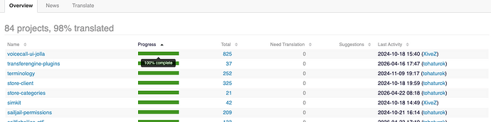

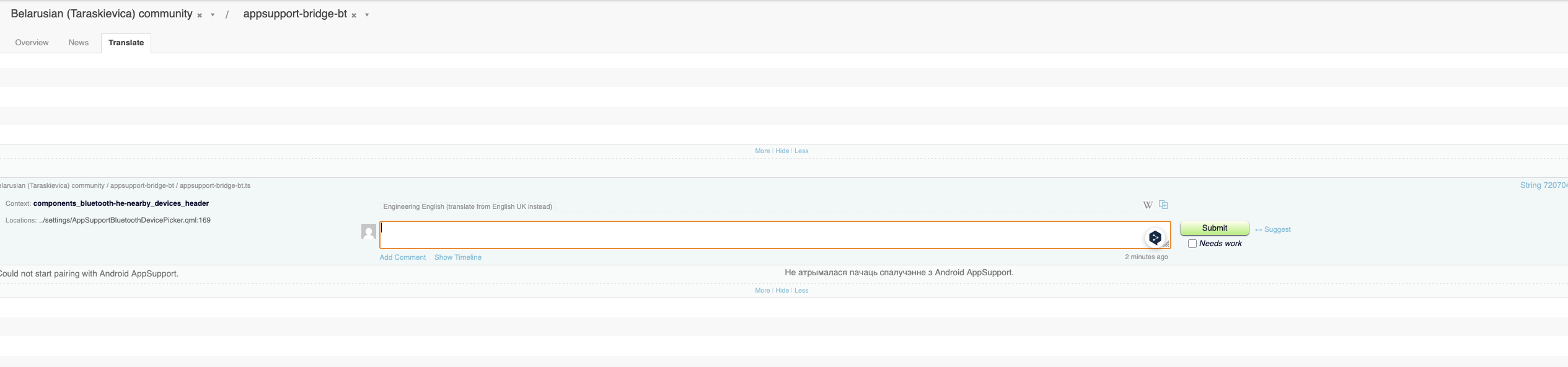

Thanks, I’ve completed translation all projects, but still see the 98% of completion. I’ve found the some projects has empty string to translate. As you can see in screenshot the appsupport-bridge-bt project has 29 empty strings (0 words). I think this is an issue why I don’t have 100% of completion in Belarusian language.
Also I’ve found empty strings in other projects: sailfish-components-contacts-qt5, sailfishsilica-qt5, jolla-clock, appsupport-bridge-bt
Should I leave these strings as empty? or there is some error in project’s translation files?

While waiting for an official answer, here’s what I did – I checked other languages that reached 100% (for ie. Spanish) where I saw that empty strings were just confirmed and saved – I did the same :slight_smile:
Although there’s difference – we have only appsupport-bridge-bt with empty strings, other files are OK.
If the source string is empty and there is no comment explaining what should be done with it, then it should be left empty. That is, just submit an empty string. This is the case for example for the label strings in appsupport-bridge-bt. The AppSupport bluetooth settings are merged in main bluetooth settings page, and use some of the same labels. (Probably we should look if there is some better solution to organize the code so that these empty strings could be avoided. Or at least add a comment to them that they should be left empty)

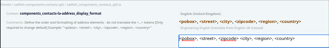

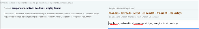

Then there are strings that are only used to change the format of some things, like for example address display format in the contacts components. Here is an example from Finnish, where we usually put the zip code before the city.
All these should have a comment describing what they do, and can usually be left empty if the default works for your language.

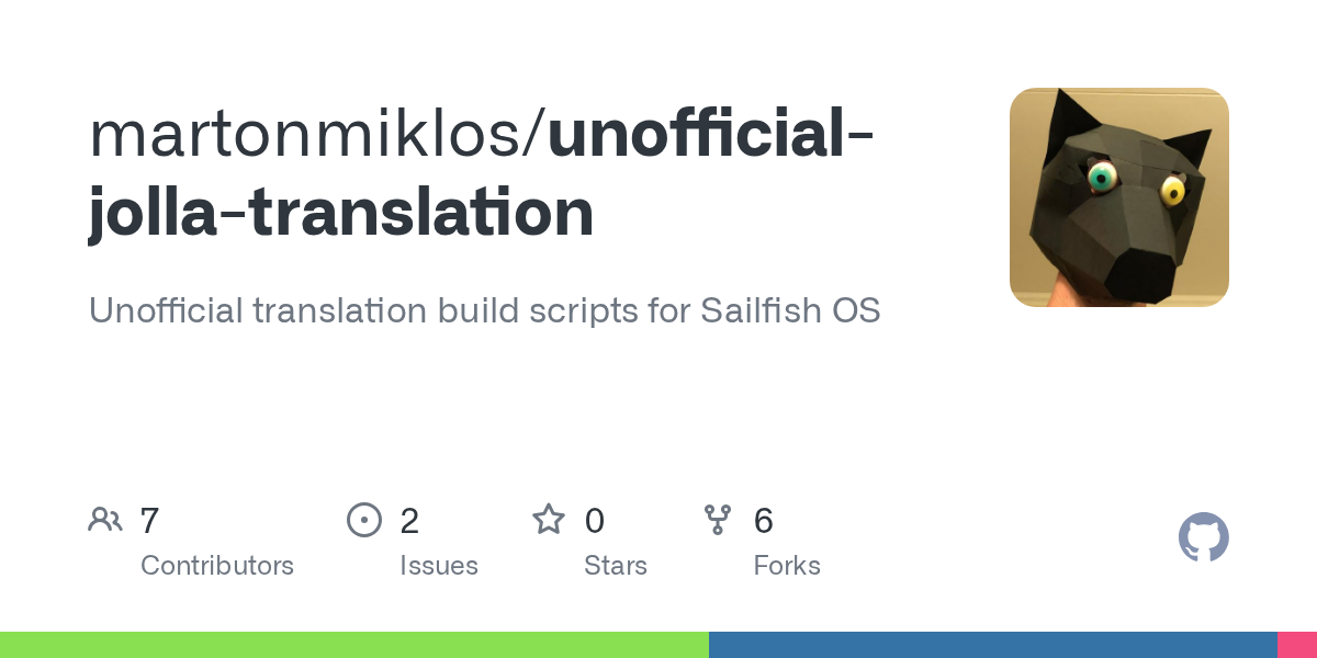

@marcaugust Important to note is that ‘community translations’ are not included in Sailfish by default - Jolla provides the translation infrastructure, but you (or at least someone) has to build a package for it, even if it’s 100% translated. Looking at OpenRepos, it seems like the last time anyone built a package was quite a few years ago:
But as @filip.k said, it could make sense to include Catalan (and Belarusian) by default if it’s going to be kept up-to-date with every release. Not to mention there’s all of the Indian languages that are included by default but haven’t actually been updated in a decade.
Unfortunately, I’m not a programmer and I don’t have the slightest idea how to do this. If there’s a step-by-step guide and it’s simple, I can try (it’s never too late to learn things!) but I don’t even know where to start.
There’s a guide on how to do it in the link below, but maybe @martonmiklos could create the RPM for you.
Of course, if Catalan is added to the list of officially supported languages, you don’t need to create any RPM files yourself. Hopefully @Keto can add it into the 5.1 release.

Thanks for clarification. I’ve submitted an empty string for these translation, but I don’t understand why Belarusian language has 98% of translated, when I’ve translated everything. Is there mistake in calculating the percentage of translation?

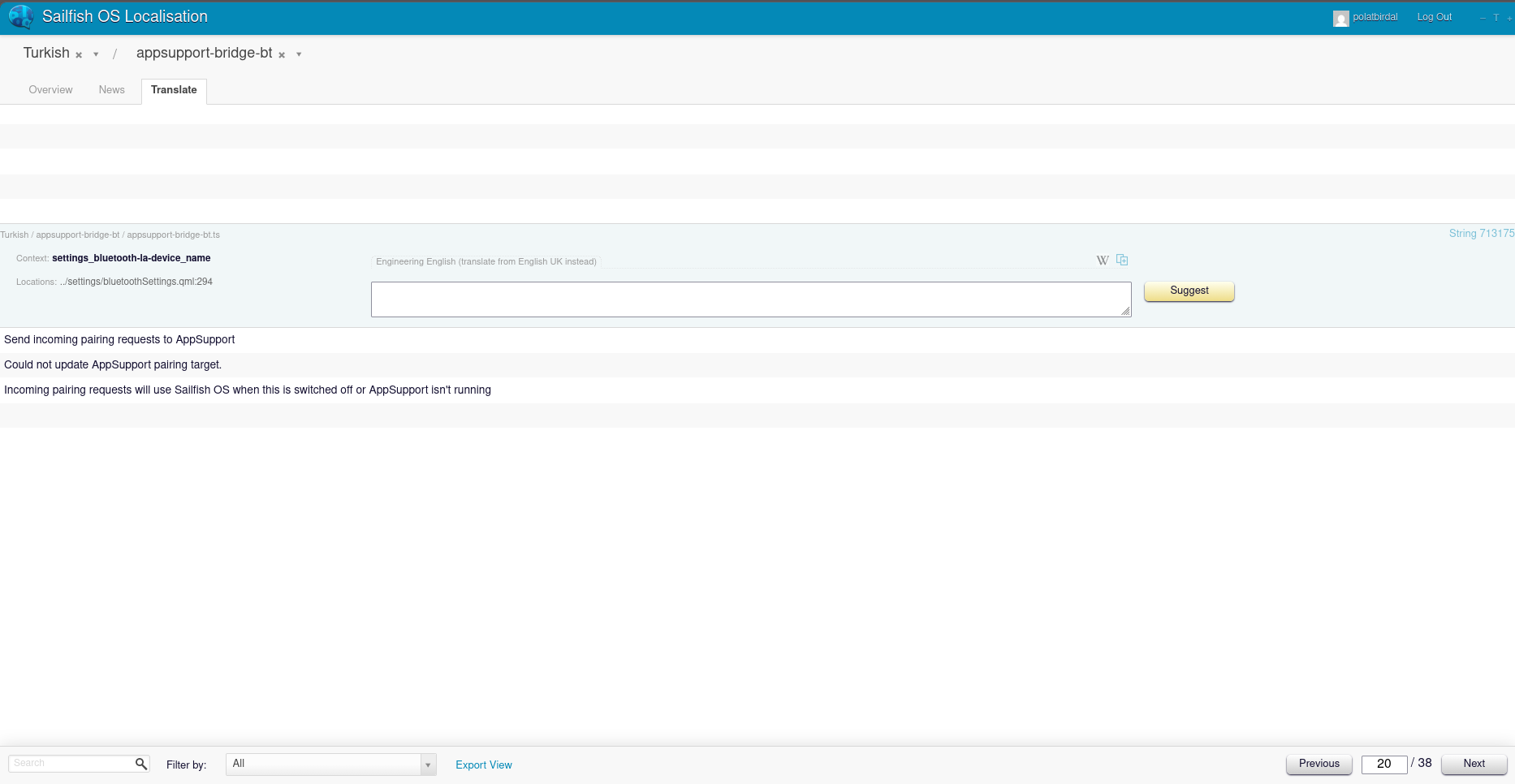

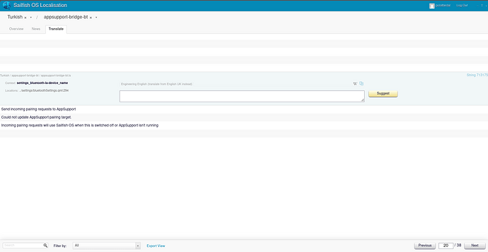

Hello, I took on this task to complete the missing parts of the Turkish translation. Sorry for being a bit late.
What would you like me to do with this part? As far as I read in the thread, we should leave places like this empty. Is that correct?
yes, you read correctly.
