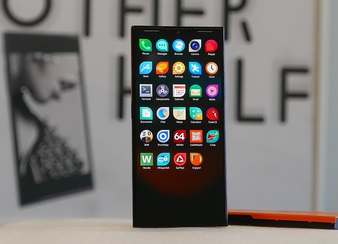

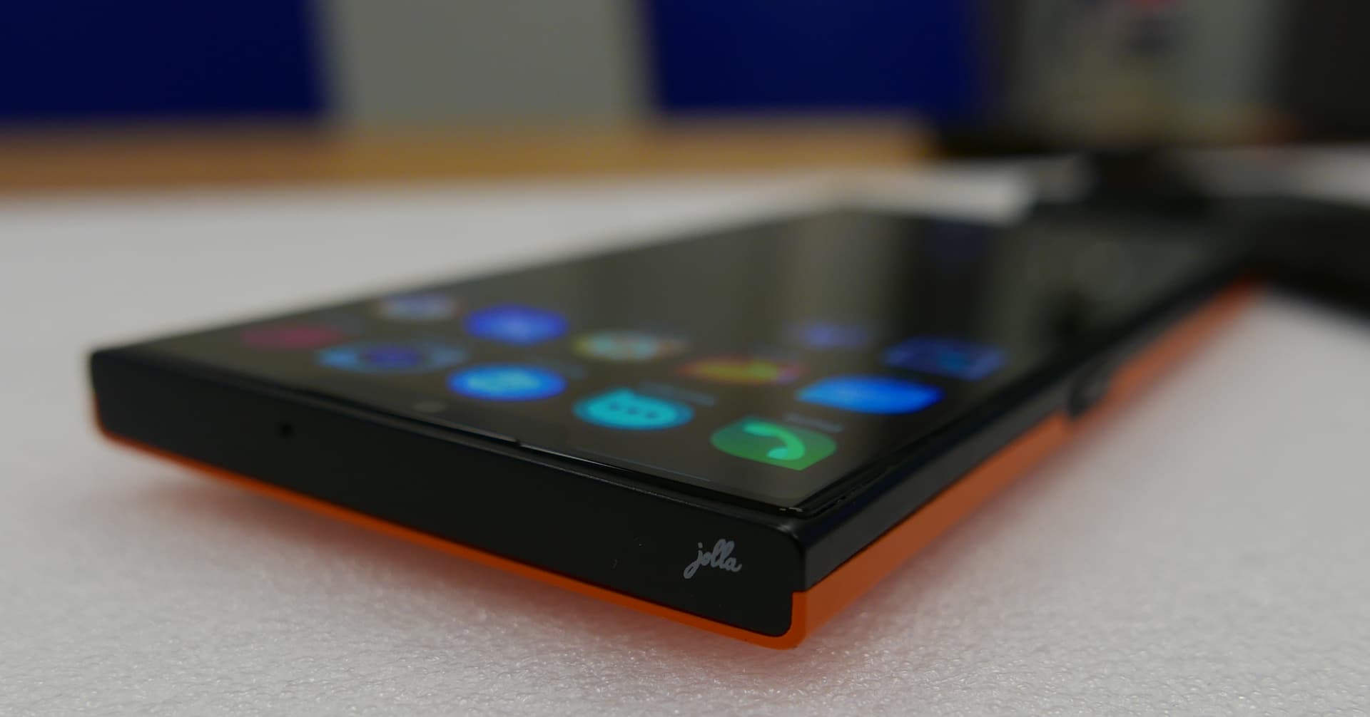

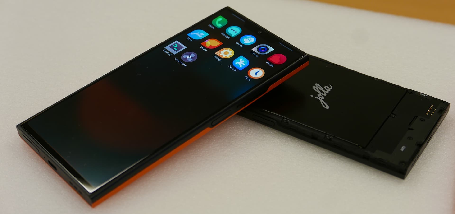

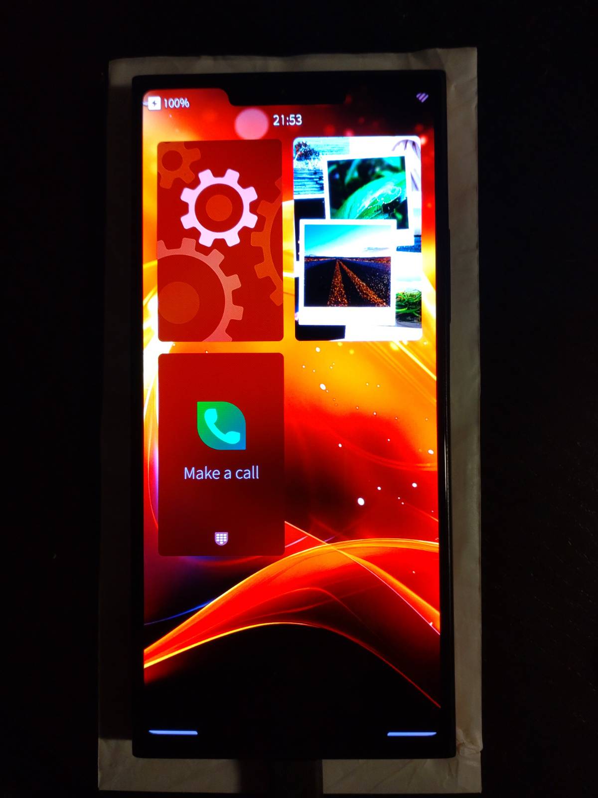

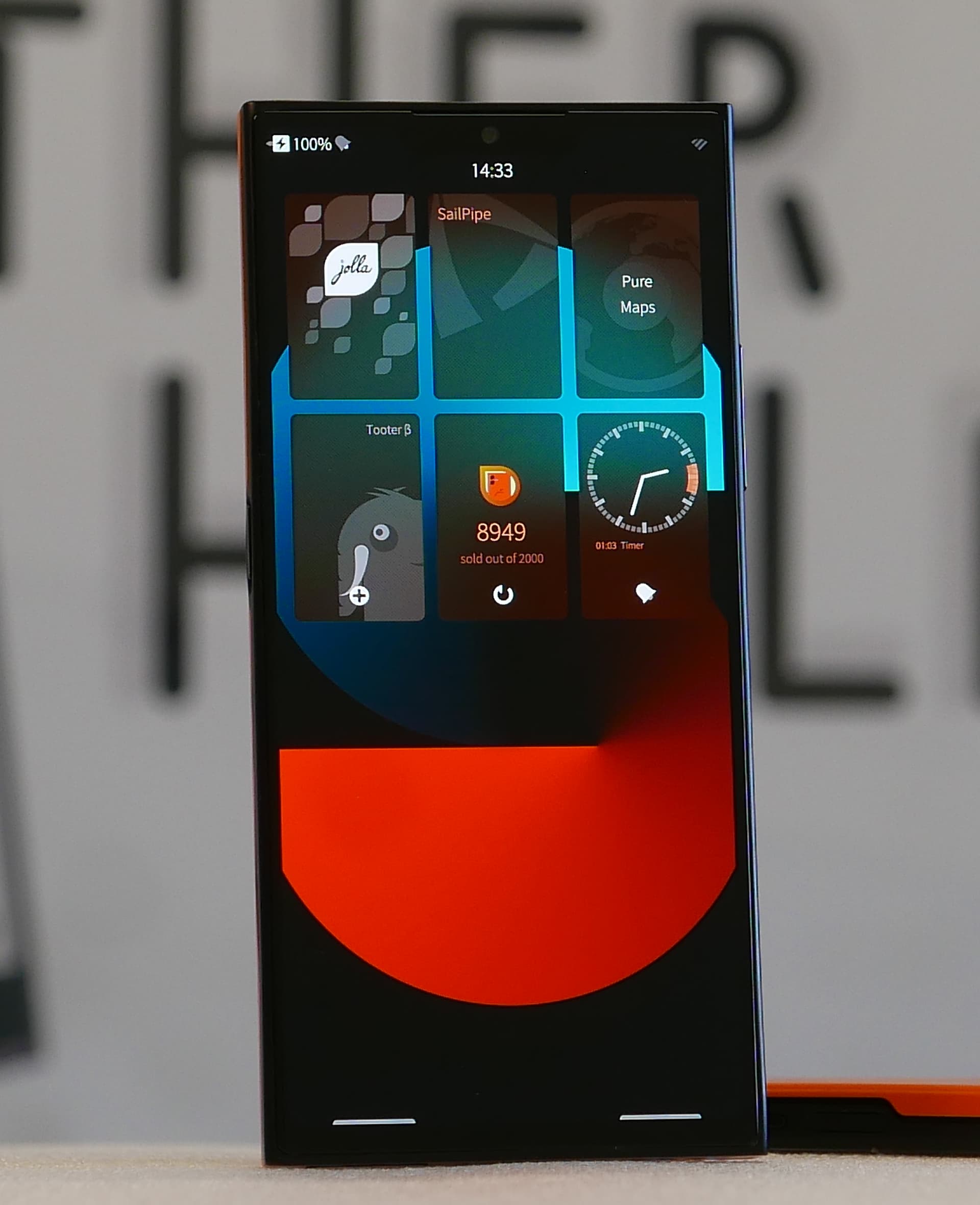

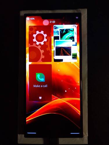

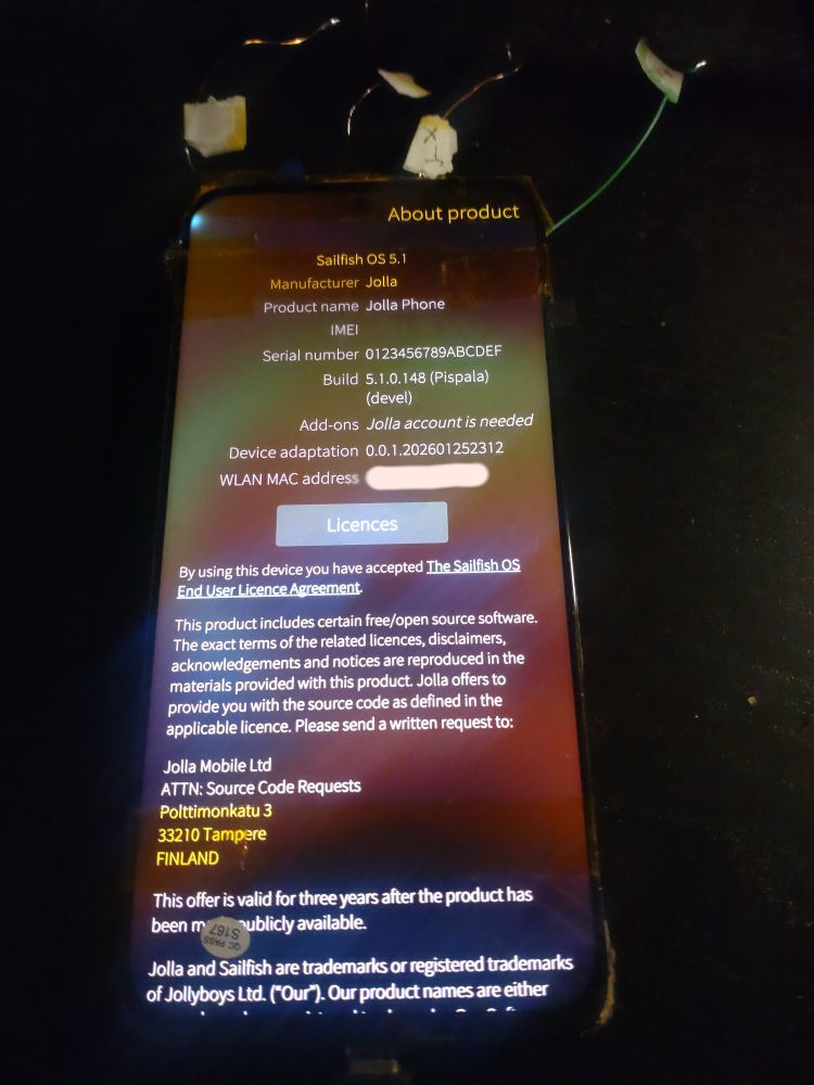

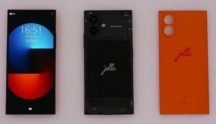

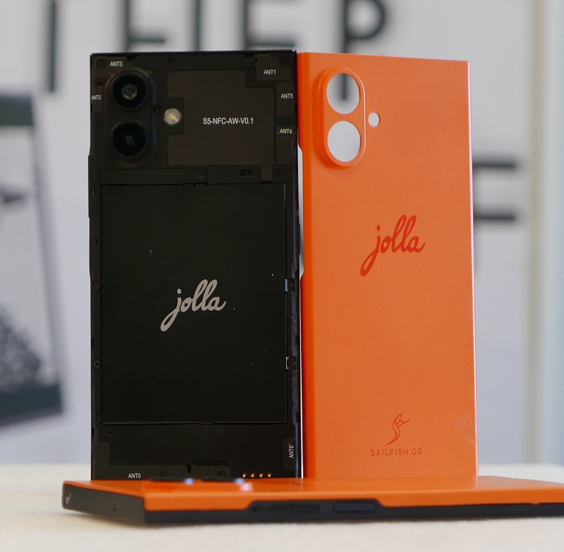

And it is booting up! As of late last week we got very first functional samples (we call it “CNC sample”) completed with the real mechanics, electronics, the SoC, modem, user-replaceable battery and everything together.

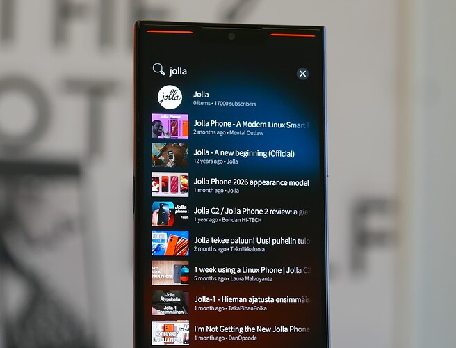

Very quickly from there we organised a two-day hackday in Tampere to pull it together, and happy to note that as a result we got it now booting up to the beautiful Sailfish UI! Wow!
Technical update
Let’s clarify some technical bits that have remained open for now:

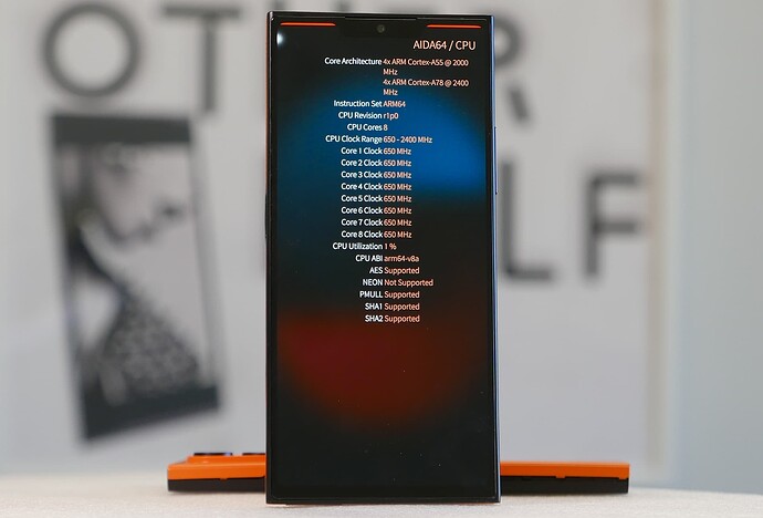

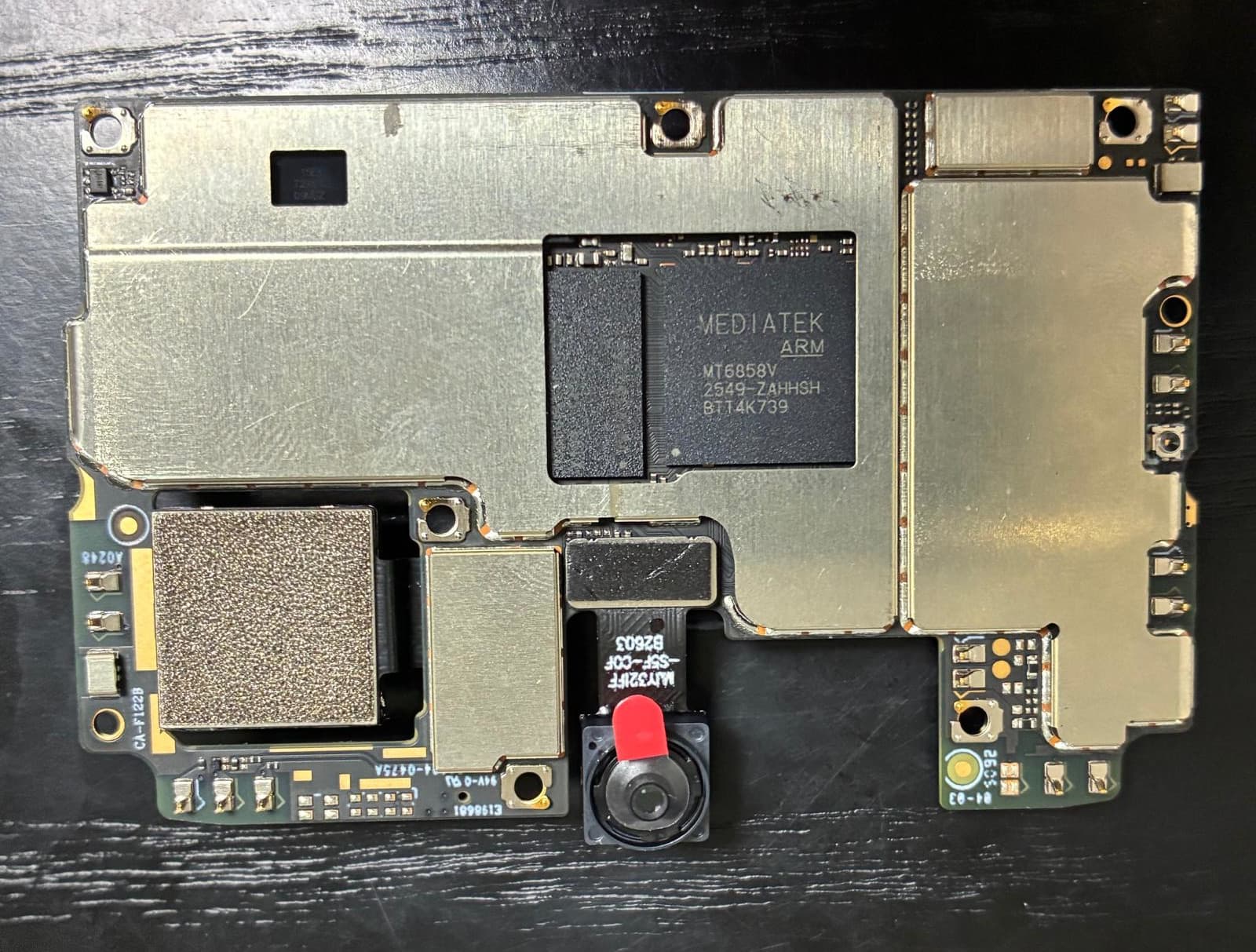

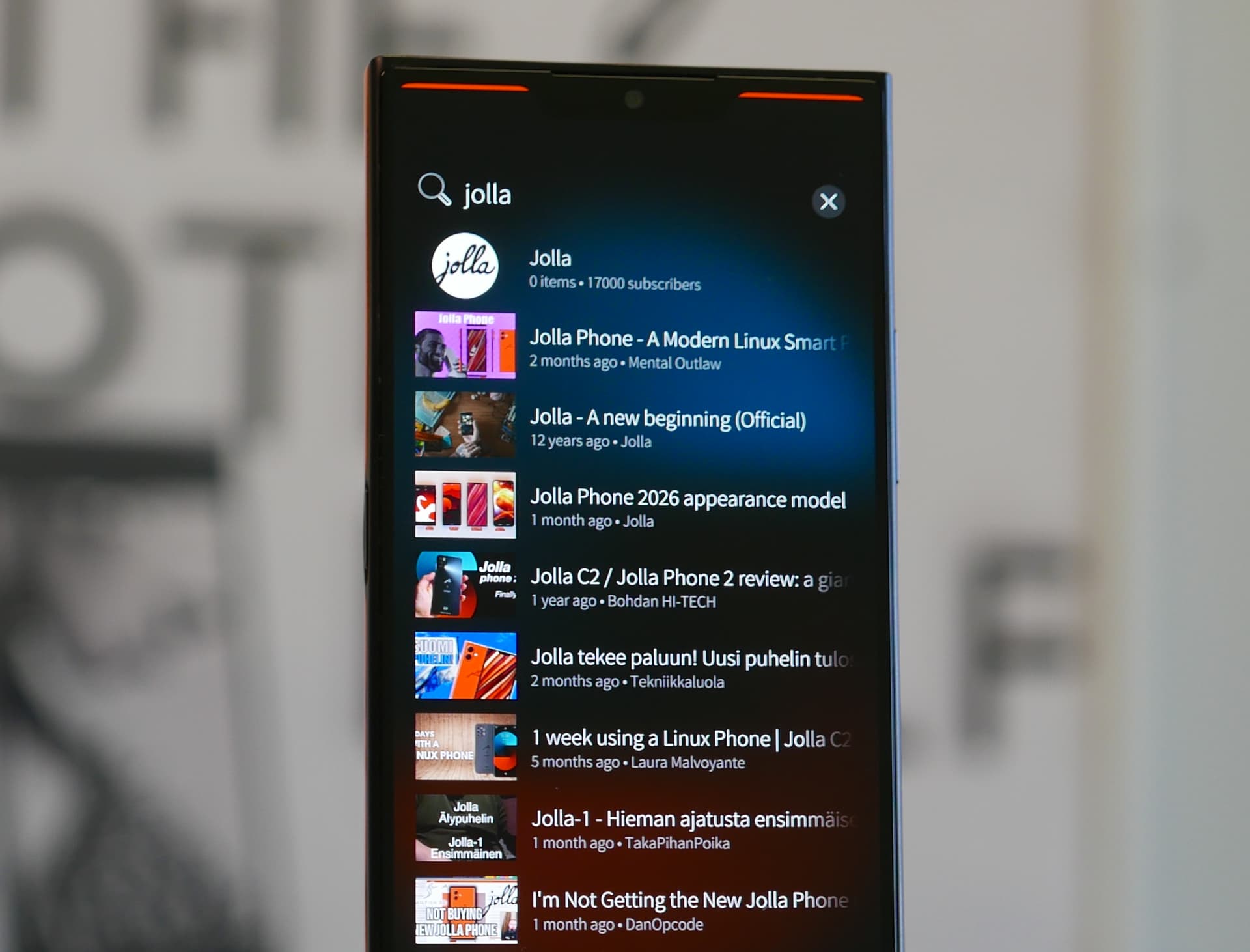

  • The SoC is Mediatek Dimensity 7100 (MT6858). Booting up the Sailfish OS on it and having the initial UX feeling in our hands - oh boy it is fast! It will be the greatest Sailfish OS UX thus far and won’t be shy in comparison to popular Android devices

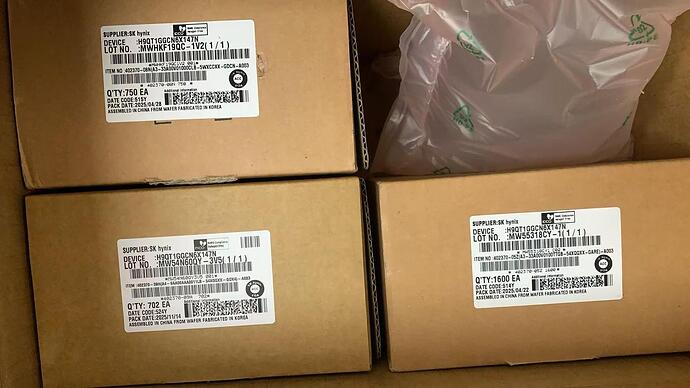

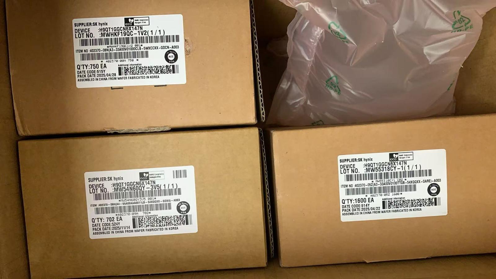

  • For the memory, we chose to go with a single-chip LPDDR4X RAM + UFS2.2 storage. While the memory prices are rallying like crazy, we managed to secure the initial batch with a purchase in end of January. The memory chips are made by Korean SK Hynix.

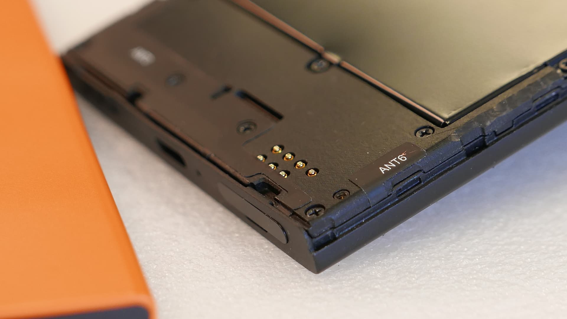

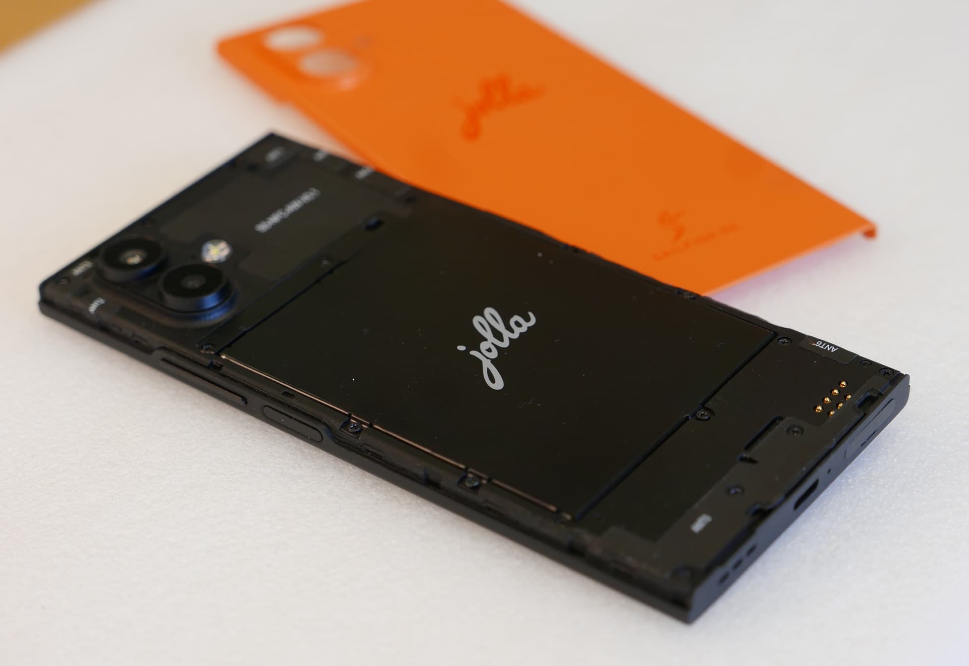

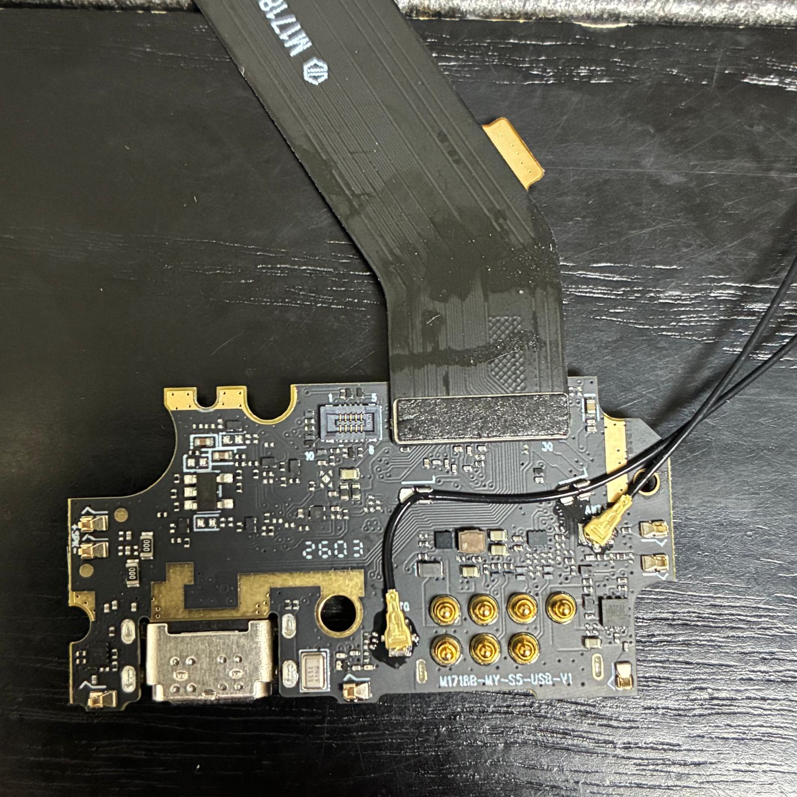

  • 7 pogo pins as follows
    • 5V_OUT (Phone → TOH)
    • GND
    • I3C_SCL (3.3 V logic, level-shifted from SoC 1.8 V)
    • I3C_SDA (3.3 V logic, level-shifted from SoC 1.8 V)
    • ID (resistor ladder → ADC on phone side)
    • INT (accessory → phone interrupt / wake line)
    • 5V_IN (TOH → Phone) - Similar to wireless charger input
  • The order of the pins will be finalized later, but currently those are planned to be in two columns, of 3 and 4 pins, as shown in above picture.
  • It will be using I3C in SDR mode, having theoretical maximum speed of 12.5Mbit/s. This is something we start verifying in next 1-2 months.
  • Full CAD pictures will be made available to enable 3D printing etc. experimenting

( Added few pictures )
Edit: As we finally got some time to focus on the photos, here is a few more! Enjoy :heart:
