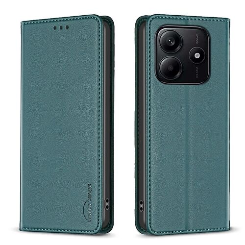

I just got a cover for Xiaomi Redmi Note 14 5G, and it feels pretty much as close to perfect as one can hope for in these circumstances. The camera hole in the back side is way too wide, but the right side buttons match those of Jolla and can be used with some effort. There’s even matching holes for mic(?) at the top and loudspeaker(?) in the bottom.
The color is more off-back than any green, but the 5G model has a working magnet without the extra flap for closing unlike the similarly-enough sized 4G.
Xiaomi Redmi Note 14 (5G) 162,4 x 75,7 x 8 mm
Xiaomi Redmi Note 14 (4G) 163,3 x 76,6 x 8,2 mm
Jolla Phone 2026 ------------ ~158 x 74 x 9mm
Do note the Pro models’ covers have a rounded camera hole too into the center of the phone, don’t look like a fit.
