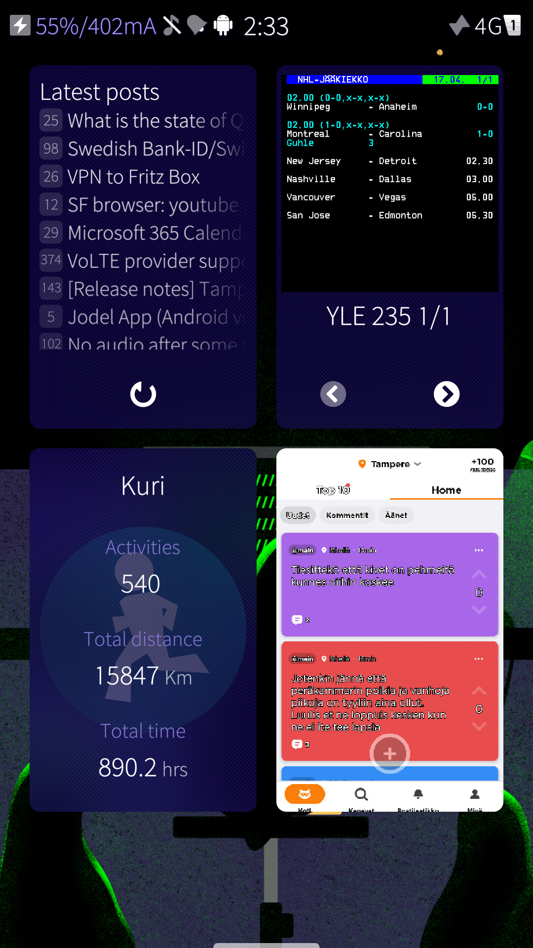

I got it working on XA2/4.5 (mobile data) with some difficulty and on 10 III/5.0 (WLAN) with a lot more difficulty.
First check that Lidl Plus works. In addition, after installing Jodel go to Android location settings and set MicroG and the NLP stuff to Always on and Jodel to When app in use.
Then in Sailfish settings turn location on and start GPSInfo and wait for a fix. Now start Jodel.
The email address is registered before the location fix so your account will be banned for spamming before you get started so you’ll be in read-only mode! So use one email alias to get through location and when the app starts switch to a new email.
This is the stupidest app I’ve come across: location is only needed at first start (like Lidl Plus), the app doesn’t ask for location permission, it confuses Jodel account and email address, it asks for email address every time location fails and treats every login retry as a Jodel post causing the spam ban.
