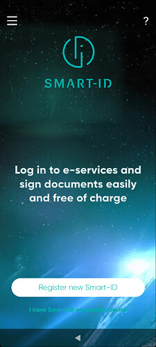

App installs, but when I start it, gives this error. At first I did not have microg installed, same result. Now I was finally able to install microg and same result. The microg had so many options, that I can turn on. Seems like I can try every option one-by-one or turn them all on any try if this works.

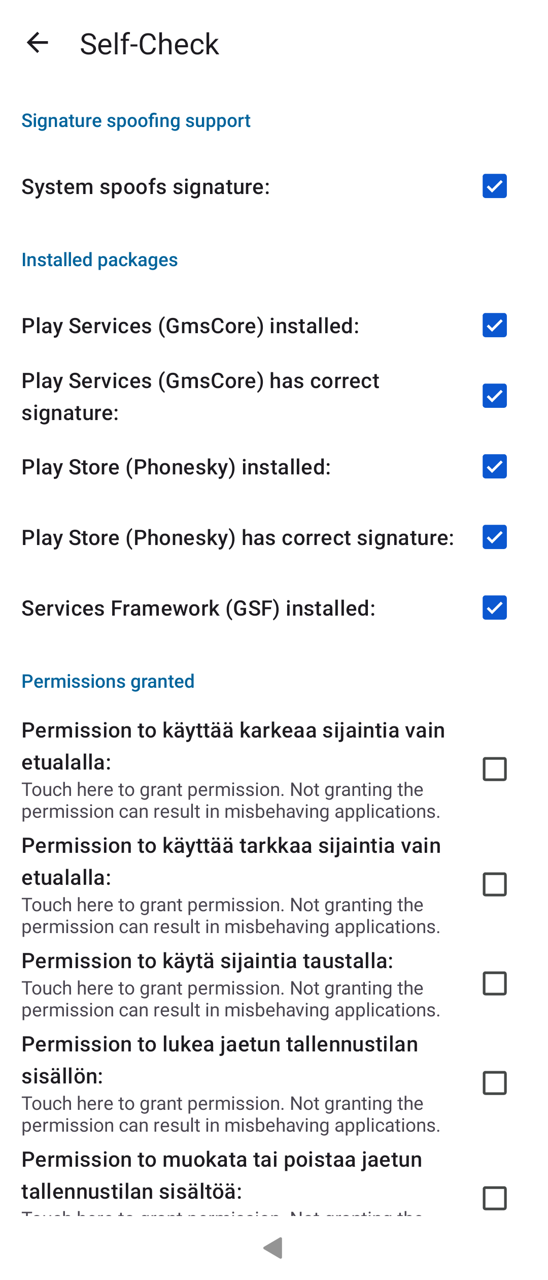

I have followed @flypig installation instructions Installing microG on Sailfish OS

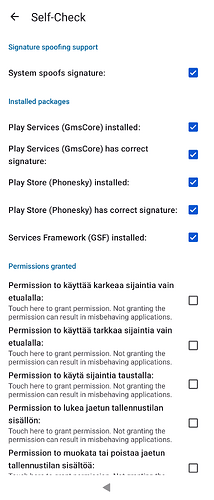

I tested SmartID app on my Xperia10 II. I could duplicate your error message by unchecking Playstore (Phonesky) has correct signature. When having MicroG installed properly like described in MicroG instructions I do not have any error messages.

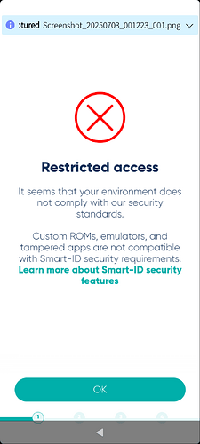

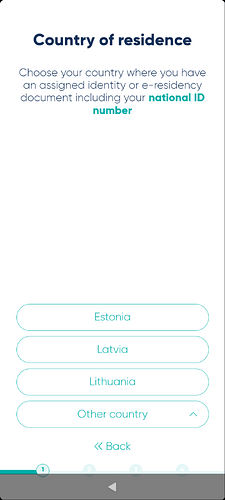

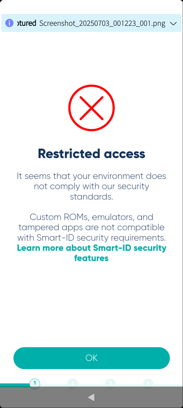

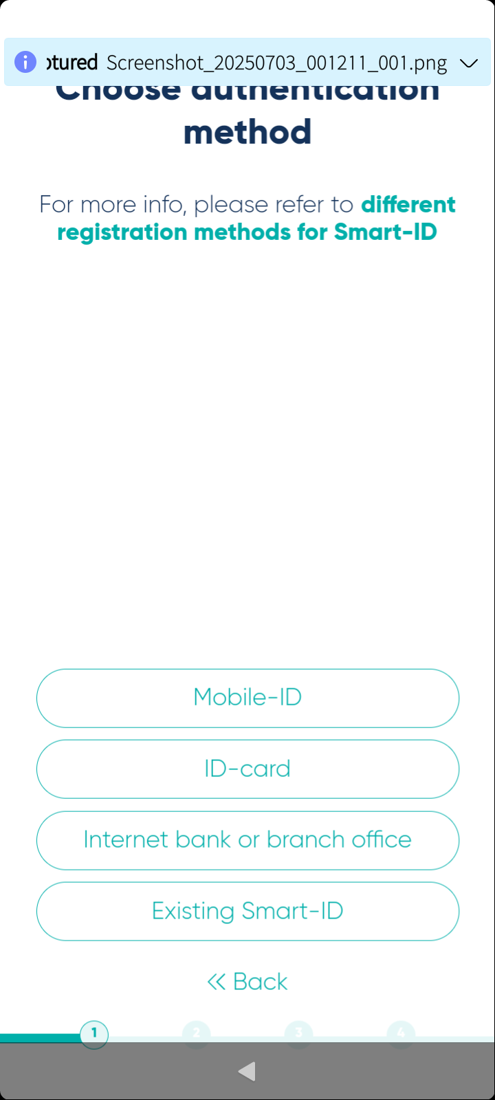

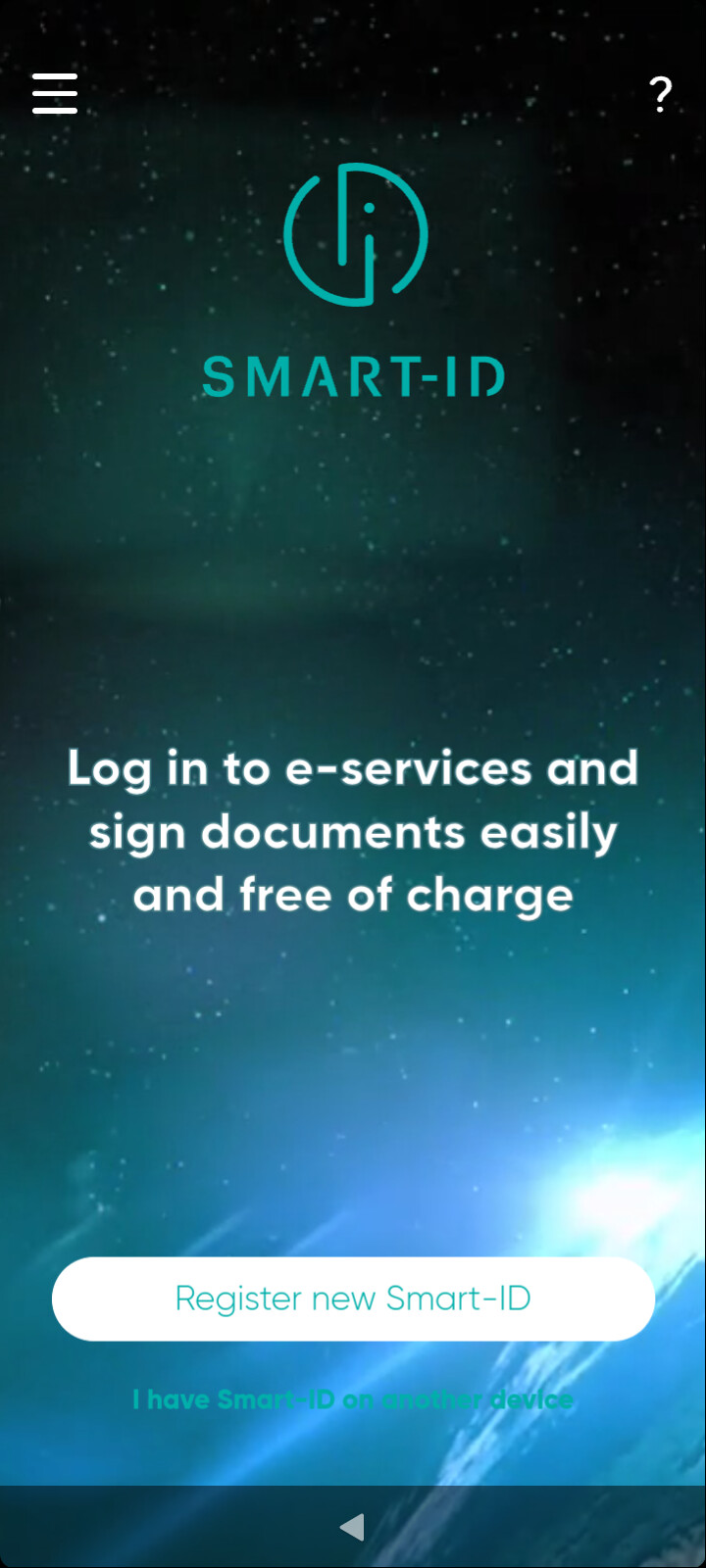

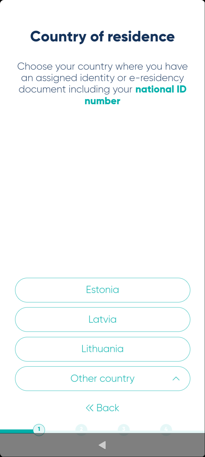

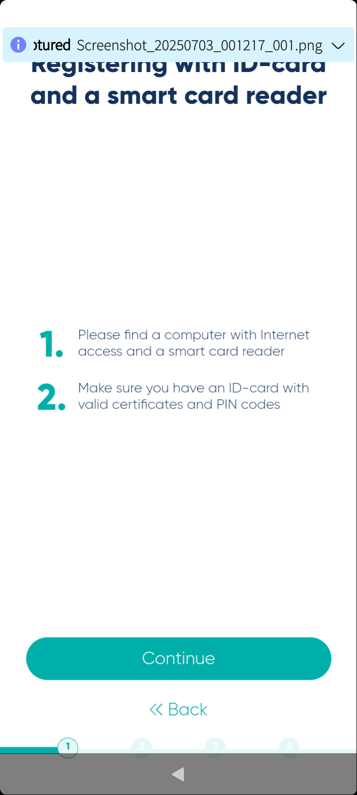

I did follow @flypig tutorial on microg and got SmartID app working, but seems they are very strict about supported opsystems. As they do not support custom ROMs etc. Last screenshot they are banning to go forward.
