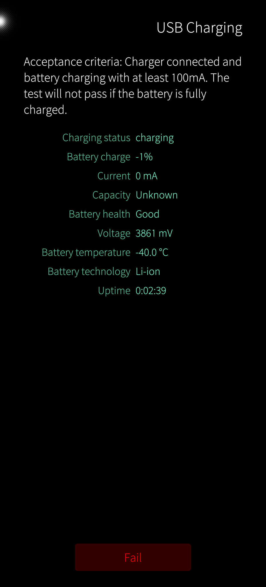

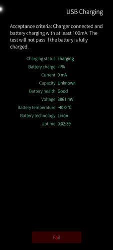

I learned about the Test tool CSD and run all the hardware tests. Everything else works but there is something wrong with the battery and the charging process (or both). 2 minutes after starting the device (after running battery dry as a test), it shows that the charging status is full at -1% and that battery temperature is -40°C.
As a test I used the device until the battery was empty (95 hours). After this the device no longer crashes on USB insert… But it does not start with USB attached (I have to insert USB after boot logo to use it) and it does not show battery % in the top menu. It behaves unexpectedly when inserting USB (sometimes showing Lightning Symbol, sometimes showing Lightning Symbol + attached cord). The top led is now white sometimes… Previously is was always red.
Camera Flash does not work either… But the Inari Blue cover works. :smirking_face: Could this be a hardware or battery issue? (I tested to detach the battery and re-attached it but it did not change the behaviour)
