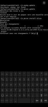

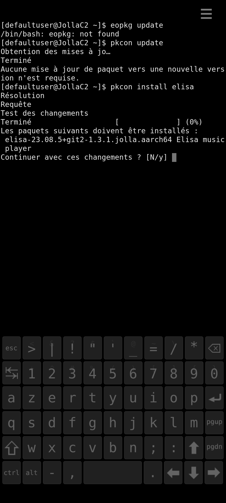

I just opened a terminal and tried to install an app that I thought might be compatible; Elisa is just one example among many (see the screenshot in my original post)
