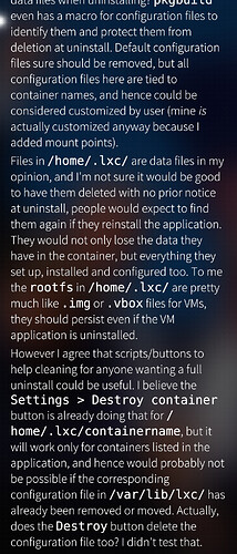

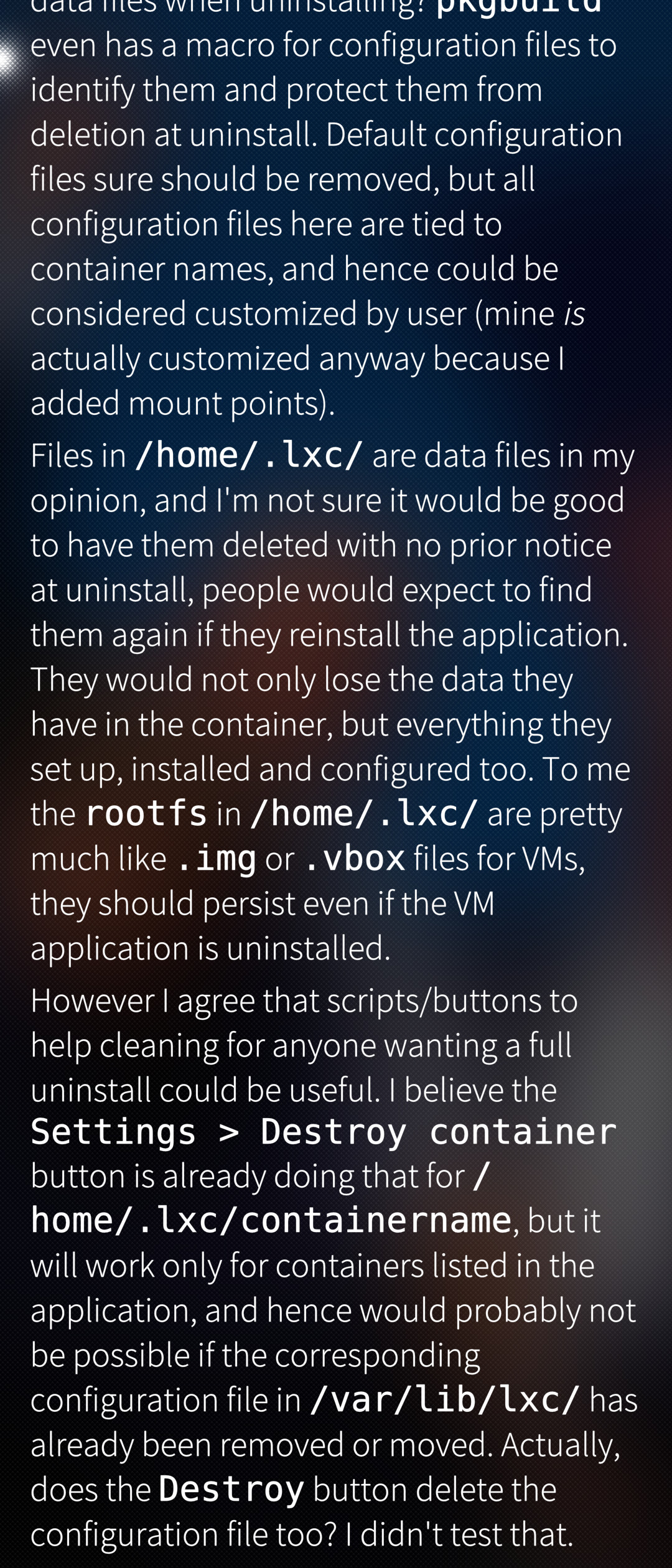

I believe I ran into this problem, the github issue I made at the time might be of use to you: Container broke and app is blank, how to reset settings? · Issue #28 · sailfish-containers/harbour-containers · GitHub

It looks like it’s using localstorage and sqlite, so you should be able to just delete its sqlite db in ~/.local/share/… (not sure if it uses appname or orgname past that, just look for a .db or .sqlite file in the Containers app location, use mc or find or something, it might be a directory just called harbour-containers, or some org.kabouik kinda stuff, looking at desktop file it has no orgname setup so should be somewhere under ~/.local/share/harbour-containers/…, example location from OTP app (but it uses orgname org.seiichiro) ~/.local/share/org.seiichiro0185/harbour-sailotp/QML/OfflineStorage/Databases)
Edit: or based on this harbour-containers/qml/components/Database.qml at master · sailfish-containers/harbour-containers · GitHub you could try to remove just the Debian entry that causes lxc-info to error out and keep other settings intact
Edit2: yeah just delete ~/.local/share/harbour-containers/ and /home/.lxc/Debian that should get you to vanilla state after reinstall based on this (hopefully no config files left in /var/lib/lxc…??? Leave that one alone)
