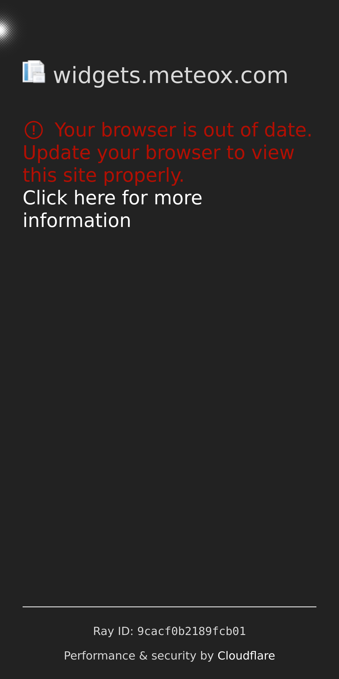

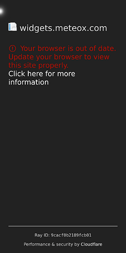

The rain view is now blocked by cloudflare which wasn’t the case with the last release, so i can’t say anything here

Sometimes it’s blocked. But 9 times out of 10, not.

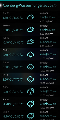

Just a few things

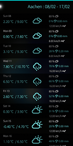

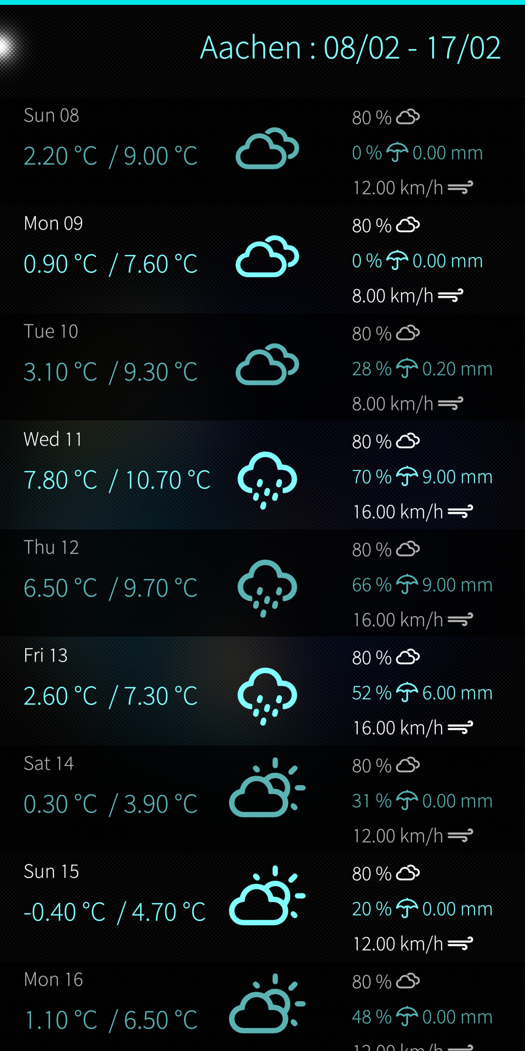

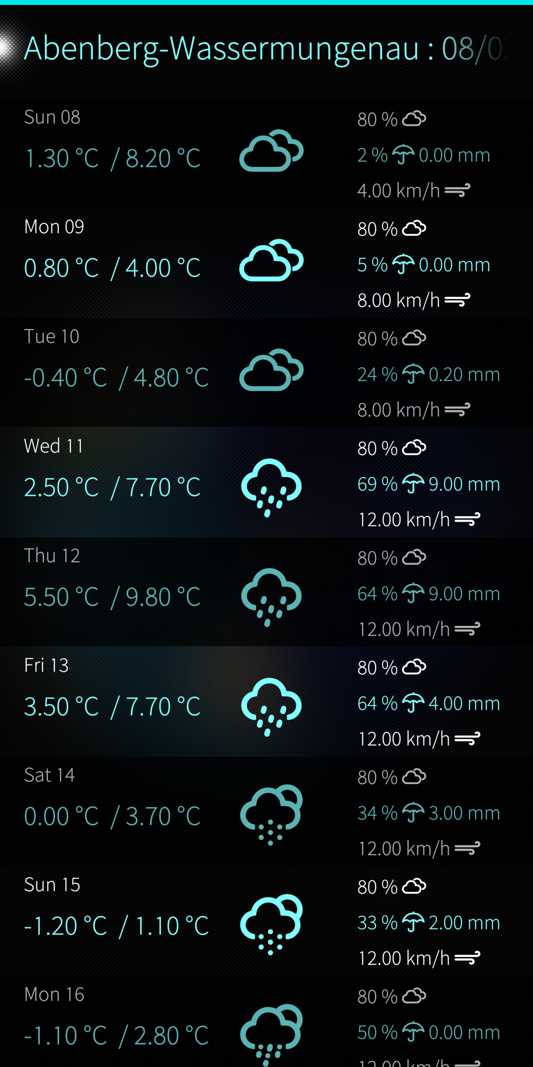

  • landscape mode would be a good addition, see screenshots (Aachen displays well, but Abenberg-Wassermungenau misses important info on top)
  • the rain radar did show a strange info at first, but after reading your 9/10 answer tried again and worked (I would not have interpreted the error like that)
  • about the digits, it seems all values have two digits?
  • adding locations works smooth, on removing more than one location (during remorse): only the first is deleted
