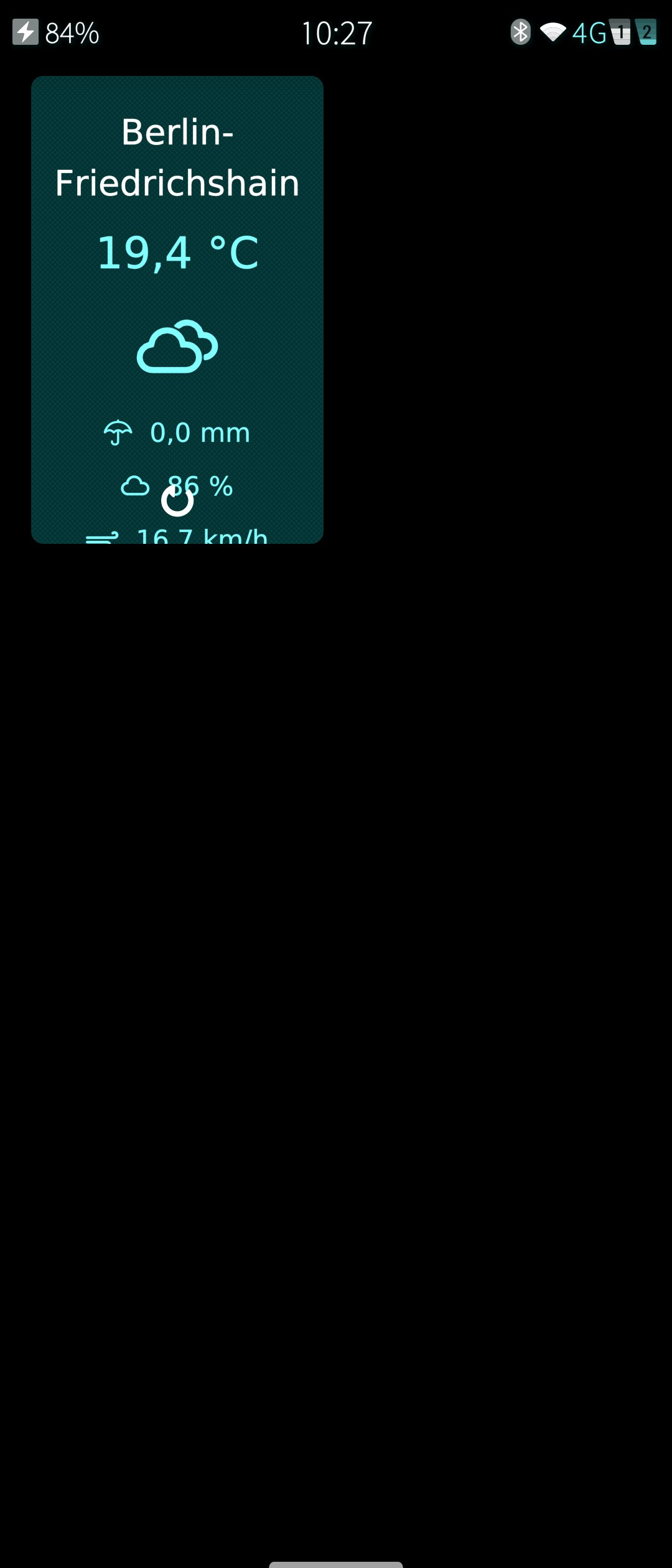

Just some thoughts about the app cover.
The displayed information doesn’t fit the tile as seen in the screenshot (v1.0.7 on SFOS 5.0.0.78, Xperia 10iii).
I think, if the values were shown just as whole numbers, one could place the temperature side by side to the main weather condition icon. To me, that would be enough accuracy for a quick glance.
Another option would be to put the rain amount next to the humidity percentage (discarding the small cloud icon) in one line as done within the forecast list within the app.

It’s one you only notice with longer place names :slight_smile: I’ll have a look at different options for making it fit …

Announcing v1.0.8 with layout fixes for cover, minor error corrections and, Meißen is in, I believe. Up on github, openrepos, coming to chum and harbour …
