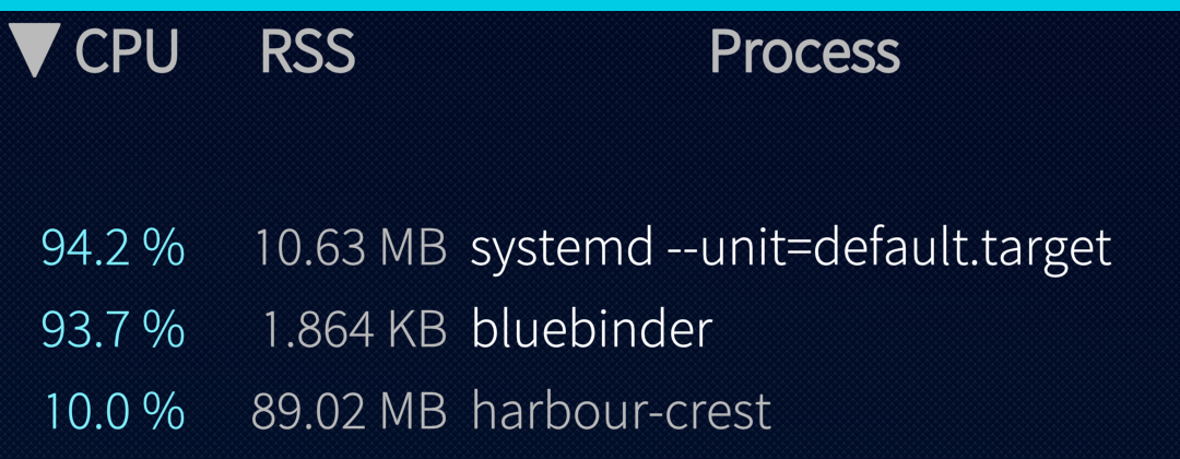

After a X10v restart, battery drain showed up its ugly face (and doesn’t go away)…
40% drop in 5 hours.
I used crest to check CPU usage, and I got this (attached). It does not look normal, or is it?
Edit: Forgot to mention that AppSupport is OFF, and actually never used.

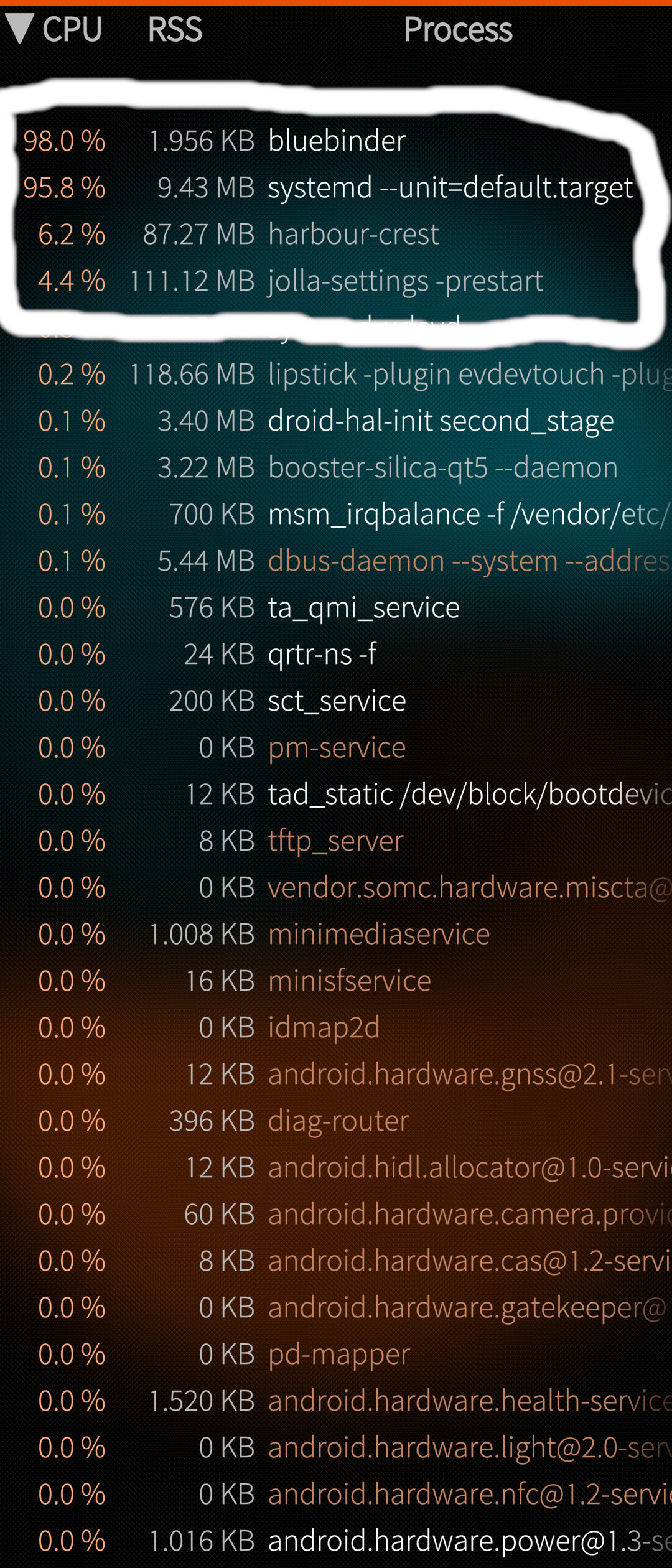

I also have a problem with fast battery drain.
I am currently using v4b blobs on top of Android 14.
Crest shows that two services are consuming a lot of CPU.
there is the process name. just stop bluebinder with systemctl stop bluebinder
Yep, I can do that. What process is it?
