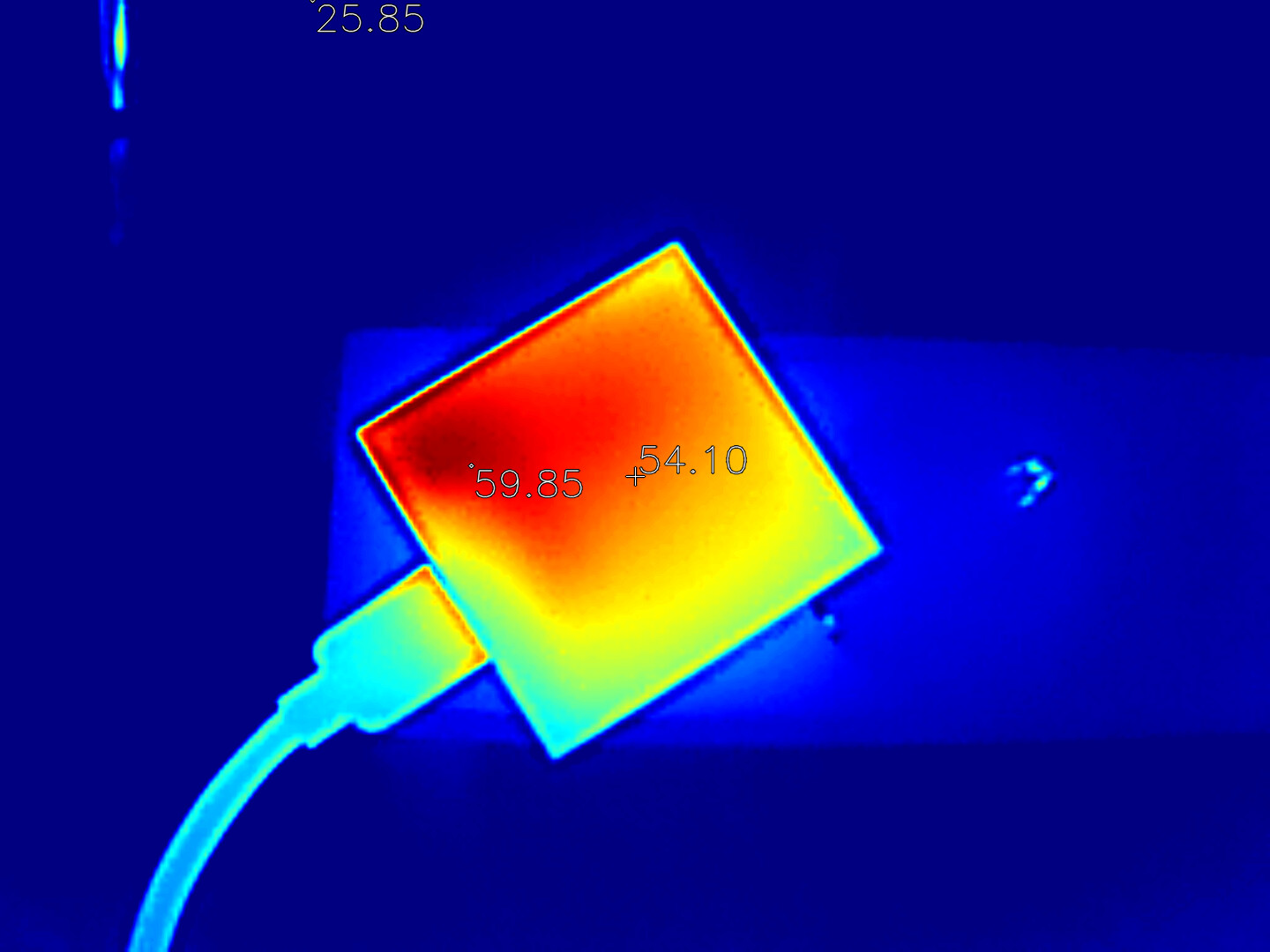

It gets a little bit toasty for me to recommend it outright. This was after putting 1Ah into the 10 V (as measured on the cable). Charging the 10 III, the max i saw was 51 - which actually feels quite reasonable to the touch. (Ambient is 25). Doing the full 35W with this will get quite toasty most likely. Not sure what the JP2601 will max out at, since i don’t have one yet.
Thermal image by my app harbour-thermalcam. Find it on Chum.
Is that youre charger there getting that hot ? Looks like u can fry egg on it
Yes, that is my newly purchased Reduct edge.35.
63C is a good egg temperature… so close enough.
It is not a lot of mass reaching that temperature though. (Perhaps a design flaw in its own right).
If i put my hand on it, it drops at least 5C right away, and 50C feels downright reasonable. So i suspect other chargers also get hotter than we think they do.
