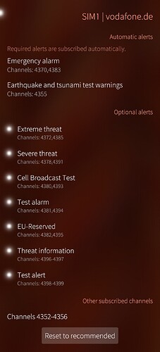

I also installed nephros’ cb manager, and for me it shows something like yours under supported by network before but i edited it to 0-9999, maybe thats the fault.
I have the configuration
919,4352-4356,4370-4379,4383-4392
→ identical and it worked
Is there a way to reset it (uninstall nephros patch and reinstall?), because i’m not sure if the values are exact similar to yours.
Otherwise i fill in your values.

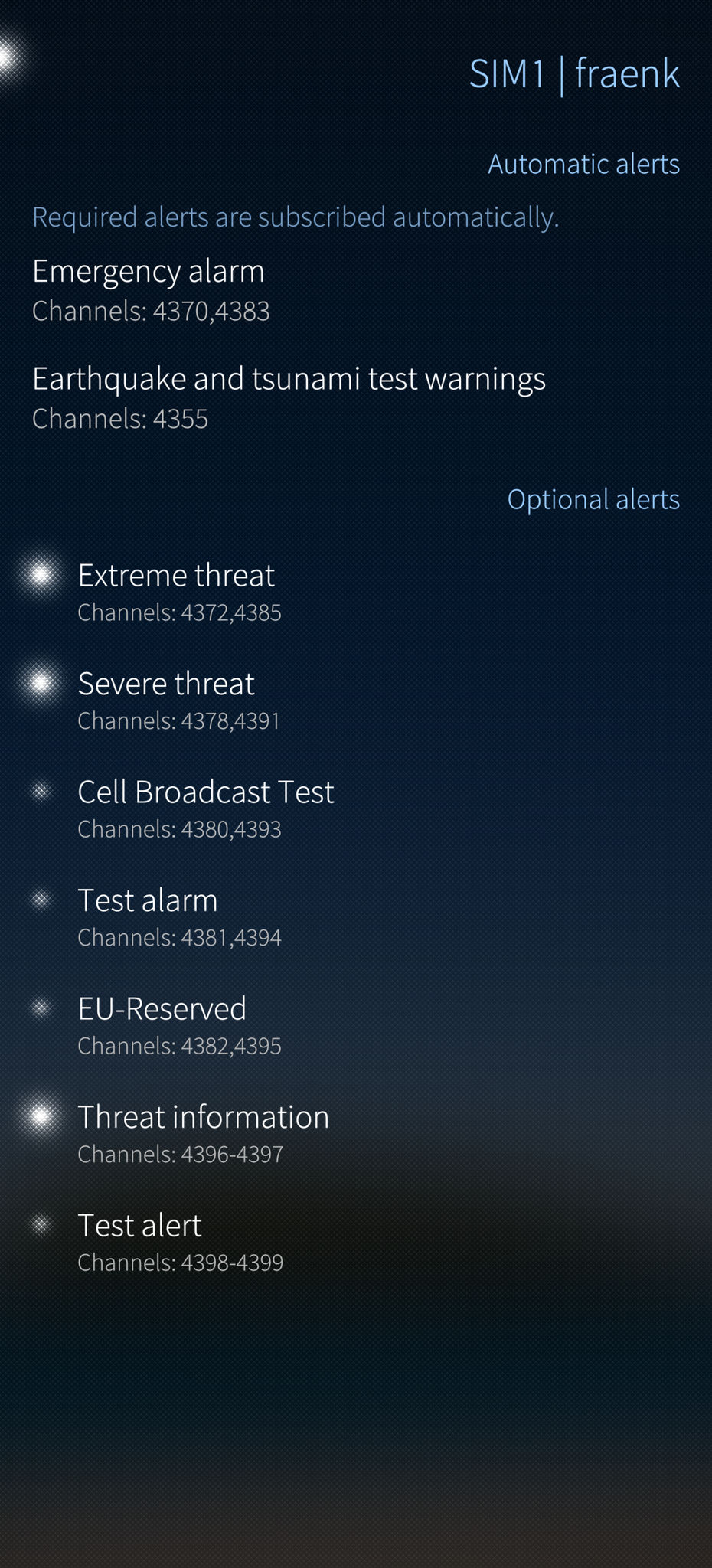

No warning on Jollaphone 2026 on Telekom (Fraenk).
However, I think “Cell Broadcast Test” alerts are disabled by default in SFOS

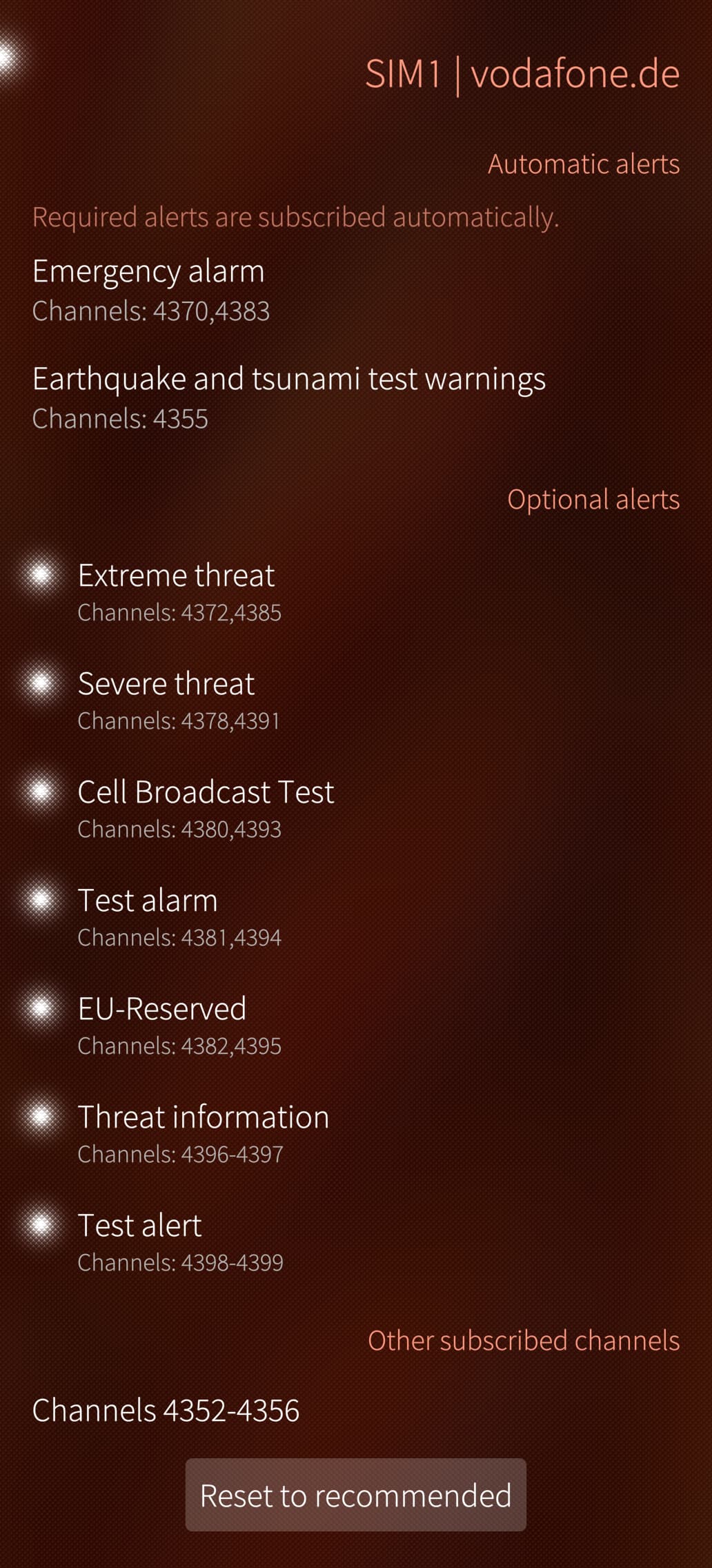

No alert on Jollaphone 2026 with all channels subscribed. (Vodafone)
That shouldn’t be an issue, because warnings on the Warntag are published as Level 1 (channel 4370) and for compatibility on channel 919. The “Entwarnung” signal is published on channel 4396.
