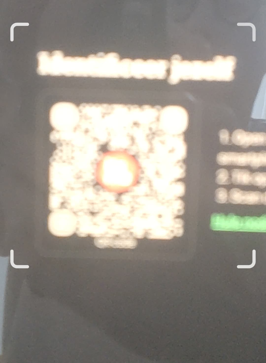

I try to scan a qr code into my Android apps, it seems it’s verry noise and blurry into every Android app i have installed.
For example install Itme, Bancontact app or Hello Bank app… scan qr code
Should scan the qr codes correctly, i have attach a screenshot of a qr code what i would like to scan into the Itsme app.

However I cannot reproduce it anymore, the picture is perfectly sharp. Does the app you’re using not support tapping to focus the camera?
No focus i try already for days to get it working… None of my apps that need to scan qr code do focus automatic or tap focus….(:
