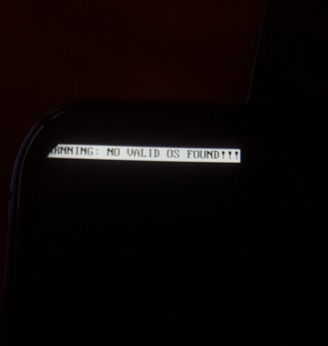

I’m writing now because my C2 stopped working over a month ago and I haven’t got any response from Jollas customer support:
On Christmas Eve when I tried to restart my C2 I got a message on the startup-screen: ”No valid os found”. Then the device shuts down, and the phone has been broken ever since. Prior to that I had been using my phone normally, so I have no idea what could have caused the problem.

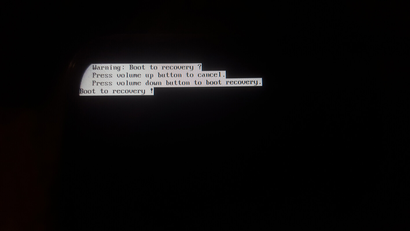

C2 has a recovery mode enabled since 5.0.0.72 relesead on 11.11.2025.

Thank you, I was able to initiate the recovery mode :+1:
But then unfortionately the phone restarts and the “no valid os found”-message reappears.
Did I understand correctly that you are suspecting a hardware-problem?
You understood correctly. But you can try to reflash anyway.
