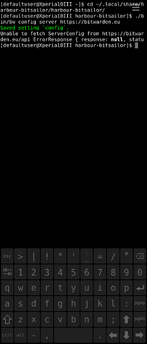

You can try logging in manually from the CLI to check whether it works:
  • cd ~/.local/share/harbour-bitsailor/harbour-bitsailor/
  • ./bin/bw config server https://bitwarden.eu
  • BW_CLIENTID=<your-client-id> BW_CLIENTSECRET=<your-client-secret> ./bin/bw login --apikey
Replace <your-client-id> and <your-client-secret> with the actual values. If any error pops up, that’s what’s preventing the login.
I got following outout from terminal with the second bullet
According to this the correct url might be https://vault.bitwarden.eu
…….. Stupid me …. Thank you, you kind sir :heart: Have a great weekend!

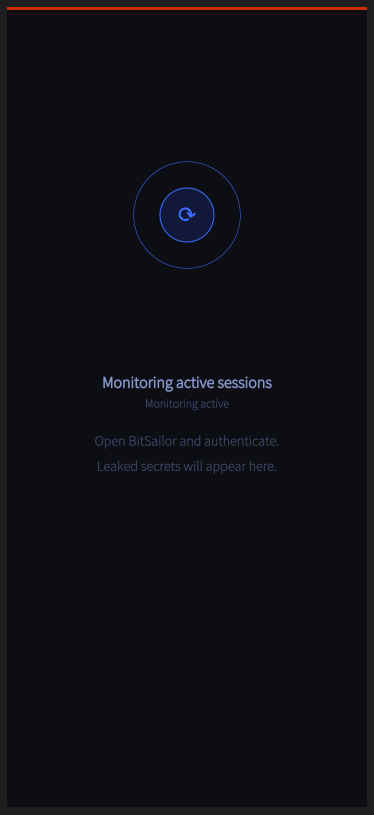

There would appear to be a critical security flaw with BitSailor that can leak your master password, username, and tokens to any unjailed app running on your phone.
This was discovered recently due to a post BitSailor’s dev made on my plex app thread here but I fear BitSailor’s users won’t see that so I’m commenting here.
I made a repo that demonstrates the problem with a proof-of-concept app and remediation suggestions on github: https://github.com/sailfishdisclosure/BitSailorVulnerability
vulnerability
There also appears to be one oversight with files in the “patch” folder that has the potential to lead to another major vulnerability in the future.
If BitSailor’s developer wants to reach out to me privately I can disclose the vulnerability and give him advice on how to patch these issues.

I asked the developer to reach out to me privately, he never did. He just replied to a comment telling me to message HIM, that’s not what I asked him to do. Where I come from, when people do you favors, you don’t make them come to you.
He did patch the most egregious bug that leaked your master password using the AI he hates so much but it is still VERY vulnerable. All your secrets are still accessible with one small tweak to my existing app.
Your one saving grace is that the Sailfish community is quite small, and I doubt there are many bad actors (if any) floating around here.
On open source, I want you to keep in mind that this was open source for what, 4 years? and no one noticed in all that time it was committing one of the worst possible security faux pas you can possibly make in the industry - for disclosure: he was sending your master password in plain text on the command line so any unjailed app could pick that right up from /proc.
I think even non-developers will know that you should never, ever, ever do that.
