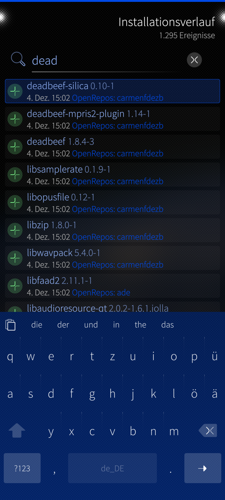

Installed deadbeef fork from carmen (openrepos)
Then try add location

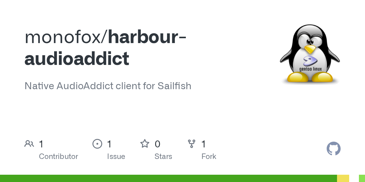

Does it sound like this issue Playback Stutters · Issue #2 · monofox/harbour-audioaddict · GitHub ?
Tidal player used to stutter on first song too.
Now not, changes were: python-tidal update and switching to amber-mpris
Maybe amber would help. Nemo.. Mpris is obsoleted anyway
In channelpage.qml
Org.nemomobile.mpris …
Else seems like a simple tiny app, should be easy to update and compile and update against a fresher target

I had also problems when installing it back then, this direction should work (install from down to top)
