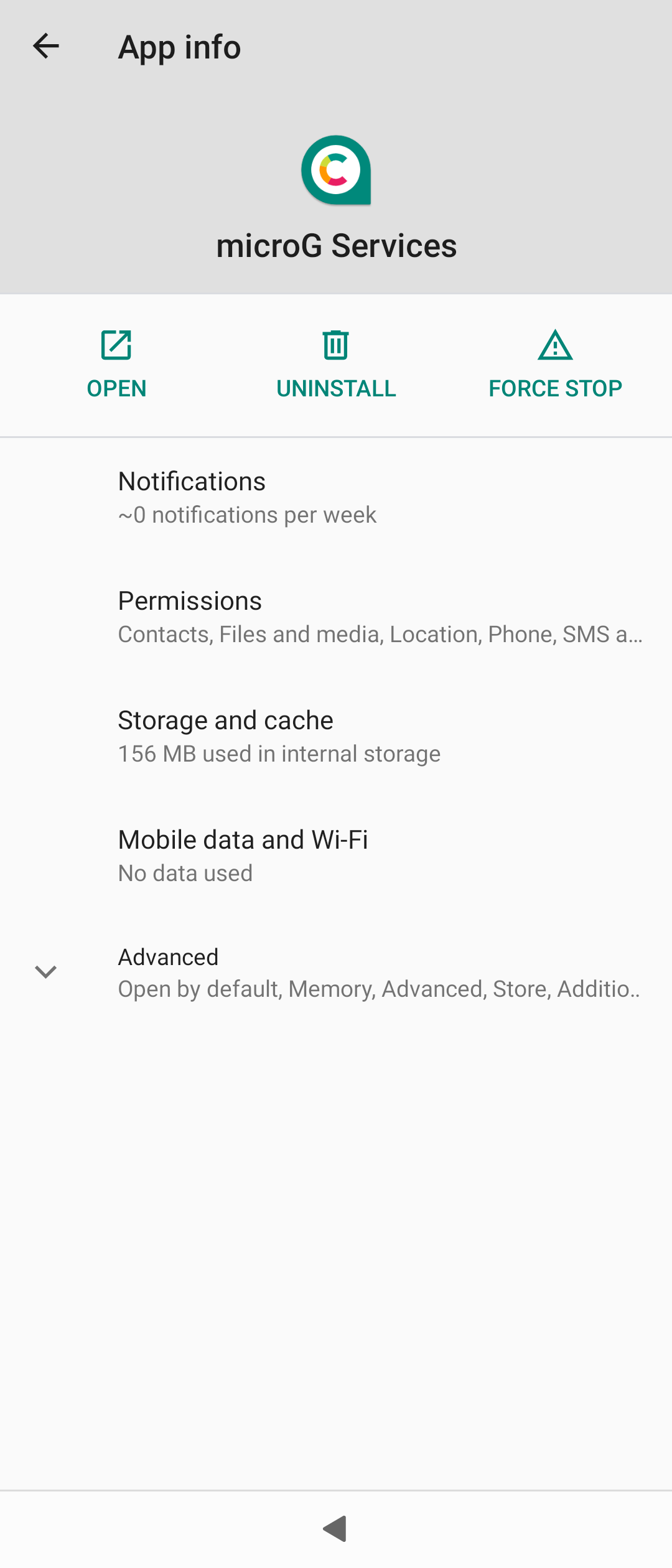

I had this kind of issue with parking app on my Xperia 10 and the solution was to change the Location-permission of microG Settings under the Android-settings from Only when in use to Always.
