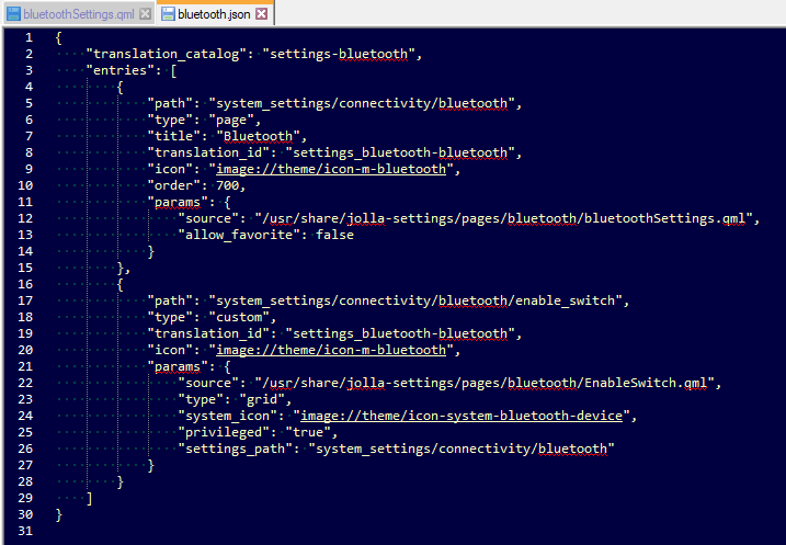

I changed the file /usr/share/jolla-settings/entries/blootooth.json in line 13 the false to true. This should activate favorite at BT connections.

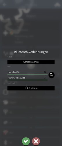

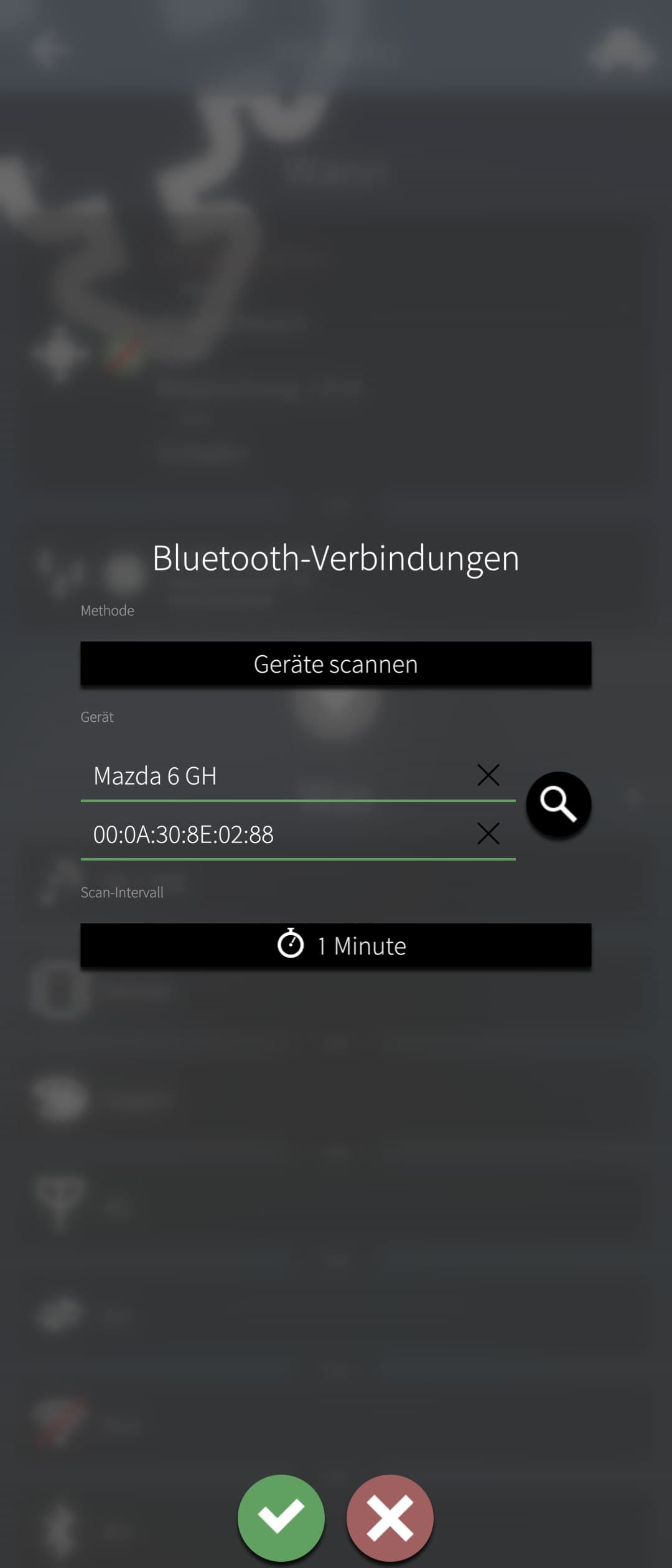

I am a active user at the app Situations and I create a profile car. In this I use now the BT search function to see my car and switch on the care mode. In the App you can choose the interval. I have taken 1min.
