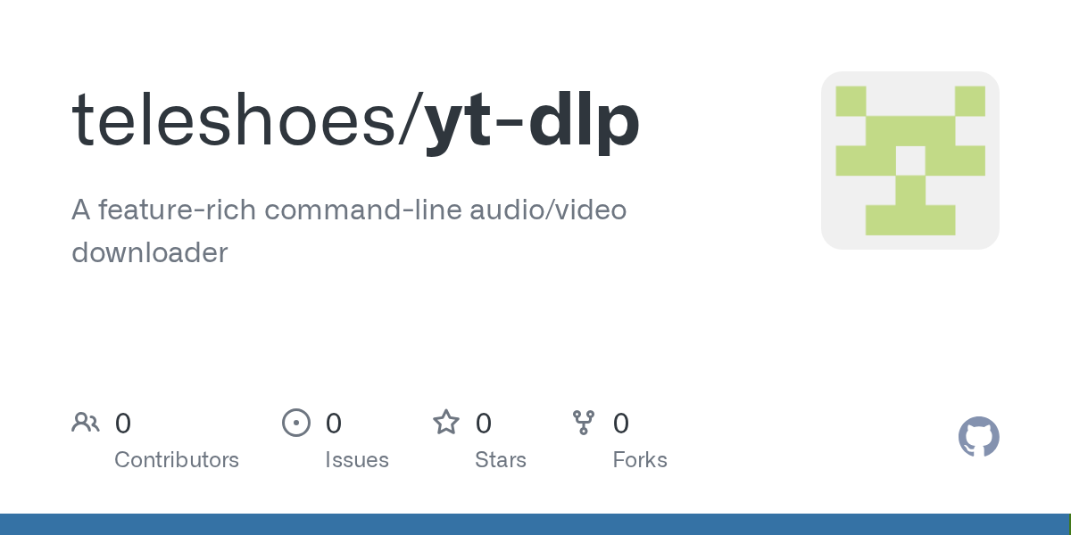

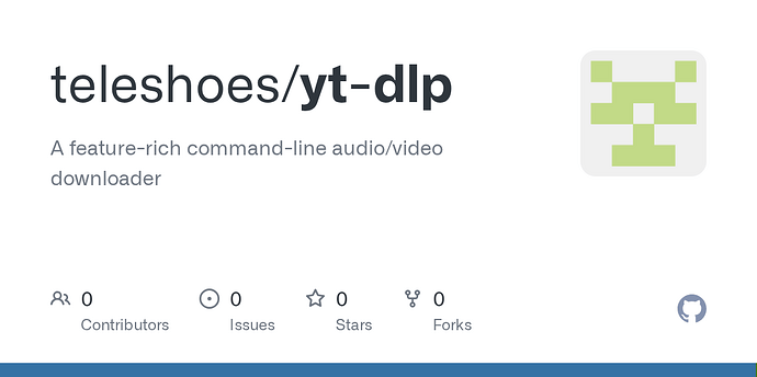

i forked yt-dlp and re-added python3.8 support here:
just tested and it works on my xperia 10iii on sailfish 5.0.0.68 on python 3.8.18 to download videos from youtube
edit: here is a binary that should work until youtube changes things:
https://github.com/teleshoes/yt-dlp/releases/download/v2025-08-27%2Bpy38/yt-dlp
NOTE: yt-dlp fully removed support for python3.8 last year. previous versions deprecated support for py3.8, but it still worked, which was great until websites made changes making the old versions useless. newer versions fixed the problems but python3.8 was unsupported. my fork has the fixes in version 2025-08-27, and makes python3.8 work again, but keeps py3.8 deprecated.

Huh. I thought this wasn’t possible anymore, but this version upgrades just fine, whereas both teleshoes and release don’t. After running --update-to nightly on all 3 versions:
[defaultuser@Xperia10II-DualSIM bin]$ ./yt-dlp_teleshoes --version
2024.10.22.051025
[defaultuser@Xperia10II-DualSIM bin]$ ./yt-dlp_linux_aarch64_release --version
2024.10.22.051025
[defaultuser@Xperia10II-DualSIM bin]$ ./yt-dlp_linux_aarch64_nightly --version
2025.08.30.232839
So both release and teleshoes actually downgraded after upgrading.
