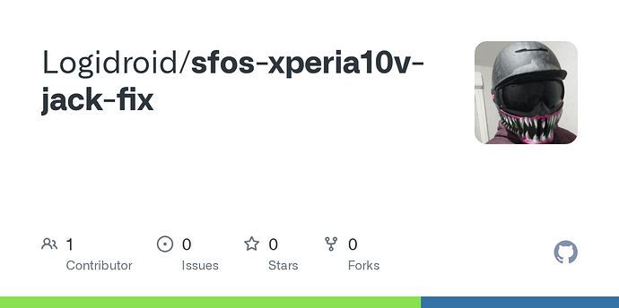

Workaround for the headphone jack on official Sailfish OS
(Xperia 10 V tested; may also help Xperia 10 IV)
On the official Jolla port, plugging headphones does nothing even though
the kernel detects the jack. PulseAudio never gets
output-wired_headset / output-wired_headphone ports because
/vendor/etc/primary_audio_policy_configuration.xml does not declare
AUDIO_DEVICE_OUT_WIRED_* devices.
This is a no-root, no-reflash workaround: copy the vendor audio policy
into $HOME, patch in wired headset/headphones (+ mic), and start
user PulseAudio with that config via a systemd user drop-in.
Repo + install.sh:
On the phone:
git clone GitHub - Logidroid/sfos-xperia10v-jack-fix · GitHub
cd sfos-xperia10v-jack-fix
chmod +x install.sh uninstall.sh scripts/*
./install.sh
Tested on Sailfish OS 5.1.0.11, Xperia 10 V (pdx235 / XQ-DC*).
Not tested by me on Xperia 10 IV, but the official IV/V ports share the
same class of missing wired ports in audio policy — feedback welcome.
This only restores the jack on the official port. It is not a full
replacement for community Lineage-based ports (camera etc.).
If a future SFOS update already exposes wired ports, uninstall with:
./uninstall.sh

Update: I fixed a serious bug in my jack workaround and recovered without
wiping any data.
The first version could leave an infinite spinner after the security code
(Pulse override in ~/.config/systemd/user/pulseaudio.service.d/jack-fix.conf).
I removed that file via Jolla Recovery (mount home, delete the drop-in,
restore hybris-boot) — no factory reset, data kept.
Safe version is now on GitHub (v2.2)
If you hit the same spinner: see RECOVERY.md in the repo. Do not reflash/wipe
home unless you have no other option. Then reinstall only from current master.
Thank you so much for your work! :heart_eyes: It works on my Xperia 10IV—one more step to start using it! :folded_hands:
Do you plan to commit your change in @jolla 's github?
I don’t know how to do this but it would be good I think yes
