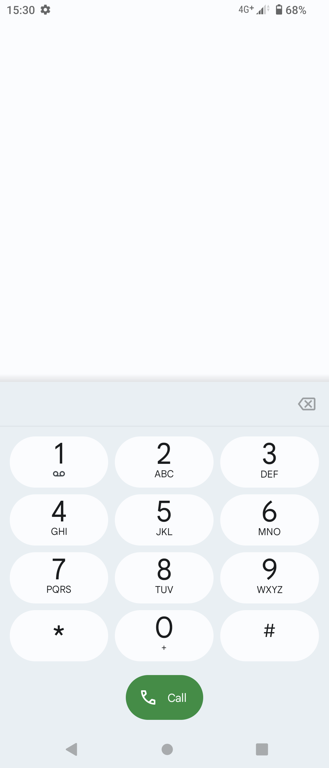

I locked bootloader and reflashed oldest Android (11) I coud get with Xperia Flash Tool and from that manually updated to latest version (13) hoping, that somewhere in the process it would start working. It doesn’t.

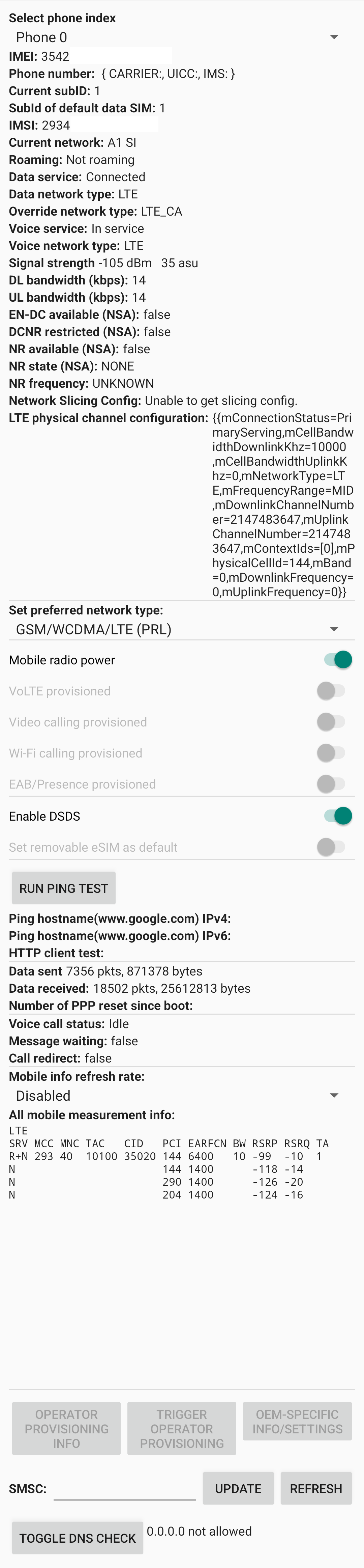

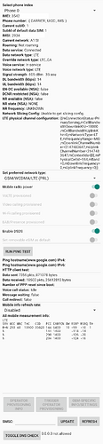

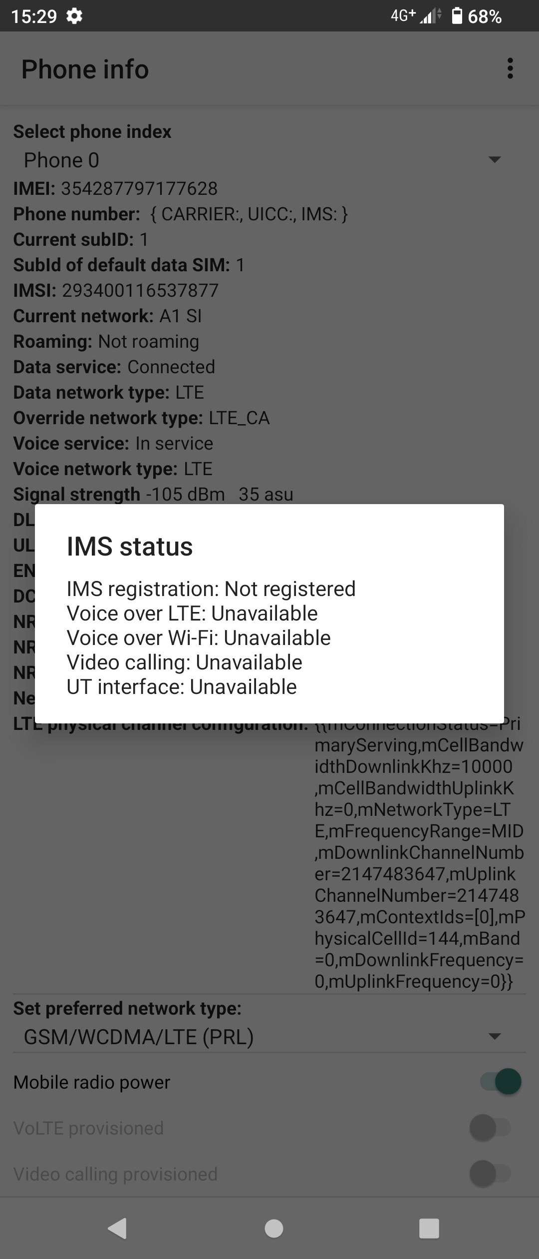

I attached few pics of current state with android 13 installed (62.2.A.0.533) - this one was flashed with Xperia Companion under Windows as suggested by AI as it might “repair” device to working state.
To my undestanding the culprit is IMS not registering and if it does not work with Android, it will not work with SFOS.
Please note that (to my knowledge) VoLTE and VoWIFI didn’t work before with neither of 2 operators I tested (A1 and Telekom) with SFOS so that status on last pic is something I actually expected. My operator (A1) disabled 3G in july 2023.
