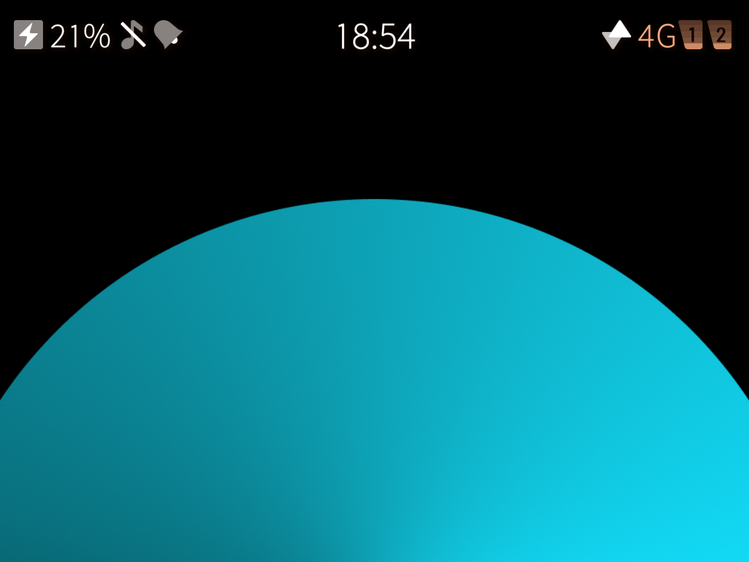

I decided to test Sailfish 5.1.0.11, and unfortunately the same LTE issue came back immediately (signal stuck at one bar, unstable behaviour). After over five years of using this Xperia 10 III, first with Android and then with Sailfish, the hardware is no longer in good condition (display ghosting, etc.). For now I’ve decided to keep it on the last stable version that works for me (5.0.0.71) and wait for future updates. I’m also considering moving to a new device soon, maybe the Xperia 10 IV or the 10 V once it becomes more stable.I’ll leave this thread here in case the information helps other users or future ofono updates.
LTE signal stuck at one bar on 5.1.0.11
The LTE signal stuck at one bar was introduced in one of the 5 0.x updates, when they changed the behavior of the bar. For me ts always one bar and everything is fine.
Thanks! In my case it wasn’t only the cosmetic one‑bar issue. Even outside the modem stayed locked on Band 7 with just one bar, when it normally shows full signal on 5.0.0.71. And in the Milan underground the signal went up, but it still remained stuck on Band 7. So it seems to be a different issue.
