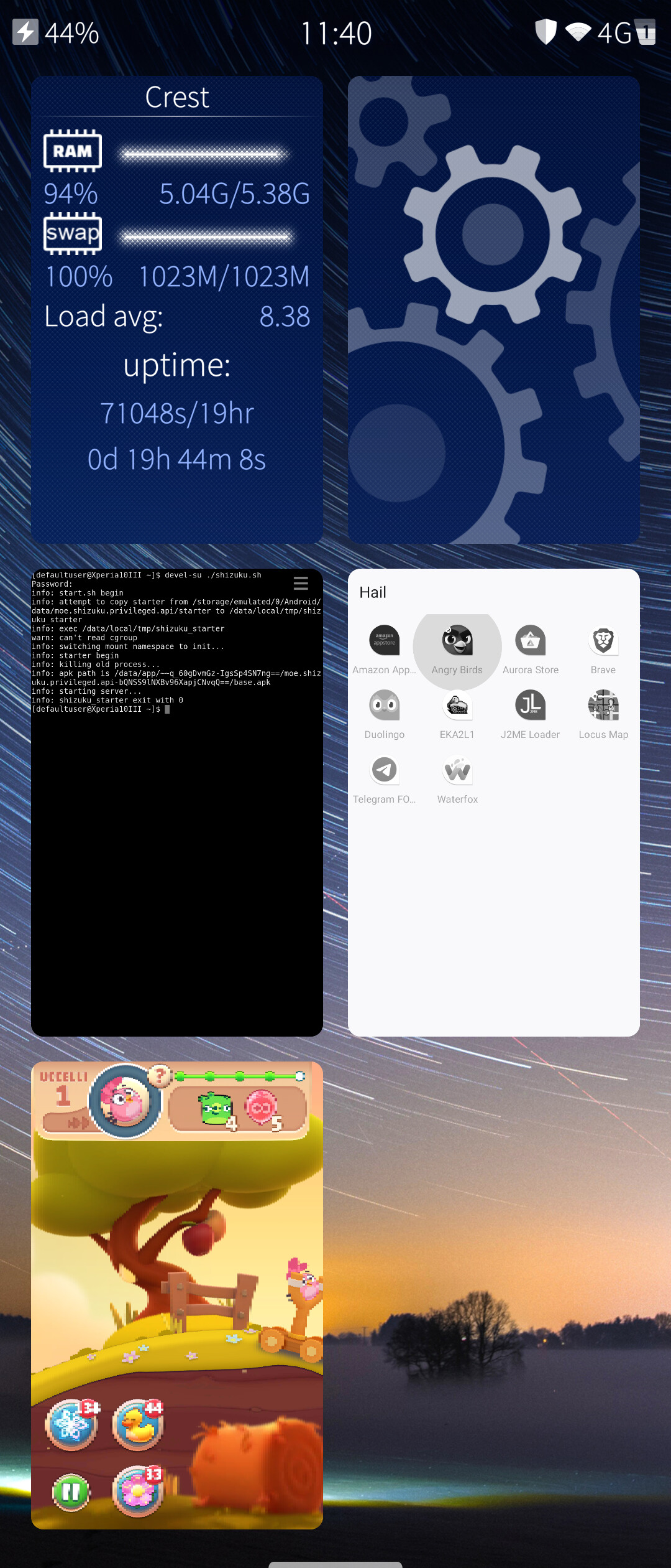

After updating from 5.0.0.68, my AAS crushes when using a specific app (my toilet-companion Angry Birds Journey). 4-5 minutes after playing the game, the whole device becomes unstable and very slow, until I somehow manage (with a lot of patience) to switch off AAS. Not only the AAS part, but the whole OS as well. Without running the specific app, everything works OK.
Maybe, just maybe, the AAS drains the RAM and, in your case, the AAS collapses.

Confirmed for my case. App related, since it doesn’t happen with any other app I use.

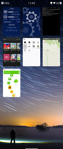

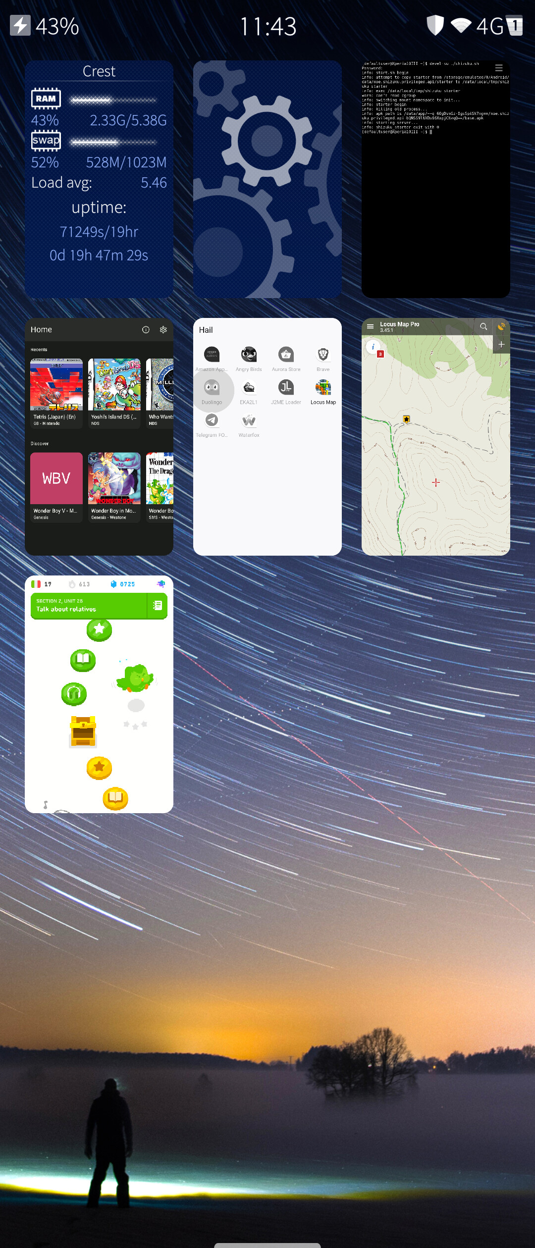

I do get this issue on my Xperia 10 iii, sometimes very frequently, other times not at all for days. I still have a sneaking suspicion that this is related to the well known 10 iii OOM issue. Unlike my XA2, XA2+ and 10 v, the 10 iii is affected by running apps which just get killed sometimes - presumably when the OS thinks its run out of memory. Why would it not be the same for AAS?
