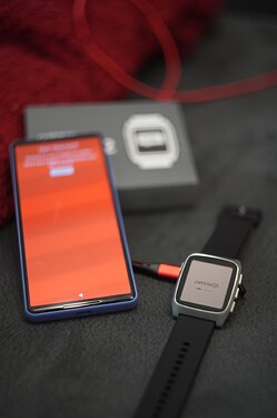

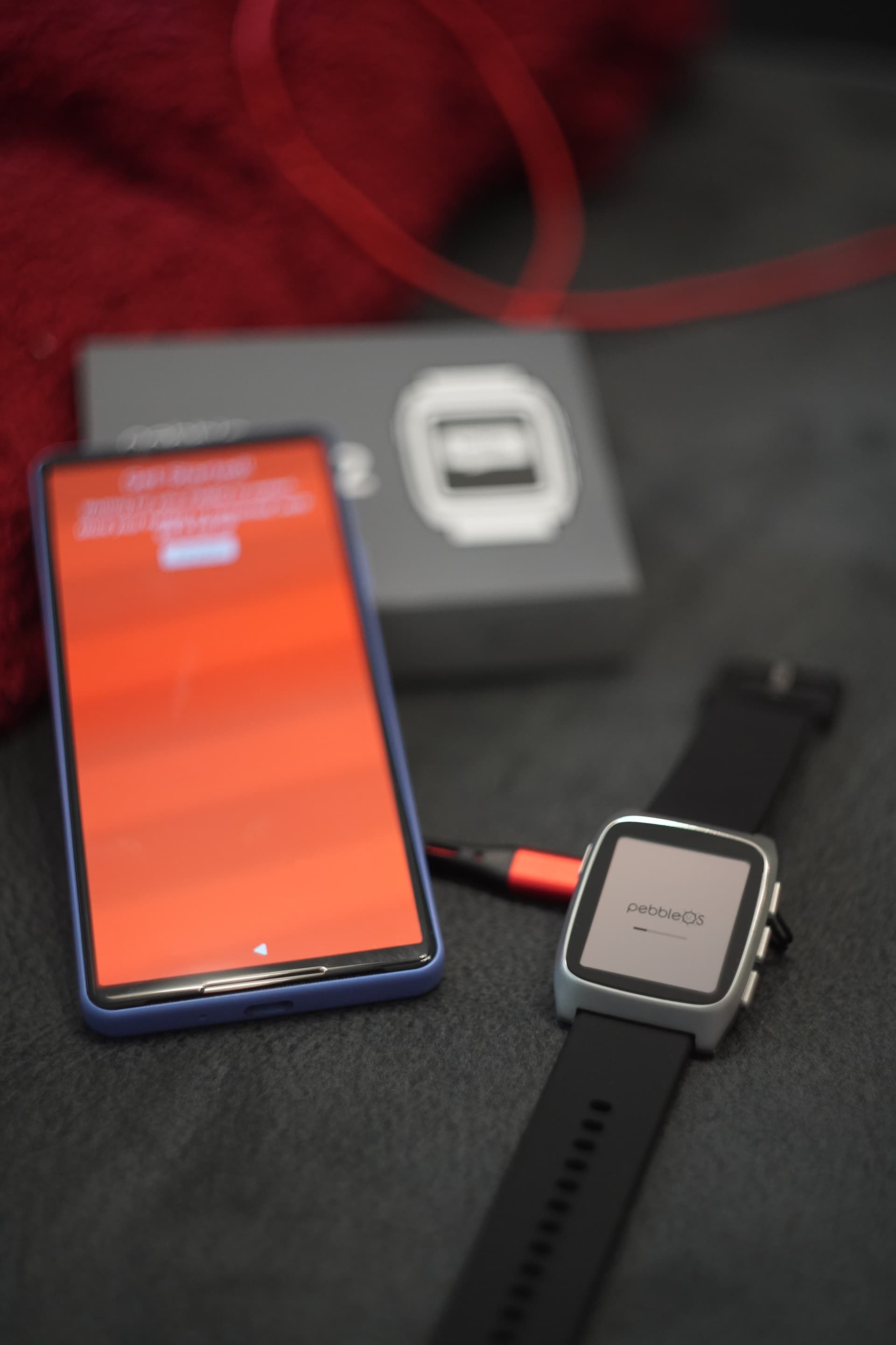

Xperia 10 IV, Sailfish 5.1.0.8, Android ASS with BT bridge. Initial firmware update went smooth (pairing needs to go by long-press, “Pair with Android AppSupport” in Sailfish settings), then Bluetooth decided to start crashing. Will debug and report back.
Ideally, we’d be using Rockpool, but that’s not yet finished!

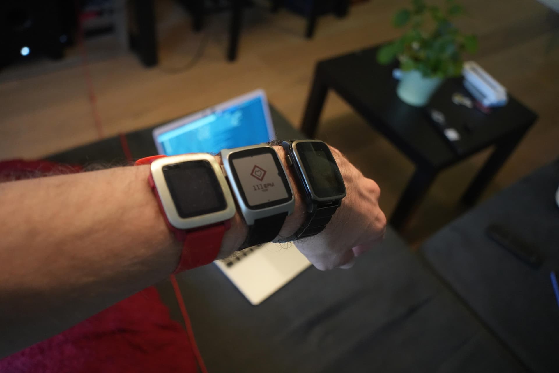

Family pic:
