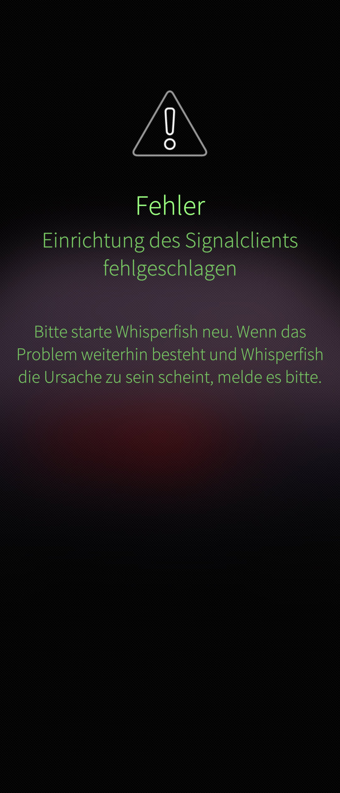

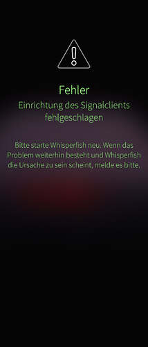

Hello everyone. I had to set up Signal again, but the connection with Whisperfish as a second device no longer works. I reset it with → rm -rf ~/.local/share/harbour-whisperfish ~/.config/harbour-whisperfish ~/.local/share/be.rubdos/harbour-whisperfish ~/.config/be.rubdos/harbour-whisperfishWhisperfish. I also reinstalled it. The same error keeps occurring. Does anyone know a solution… Thank you…
Are you sure you used the right command? In your comment, you’re trying to remove a directory called whisperfishWhisperfish, I’m not sure whether it’s a copy-paste error here, or in your terminal. The right command would be rm -rf ~/.local/share/harbour-whisperfish ~/.config/harbour-whisperfish ~/.local/share/be.rubdos/harbour-whisperfish ~/.config/be.rubdos/harbour-whisperfish
Note that reinstalling an app is generally a no-op: it shouldn’t affect anything.
I tried your tip… Same error…
I can give you any other information or log. I would really like to continue using Whisperfish…
Did you reboot after deleting? I had an issue with registration today and that was the soln. Rm those three folders, reboot, re-register.
Yes. Already done. It doesn’t help. I’ll try again tomorrow. But first of all, thank you

I have no chance. Can’t get Whisperfish to work anymore. Too bad at the moment. Is essential on the FP4. Matrix with bridge is just a rubbish solution
@manuel.sailfish: If you send me logs, I can try to help indeed. Try to remove the directories again, and the capture logs of you reproducing the issue, and you can DM them to me.
