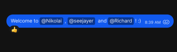

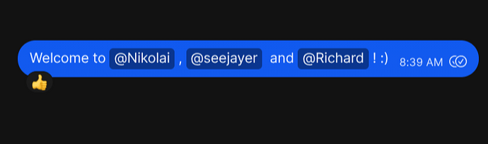

Just notced mentions (of me?) are displayed weirdly.
Just an @_ with a link behind it. The link has the content mention://9a35ZZZZ-7e16-YYYY-ab76-b95d270XXXX.

The goal is to actually capture them as linkable and show the profile page, but thatās not yet implemented. Thatās how theyāre shown in official Signal apps as well, as far as I understand:
Does that make sense?

Thatās fine - whatās not fine is that in my case, the name does not show up at all, just the @.
So I canāt actually tell whoās been mentioned.

They should map 1:1 on the member list in the group view. If thereās a mismatch, itās a bug, and if thereās a name missing, thatās also a bug (but a more difficult one). If the nameās missing, you can: tap-and-hold, open the DM session, swipe to the profile, and pull down for a profile refresh.
