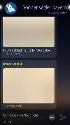

Thanks, the screenshot has a clue! For some reason, Whisperfish can’t load the image properly, and fails to (well, stays at really) the blurhash thumbnail of the image.
Also “it works in beta.19 but not in beta.20” is an important detail here (and it helps hunting down the issue).
Could you please create an issue for this in Gitlab, and attach the screenshot there? Any chance you could attach terminal logs there (don’t forget to sanitize them first)?
I will try to create a log to find the problem. Meanwhile i see that not all pictures are invisible.
Some of them i can view and download, the invisible i cannot download on my phone.
So i download one invisible and one viewable picture on my linux system to see the different.
Strangewise
both pictures have the same format except the name suffix …
Here the output on my linux …
gabs@s2:~/Downloads $ file IMG_6225.jpg
IMG_6225.jpg: JPEG image data, JFIF standard 1.01, aspect ratio, density 1x1, segment length 16, baseline, precision 8, 1600x1200, components 3
gabs@s2:~/Downloads $ file signal-2023-08-19-072056.jpeg
signal-2023-08-19-072056.jpeg: JPEG image data, JFIF standard 1.01, aspect ratio, density 1x1, segment length 16, baseline, precision 8, 2048x873, components 3
The first one is visible the second not …
