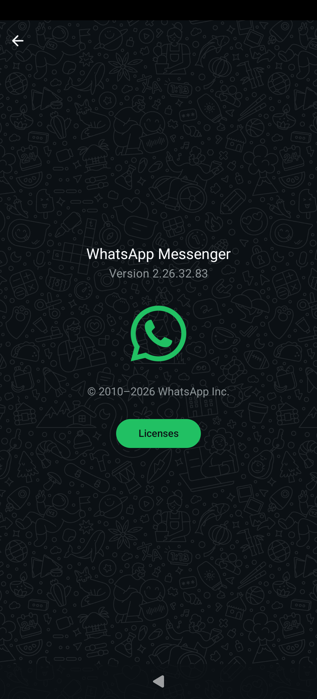

Today I installed whatsapp through aurora and i had no problem to register it as a second device. It is running pretty smooth. I’m now testing battery life without switching things off.

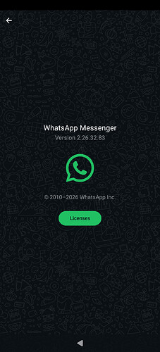

Moved from Fairphone 4 Android to J2026 a couple days ago.
WA from aurora store (spoofed as pixel 9A), microG enabled and set up.
I ran into no issues whatsoever, received the code on the old phone, inserted it into Jolla’s WA and could log in.
As soon as I turn on AppSupport I receive notifications from it.
I’m new to everything Jolla so let me know if there are any info I can provide to help you figure it out.
