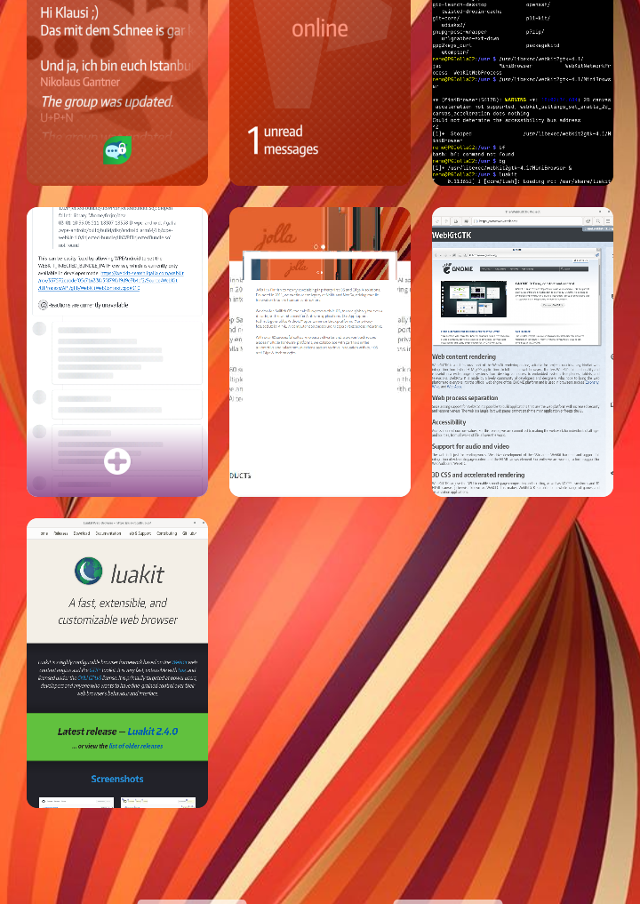

In related news, here’s SailfishOS Browser, Luakit, GTKWebKit Minibrowser, and QtWPE Minibrowser running side by side:
I think with all these possibilities, a brighter future for SFOS Browsing lies ahead…
Not pictued: Cog, but that’s a bitch to launch ATM.
