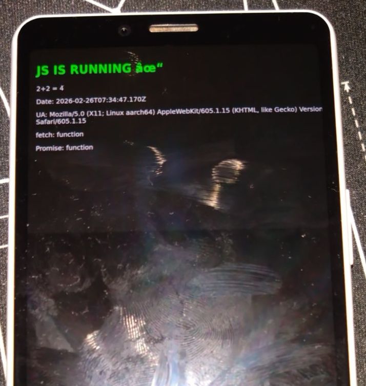

This is the Mini Browser from WPE WebKit 2.50.5 (Safari engine) running on my Xperia 10 II
I used Copilot to compile the thing, left it running overnight and voilà!
The environment is unusual. I use a Native Armv8 server running Ubuntu and the sysroot of SailfishOS. Most of the binary is statically linked.

Here is a short video of the browser in action ( Running in a QML wrapper)
Sadly, on heavy website ( like Jolla.com) the engine crash. Pretty good for 2 days of work.

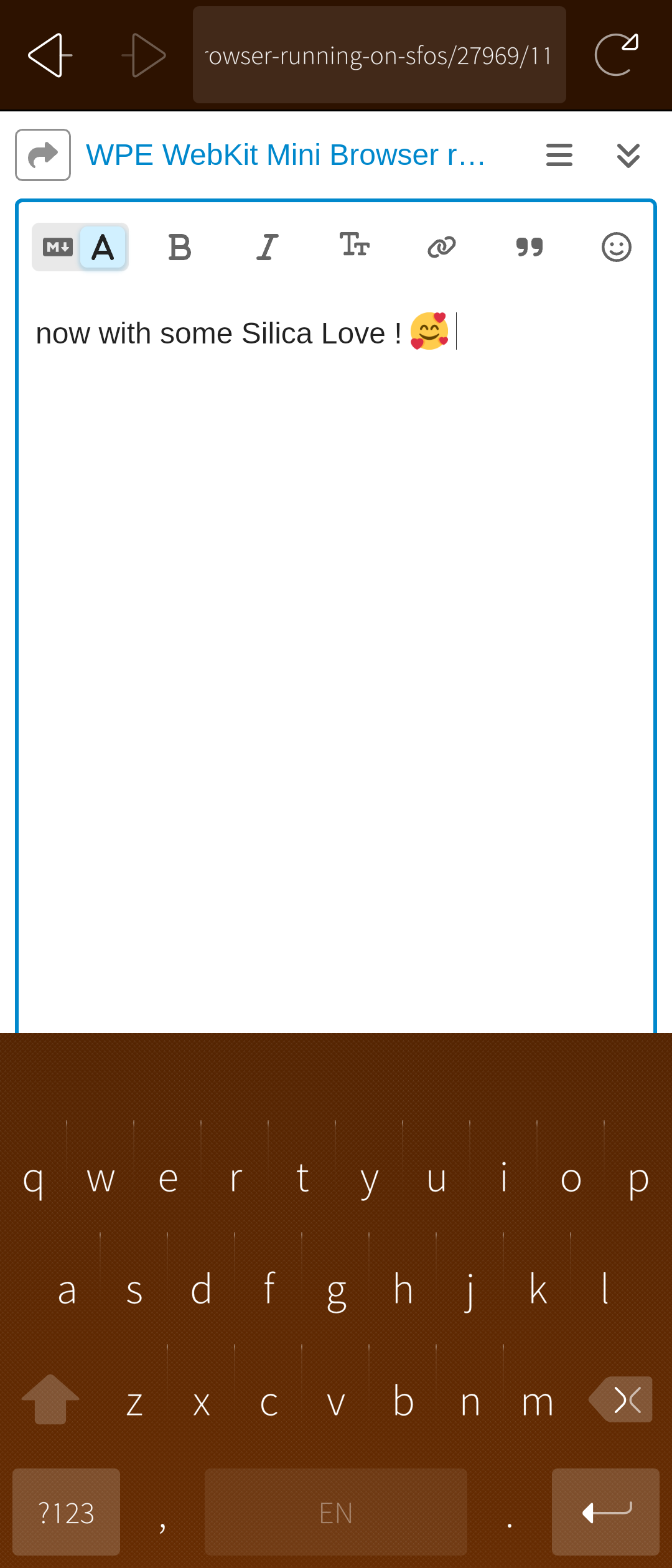

this message is typed from WPE WebKit on a Xperia 10 II running Sailfish Os 5.0!
:star_struck:

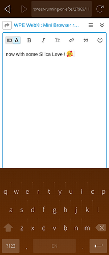

now with some Silica Love ! :smiling_face_with_three_hearts:

Here is a video to show the current progress, I am running the WebKit engine inside the official Jolla browser
Keyboard, copy and paste, zoom, ui integration is working. Missing : video/audio, sandboxing (Sailjail and engine) hardware acceleration.
Still a lot of work to come, video is going to be tricky.
