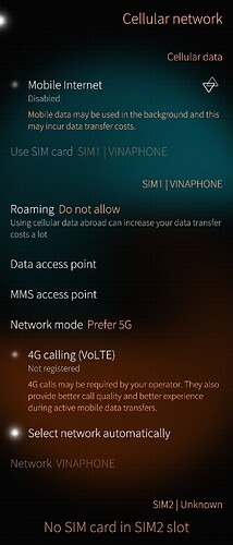

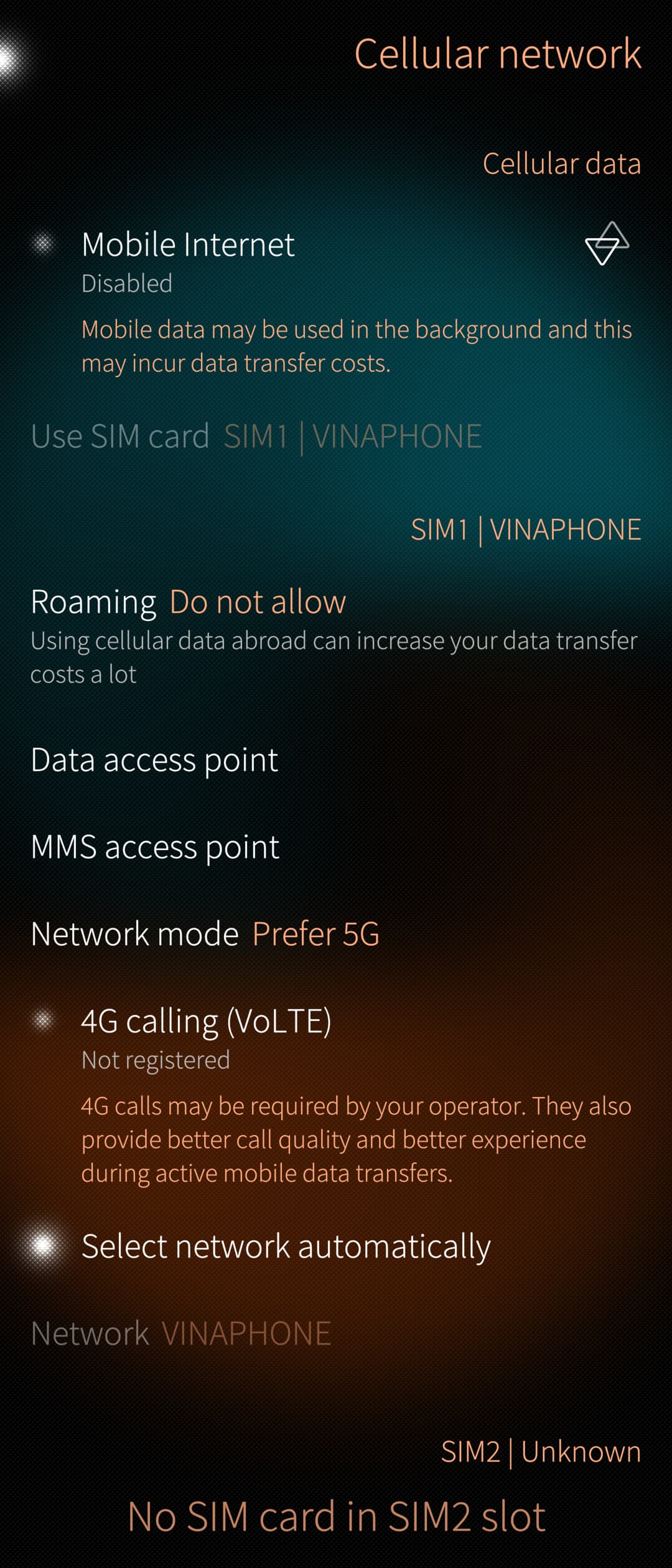

  1. Turn on “prefer 5G”
  2. Turn on 4G calling (VoLTE)
5G icon or VoLTE on top right corner of the phone

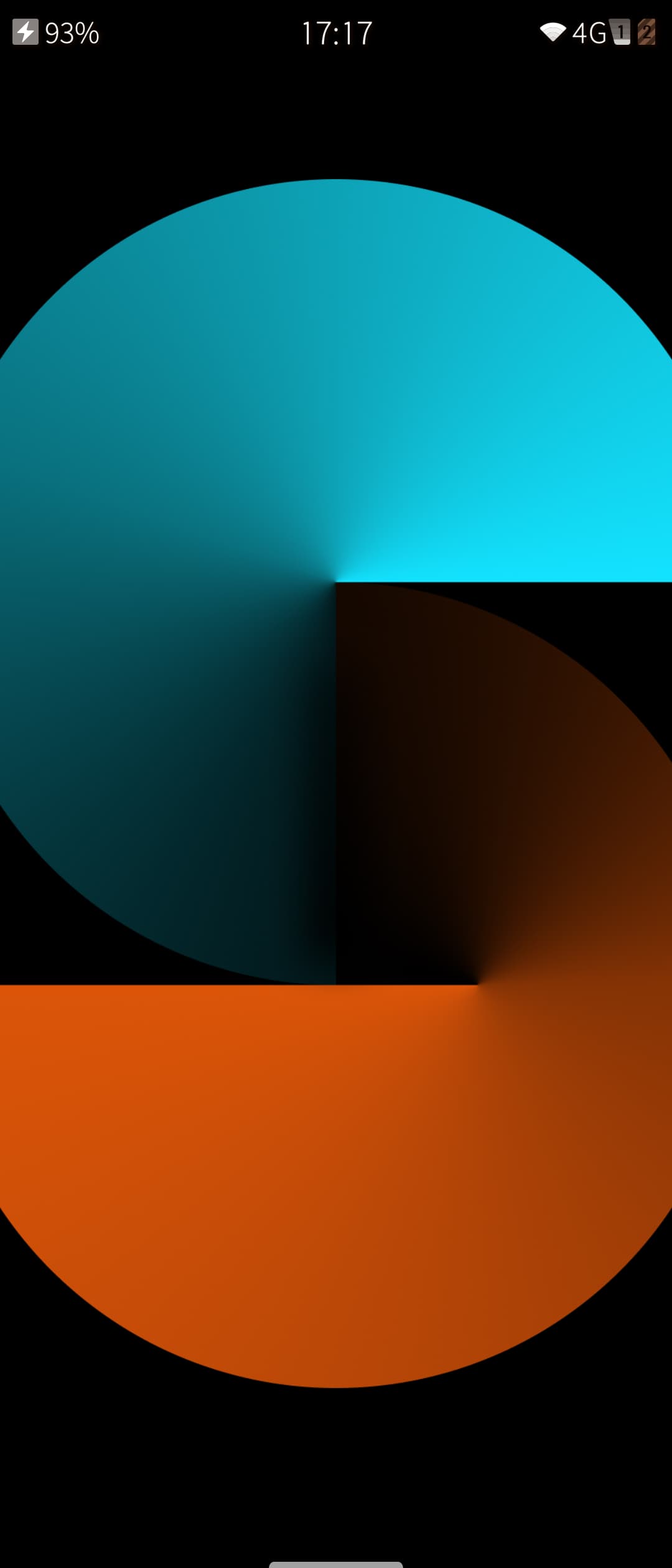

The signal is still 4G and the “4G calling (VoLTE)” keep blinking although the mobile network is supported these functions.
Reboot the phone but no change anything
only 4G is detected

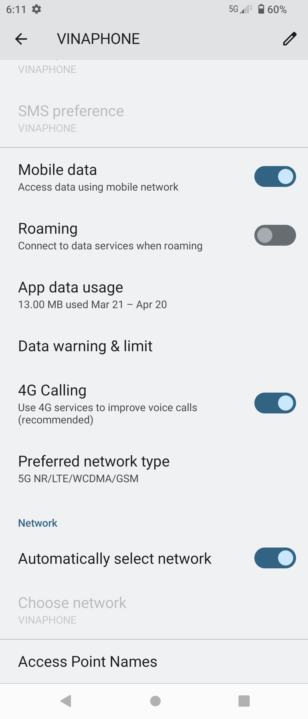

After reflashing, I can confirm that android is supported 4G calling (volte) and 5G at the same time.
As you can see, but on Sailfish 5.0.0.76, not at all.
