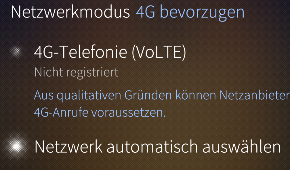

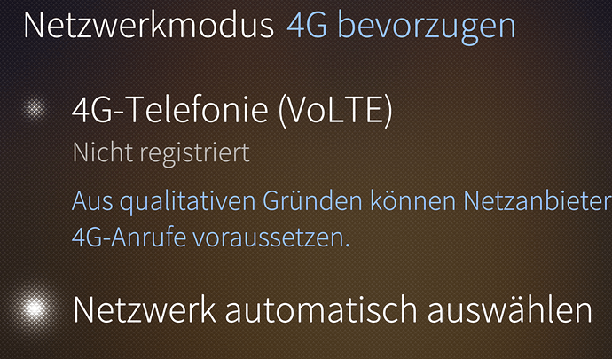

Thanks for your reply! Yes i already restarted! Which configuration are you using? Prefer 4G? Prefer 3G? The thing is my gilfriend has the same provider a 5G compatible Android device and is also experiecing bad connection. What makes me wonder is the bad connection under SFOS. Its practically impossible to use with mobile data. So maybe its really my region…
I selected “prefer 4 G”. I think 5G is not for now an advantage at all for smartphones. Same experience with ubuntu touch on Fairphone 4 and oneplus nord n 10 5G.

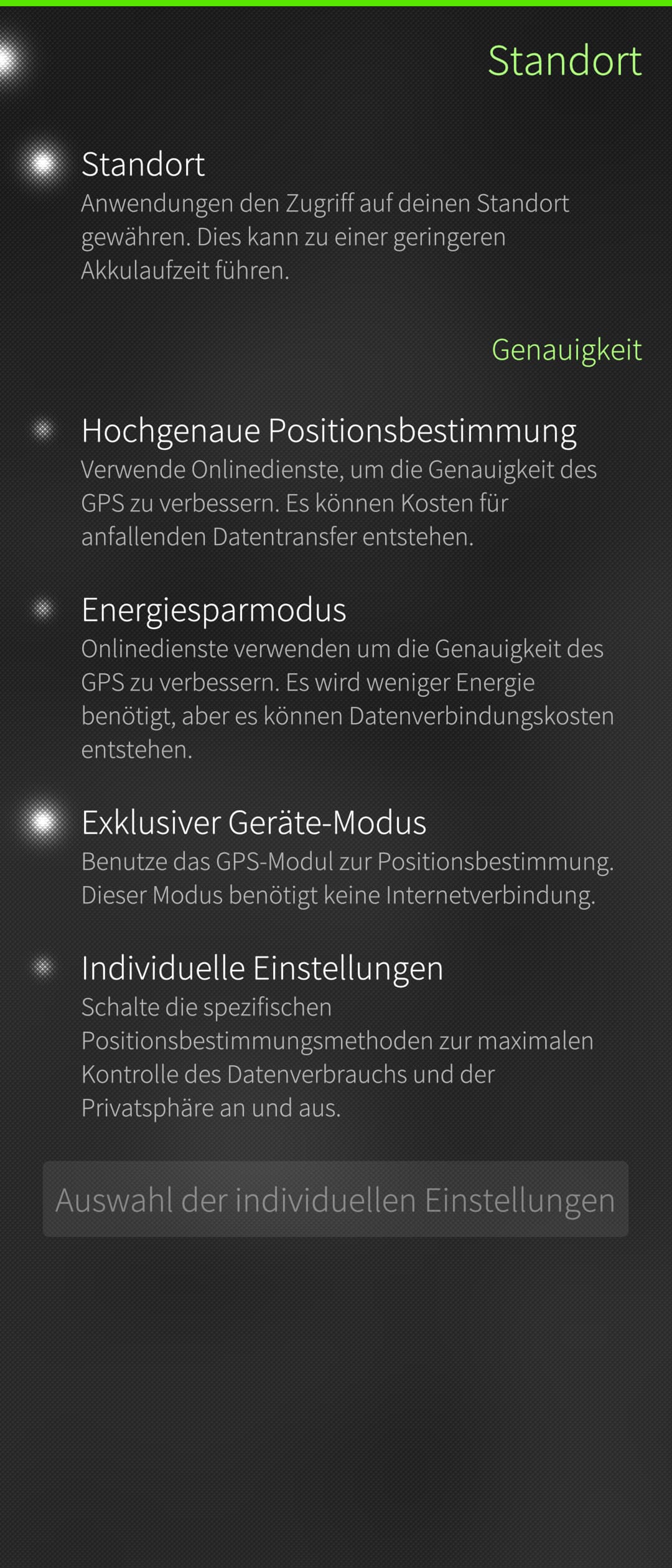

There is 5G sometimes but it eats your battery and GPS accuracy decreases dramatically. Has anyone any idea why there is a reproducable effect of 5G on GPS accuracy?
My phone is set to GPS only.
Just fix your typo to A-GPS and it will become clear.

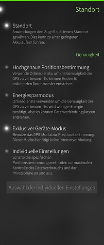

I might be wrong but afaik there is no A in GPS with GPS only mode enabled (see screenshot).
But only god and a few engineirs know what’s going on inside of a location chip. It could be searching for location by other means beside GPS. So it doesn’t mean that my statement is wrong.
