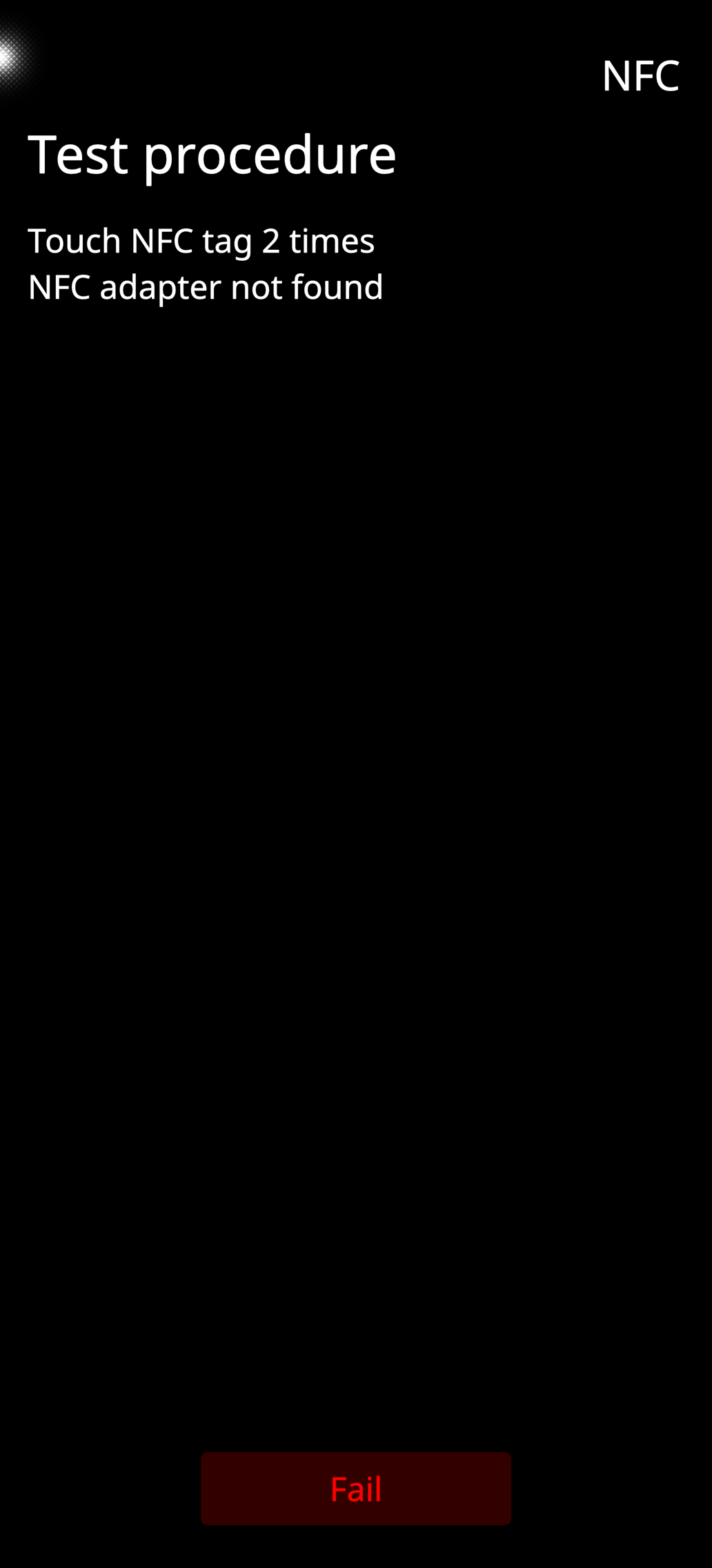

No NFC tags are recognized by the phone despite NFC being turned on.
When placing a NFC tag near the phone, phone does not vibrate and NFC Log app does not show anything happening at all.
The same tags are readable from other devices with no issues at all.
No known preconditions to report. I have tried multiple things but the outcome is always the same.
  1. tried disabling appsupport
  2. tried multiple combinations of wifi/mobile data/bt/gps on and off
  3. tried to reboot the phone with NFC enabled
  4. tried to reboot the phone with NFC disabled and enabling it afterwards
  5. tried all the above with and without TPU case (shouldn’t interfere but was easy to try)
  1. Enable NFC
  2. Put NFC tag on phone back cover
NFC tag should be read correctly and phone should vibrate
No vibration and no NFC tag being recognised

What does CSD say?
Nothing good I guess :smiling_face_with_tear: (NFC is enabled on phone btw)
