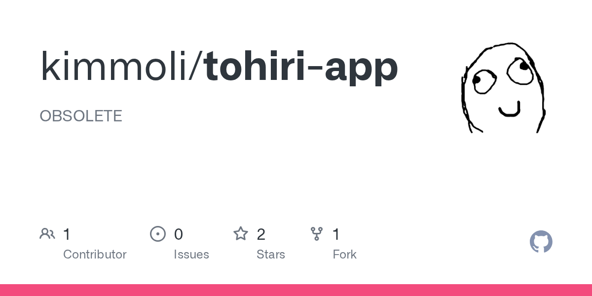

I am actually the proud owner of a TOHIRI by @kimmolindholm thermal imager TOH for the Jolla 1. (Possibly the only other apart from his own and the one in Jolla’s hall of fame display cabinet - if they are not the same one even). It uses that same AMG8833. While very cool, i definitely prefer the USB-C connected modern cameras with higher resolution.
Crikey. 12 years ago. I feel old.
