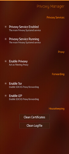

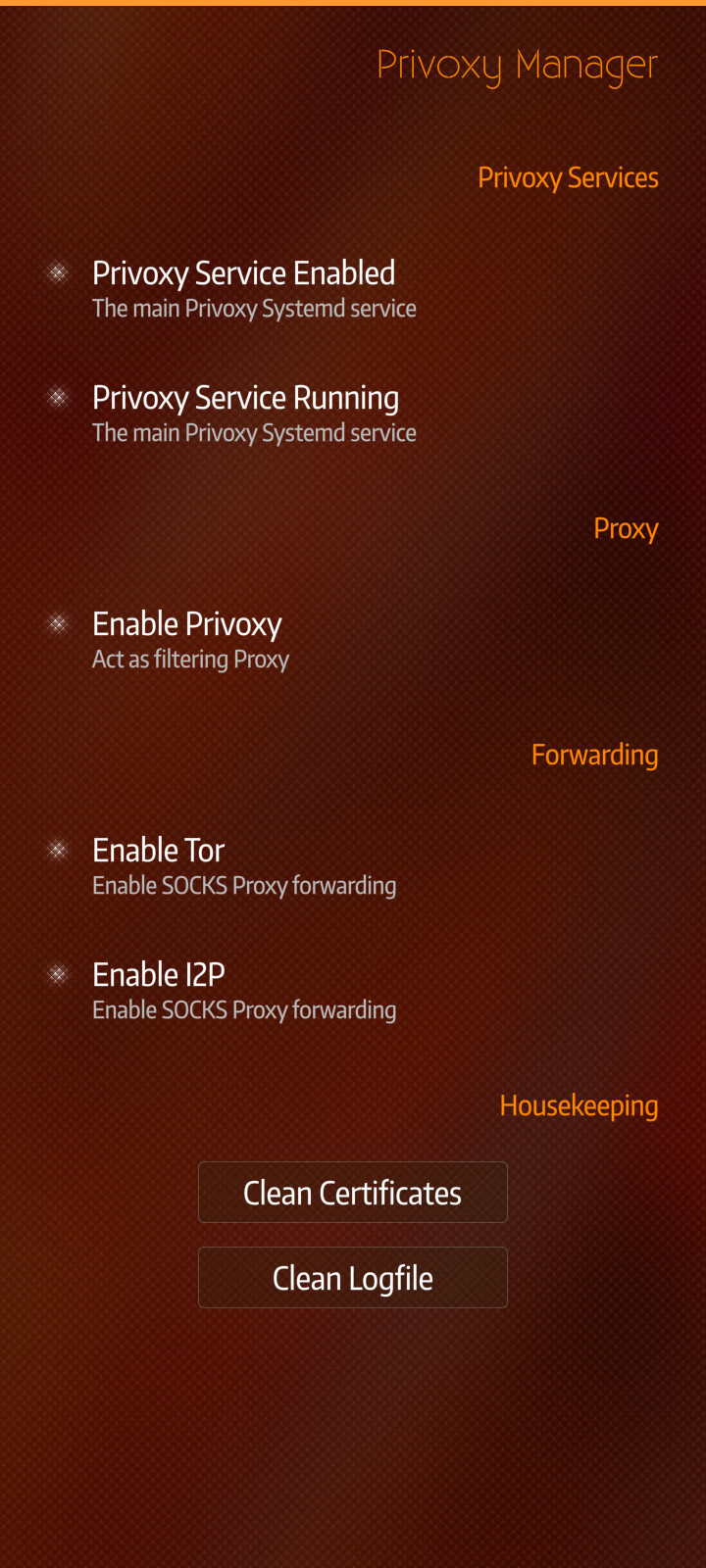

That’s a good idea. Maybe a “Privoxy Manager” GUI could be written to do that and similar things!
