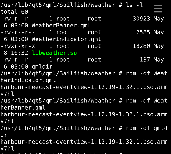

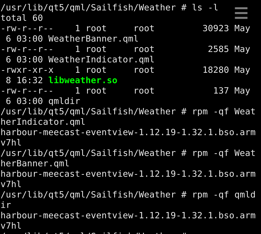

The obvious uninstall + install and zypper ref, zypper up/dup didn’t magically insert the missing files inside the rpm on Jolla’s server.
I had the backends, so there are two issues.
Edit: shortened quote from Steve
Edit2: I didn’t test this part: harbour-meecast-eventview overwrites the files, removing it removes the files.
The reason why reinstalling Jolla Weather doesn’t help is that the files are in sailfish-components-weather-qt5. So reinstall that one.
This screenshot is from my XA2/5.0 that doesn’t have Jolla Weather but has the same filenames with different content.

tried to rebuild meecast because actual version does not work on SF5.2 i think i accidentality installed event view and lock screen rpms and then removed, later i found that i have blankscreen in sailfish-weather.
removing sailfish-components-weather-qt5 and reinstalling from store did the trick,
