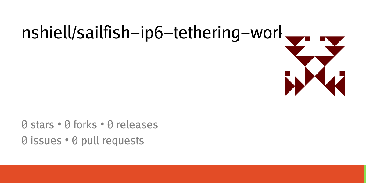

Hi all thanks for your thoughts!
If the script can be improved then please make a pull request
If this script can be made really clean, then it’s more obvious to Jolla/SailfishOS devs what limitations this script is working around. If there is a way I can generate a tar.gz from logs from my phone to aid SailfishOS devs. I guess that would be useful
